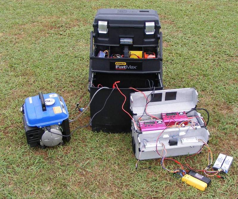

Thanks to all for the inputs. Now I have a clear picture on motors and ESC's. Still need help regarding battery recharging at the field. What power source do you use to rechage the batteries at the field, I mean, the car's battery or a portable generator ?.
Regards
Regards
You will need either a generator or high quality deep cycle battery. It really depends on how you want to run your practice sessions. I like to fly 6 flights in a session, that's 6 flights of 1 P-09 or (starting this week) 1 F-09 each flight. I take 4 flight packs with me and I use my Optima deep cycle battery to charge two of the packs at the field. It works out just right, I have little time spent waiting around for a charge. I found that if I have two or three packs then I spend time waiting. If you have 4 packs and a deep cycle battery (like the Optima, others don't last long) then you are good for 6 flights a session. If you have fewer packs or if you want to fly more than 6 flights in a session then you must have a generator. I find I get only 2 charges out of my Optima battery, so any more flight time means you must have a generator.
That's how I do it.

Even the largest deep cycle , 112Ahr, battery will only allow about 4 charges of 10S 5000mAhr packs..Sorry.
A generator is a great idea, but then you are depending on a large and usually costly 45amp 13.8v power supply to plug into the generator. HOw many of us pattern flyers go to the field with out replacement parts? Humm...i think nobody. A little too costly to keep two of everything1
I recommend a large, but not too big deep cycle battery, good quality 15 amp marine battery charger and a small generator!
I know its a lot to bring to a contest, but lets look at it first.
The honda inverter type generators are great, and cost about $1100.00. Well worth it, but now we have a large power supply that we are pushing very hard everytime we charge our packs. I have seen these large power supplys simply go POP !! without warning. Now we have no way to charge anything.
If we have a good size Deep Cycle battery (90.00 or so at Batteries Plus) with aforementioned wal mart smart charge charger ( $65.00) and the Honda generator, or a cheaper one if you want.
Now we have out battery that we can charge our packs off of of we are only going to the fieled for a flight or three. On contest day we can bring our battery and if we have 110V power at the field we can use our smart charger to keep our deep cycle battery at or near a full charge all weekend. If we dont have 110v at the field we can then breakout our generator to run our deep cycle battery charger to maintain our Deep cycle battery and fly all day and night if necessary until we run out of gas in the generator... Also we can get say 2 charges off our battery before fireing up the generator and there fore not having the generator running for the fullday during charging.
Hope this wasnt too wordy, just my two cents!

Next are some of the specifications of the Honda EU1000 generator:
1000 watts (8.3 A) of Honda inverter 120V AC power
Super quiet - 53 to 59 dB(A)
Lightweight (less than 29 lbs. !!)
Eco-Throttle - runs up to 8.3 hr on 0.6 gal. of fuel
12v - 8A DC output
As can be seen , it has a DC output, 12V 8 amp. , most probably the DC voltage is not as clean as the voltage of a DC power supply. I am wondering if the DC output of the generator is good enough to feed the TP 1010C charger for the Lipo battery .
Has somebody used this generator in DC output mode, I mean, without using a DC power supply conected to the 120 Vac output , to feed the charger at the field ?
I guess that this generator could take up to two TP 1010C chargers to charge two 10SP lipo's simultaneously. Any advice on this ?
12v - 8A DC output
