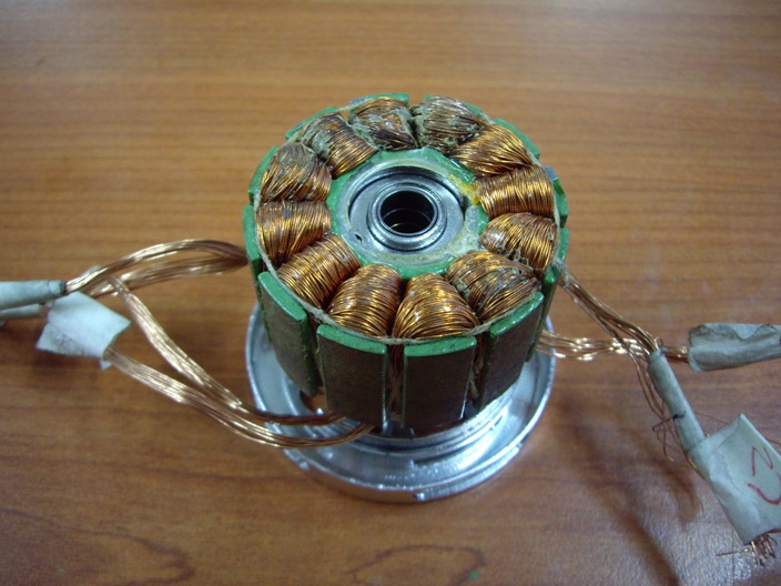

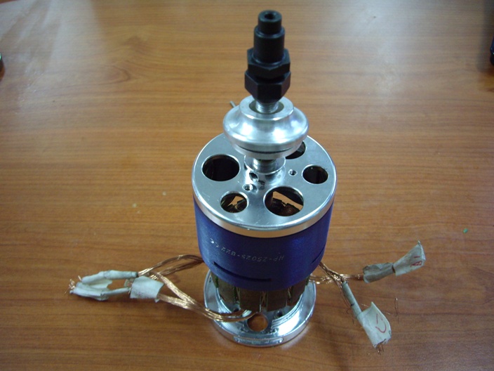

I brought this motor 1 1/2 month ago, after 6 fly this motor fail me, it short internal and end up burn my ESC, (i test the motor b4 max 72amp/2500watt, it is not possible to burn anything) because of bad Q.C. (will post the picture on how the internal design was), I ask wiring expert try to rewire the motor but according to the technician, he say is better save my money to buy another brand of motor, just querry it's my luck or other also having the same question.

TNWalker - Let the picture tell the answer, will be post it soon when I get back my motor.... (JUNK or not ???????????)
Tianci - Are you pulling too many amps? - recommended by Hyperion 75amp (my 72amp with 19x13WE wooden), other use APC 19x12WE with 85amp, so am I wrong ???
Let wait for the picture, sure will be surprise everyone.

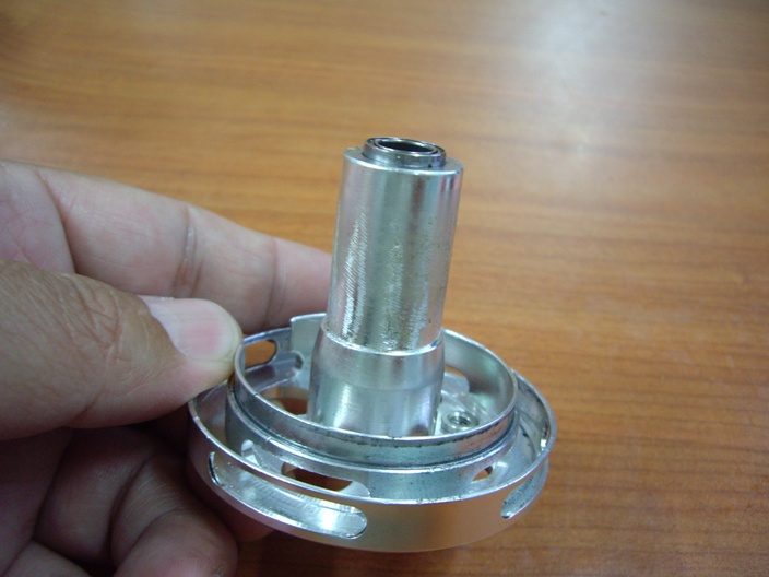

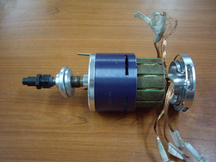

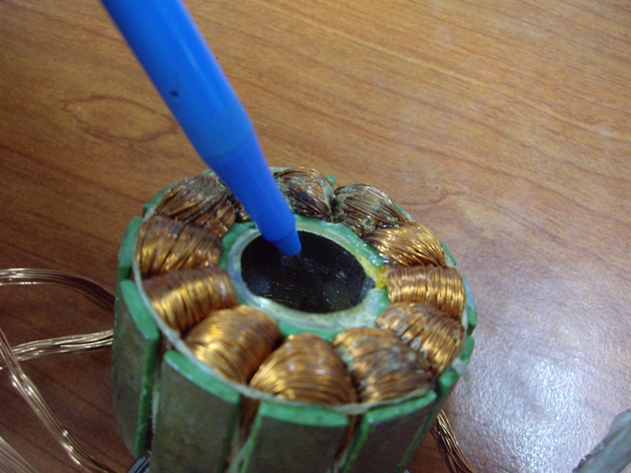

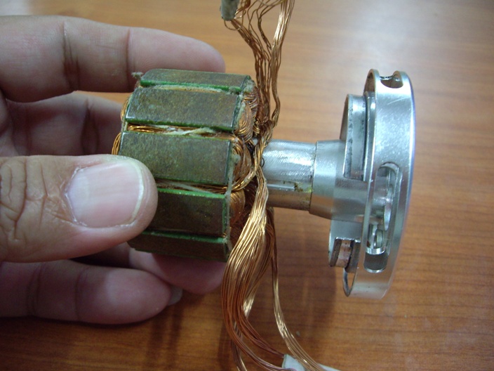

The wiring man tell me the problem from here ... the wire area and main shaft loose, just use hand can pull out the 2 section ...
Some other motor design they got use special machine to press the shaft in ...

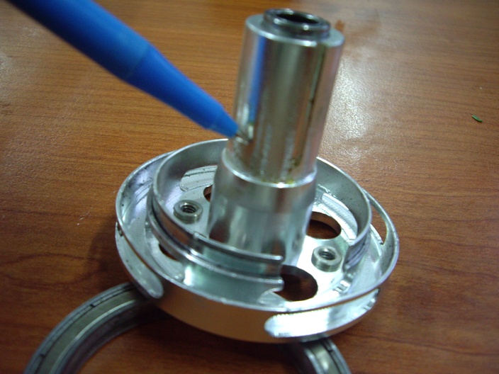

Let point out the problem .... According the wire man, he say is because of the shaft original is too tight, so factory guy just sand the diameter to smaller size, then they apply guel on that area, when the motor become so cool then the guel started to melt, that why the motor loose and it touch the metal area, end up burn the motor and ESC.

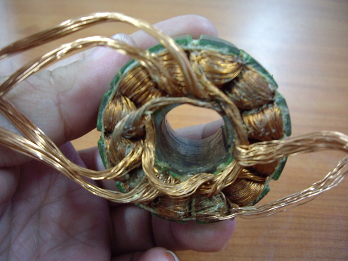

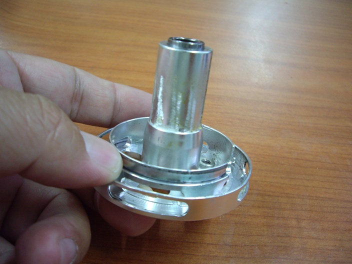

This is the wire area, you can see clearly the guel inside the hole.
The wire man also tell me that this motor can not be back mounted, it much be front mount, when motor become hot it will loose and if back mount it will move forward, so this design is bad.
So for me I dun know it's because of my luck is bad or the design problem????????
ivanwhlee, Well it looks like someone tried to remove that bearing with a sledge hammer! Listen, we all make mistakes. Unfortunately, sometimes "price" gets in the way of when

Ivan ... I really don't want to say too much here as I am no motor design expert. All I can say is too many people say too much. Everyone seems to be an expert. To be fair the failure may be because its a one off lemon. Things like that happen.
However, a wireman's opinion may not mean much bearing in mind he is not a motor designer. As you say he is a wireman who wires motors. Can you try to further explain what do you mean the shaft is too tight? It sits on bearings. What is touching what and what burnt?
As for the bearing shield, its to ensure that the bearing is shielded against dirt, does not automatically mean no shield is bad, there are bearings which do not use shields and that is good for certain application.
Pertaining to back mounting or more appropriately called radial mount, in theory all outrunners are lousy for back mounting. Hot or cold. That is why they have a C clip and an extra collar to ensure that it does not move that much. Did you use a collar?

tIANci, It would be difficult for me to determine what caused the damage/failure to this motor wihtout actually examining it. There appears to be a slight amount of discoloration
to the copper windings in the above pictures. The magnets appear to be intact with only a minimal amount of scuffing/normal wear & tear. My good guess is that basically it was
defective to start with or it was over propped which in turn causes excessive heat & ultimate failure. Again, this is all speculation on my part & not from one who knows definitively. After runnning the AXI's for 3 years, I found they too are not without their faults. You all are more than welcome to migrate to the U.S. As for the great weather, we experienced 17 degrees F last Sunday morning here in the great state of Tennessee! It's gotten warmer since & we all hope spring is here. Regards_____TNWalker
