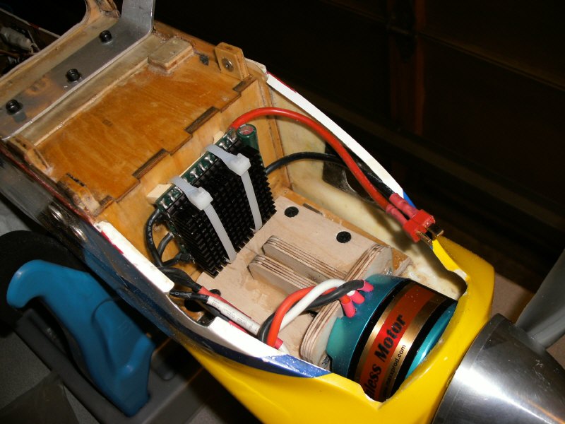

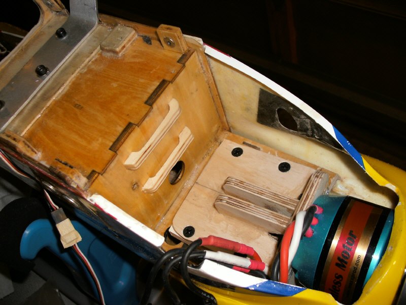

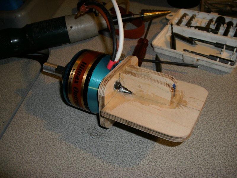

For "old" plane, I guess you will like to save $$ w/o purchasing fancy stuffs. Here is my cheap way. Ugly but works.</p>

nice conversion! Looks elegant, not ugly. It's an outrunner version of what I described for inrunners. Nice job.

If you all keep it up I will run out of reasons to avoid the transformation to electric. I think it looks great. The old exhaust exit makes the charge connections accessiable and keeps the batteries cool.
