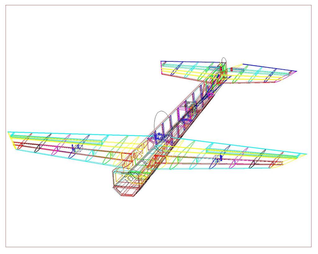

I've been working on getting back into pattern with an 8s setup in a scratch built plane that I am going to build from scaled down and modified Gator Giles plans. I pretty much know the rational for running a separate rec battery and regulator, especially in full 2m planes flying Masters and FAI. Right now I am pricing components and have to work within a pretty tight budget. I will be flying intermediate with a plane that is about the same size as a Focus Sport, but hopefully a little lighter. My planned setup so far is;
AXI 4130-20 (fixed- I already have one)
Rhino 4s3700 x 2
Servos-probably some Hitec 625's I have laying around.
ESC- Turnegy 100a BESC, or ??? Would anyone suggest any thing else?
Opinions appreciated.
Also, when I get the budget for a backup, what do people think of Scorpion Motors. A guy I fly with around here is really sold on them, but he flies mostly 3s and 4s stuff.
