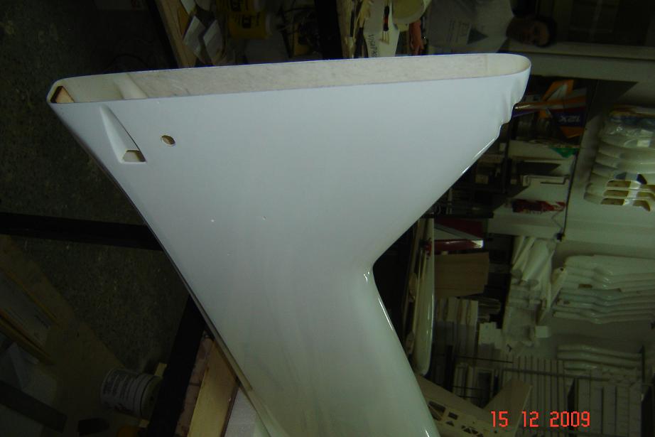

Now on to the Visa. The first fuse came today as you will see from the pics below and due to its shape it came out 130 grams lighter then the lightest passport and 60 grams lighter then the Onas, and this is not even a bagged balsa fuse. (Due to my schedule we could not afford the extra day it would of taken) It is incredibly stiff! A lot of the weight saved was more then likely due to it not having a chin cowl as well the shape. I won´t go into much more detail at this time as I need to get back to work so we can fly it on Friday, but I will keep updating as the zero hour approaches.

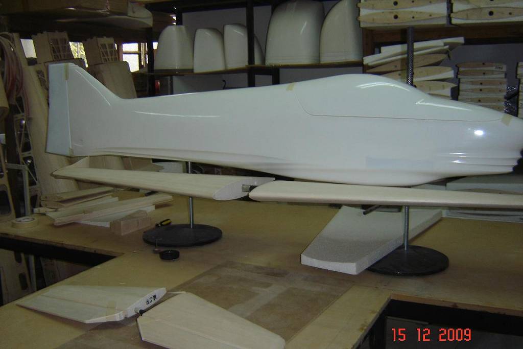

Some more pics. Wing stab and canopy mounted motor in the morning and then paint and monokote. Time to eat and hopefully sleep a little tonight.
More tomorrow

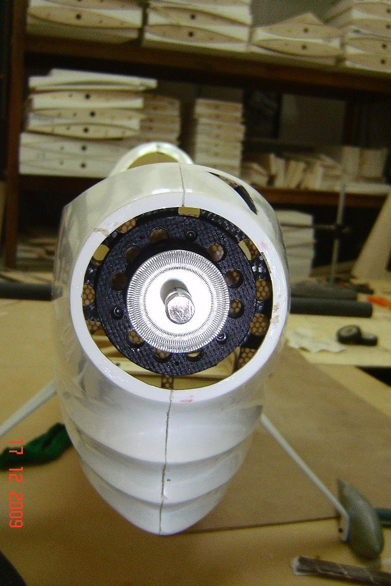

Cool I talked to Tim a couple of weeks ago, but I had no idea you guys were working together. The wings and stabs are very close to the Passport with the exception of the tips and the Dihedral. We have changed the construction technique and now they are (Passport and Visa) wings 5.5 ounces lighter then what we have had in the past. We just weighed Mike Kliens new passport and it will come out at 10.75 easily with TP 5000´s.
Gotta run back to the paint shop. Heres a pic of the nose and the cooling on the Visa
C

Chip, your new design is stunning to say the least. From your last picture with the lightened firewall and lightened Hyde mount, it appears you've decided to go with an outrunner(?). Also would you please take some addtional interior shots at you convenience. I know you are trying to finish the Visa and fly it tomorrow/Friday. Just one more question, can the new construction techniques you described be used to make another set of Genesis wings for me? Please tell Marcelo I'm intersted in another /new set of wings. Thanks__Everette

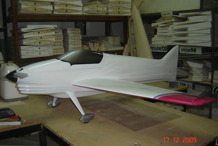

Well my parts done and Marcelo has one more stab to monokote before we call it a night. Heres what it looks like at the moment.

I'm sure from the pictures that it is a Neu inrunner motor. You can see it extend through the firewall.

Archie, you are right, it is the Neu F3A motor. Initally, Chip took a picture from the front of the plane and it was hard to tell. BTW, I've been running a couple fo the Neu F3A motors for the last 8 months and all I can say is_FANTASTIC! Not to speak of the outstanding/responsive service Steve Neu & Company have provided, what little I've needed them. I appreciate you providing the above info because I know Chip is busy trying to get the Visa in the air today. I'll contact Marcelo direct and order a couple of sets of the new improved/light wings for my 2 Genesis planes. Thanks__Everette

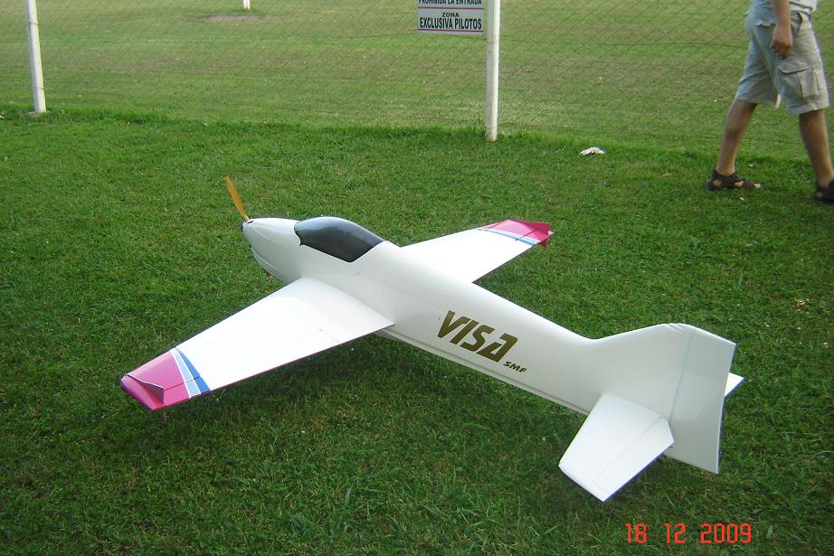

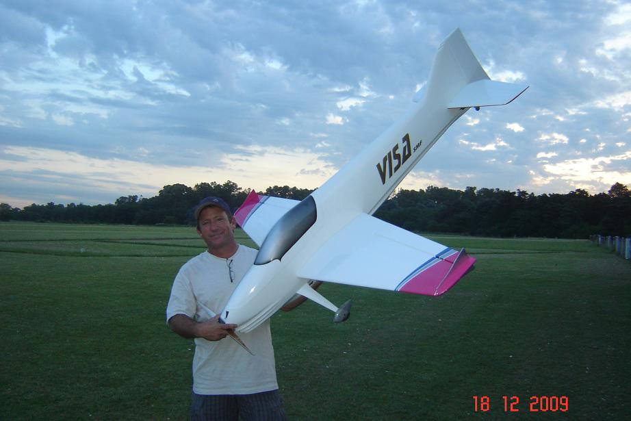

Posts: 1,211
From: Tucson, AZ
Default RE: CA Models VISA
Well we flew it 2 short times, and one full flight. The first flight I forgot to zero out the up elev mix the Passport takes on knife edge so I landed and inhibited that. The second short flight Marcelo remembered he forgot to set the wing at a positive half degree so I landed and we did that. The third flight I took off and rolled to knife edge both ways and it needs no mix of any kind. Then pulled the nose up and it went straight up, half loop and it came straight down, opposite snaps positive and neg unbelievably solid. At that point I was super happy and handed the TX to Marcelo who proceeded to smoke through P-11. Now we are taking the women to a nice dinner smiling all the way. Heres a couple pics and I will go into much more detail tomorrow after flying.
C
