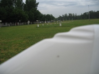

Anyone see anything wrong with this pic? I was looking and looking and wondered why in heck Jason was sending me a pic of my own plane. lol I will let Schoolman explain. Jas its all yours lol I am honered you took the time out of your busy schedule to help us out on the graphics though.

Sorry I missed your post. Its actually the Neu F3A motor that I have been using for the past couple years, not an outrunner, and absolutely we can make some new wings for you. I will tell Marcelo tomorrow you are interested.
CHip

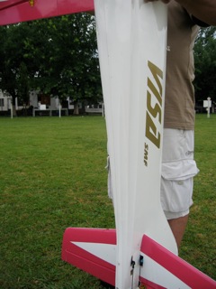

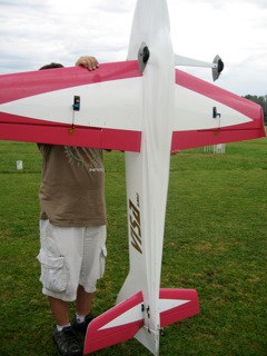

Hey Joe thanks and I missed you when I was there last week. No Hac this time. Anyway yesterday was a great day at the field. We all took turns flying the Visa in between rain showers and had a blast. It now has 11 flights on it and its pretty much dialed in as far a I can tell. We made some small chaanges with the cooling and tweaked the rates a little but that is about it. It still has no mixing for knife edge and just the standard 1.5 percent for downlines.
We put everything in the hanger last night and forgot to grab the camera out of the TX case so the best I can do at the moment is put up some pics a friend took. I think they are a little small to really see fine details but I promise tonight I will put up some more.
The coolest part of the die was when we pulled out the scale they used at the WC's and wieghed it with TP 5000's. It came in at 4660 and this is not the light fuse plus I had to use 8711's in the wings. (1 ounce per servo heavier then 9151's, as is the fuse) I know its not painted but on the Passports we add 140 grams to completely paint and clear a fuse. That will put the total weight to something like 4.7 kilos. (Finally)
In closing I also just wanted to mention that I learned something yesterday. I have always said that mixing is not a bad thing if you take the time to get it right. Well after 34 years of flying pattern and 25 of designing planes I came to the conclusion that no mix at all is better. Not so much for when your on knife edge but for all the transitions to and from. It is really true and there is no coupling of any kind. The split rudder is working perfectly and no matter who is flying the rolling manuevers all look the same.
Gotta run Javier is on his way to pick me up and today is beautiful!!!!!!!!!!!!!!!!!!

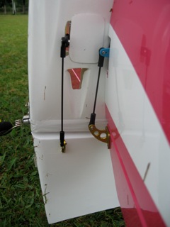

Thanks Tony I am sure you will like your Onas. As for wearing someone out it might just be the other way around. Marcelo has quite the work ethic. I think that in the past sometimes he was just spinning his wheels. What we have both learned from this adventure is that sometimes it is just necessary to travel, both him to the US and me to Argentina. If nothing else just to compare notes. I am certain that we will have at least 3 guest from here at next years nationals ,if not more. Marcelo, Javier, and George are coming for sure, and hopefully a couple more.
Anyway back to the Visa. The plane is flying great and we now have some video of Marcelo and I flying it that we are going to post on Utube in the next day or two. Since about the 4th flight when we locked the wings into place we haven't made any adjustments other then tweaing the rates. What we have been working on is the cooling system.
Don't get me wrong it has been acceptable since the first flights but not what I was hoping for until today. It wasn't until Gustavo (a racing engineer for Toyota) came from Cordova today that we really made some headway. We bounced ideas off each other all afternoon and tried a few configurations before we came upon the ultimate combination.
Basically what we ended up with was 2 Naca ducts in the nose, one on the bottom right and one on the top left as you look at the model from the front. Then we sealed off the area from the front of the top hatch to the tail ring former so that all the air has to go over the motor and then through the former before exiting in the rear. This lowered the motor temp 10 degree C, which is a huge amount. I want to do one more thing tomorrow before I say what the numbers are, but if it doesn't backfire on us I think this setup will make us all very happy.

Sounds great Chip. Let us know how things end up. I think you've done some really good work on this thing. Can't wait to get one.
Regarding the airflow, you might want to increase the exhaust outlet area at the tail if you are increasing the inlet size. You may end up with a static pressure buildup if the exhaust size isn't larger than the inlet. Just a thought.
Steve.

I just emailed you, and thats what we have done. I learned from my racing days that its not the hole in the front that controls the airflow, it the ones in the back. Anyway I will let you know tomorrow.
Chip
