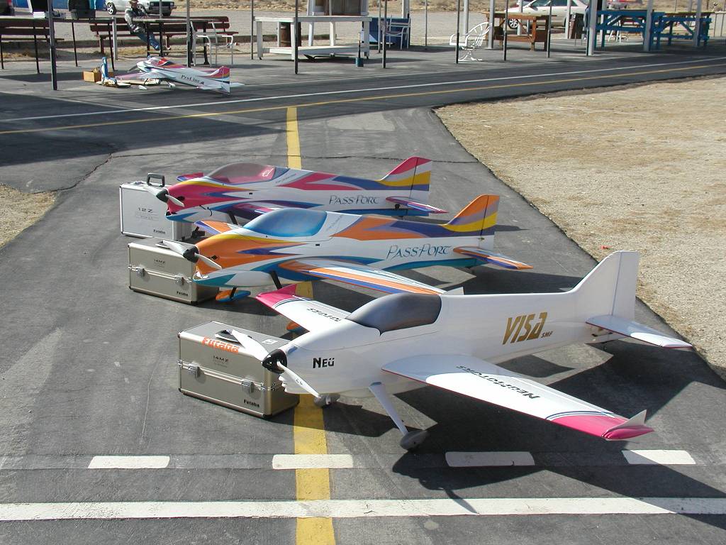

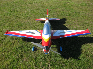

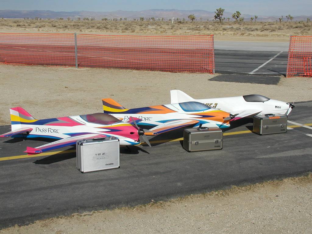

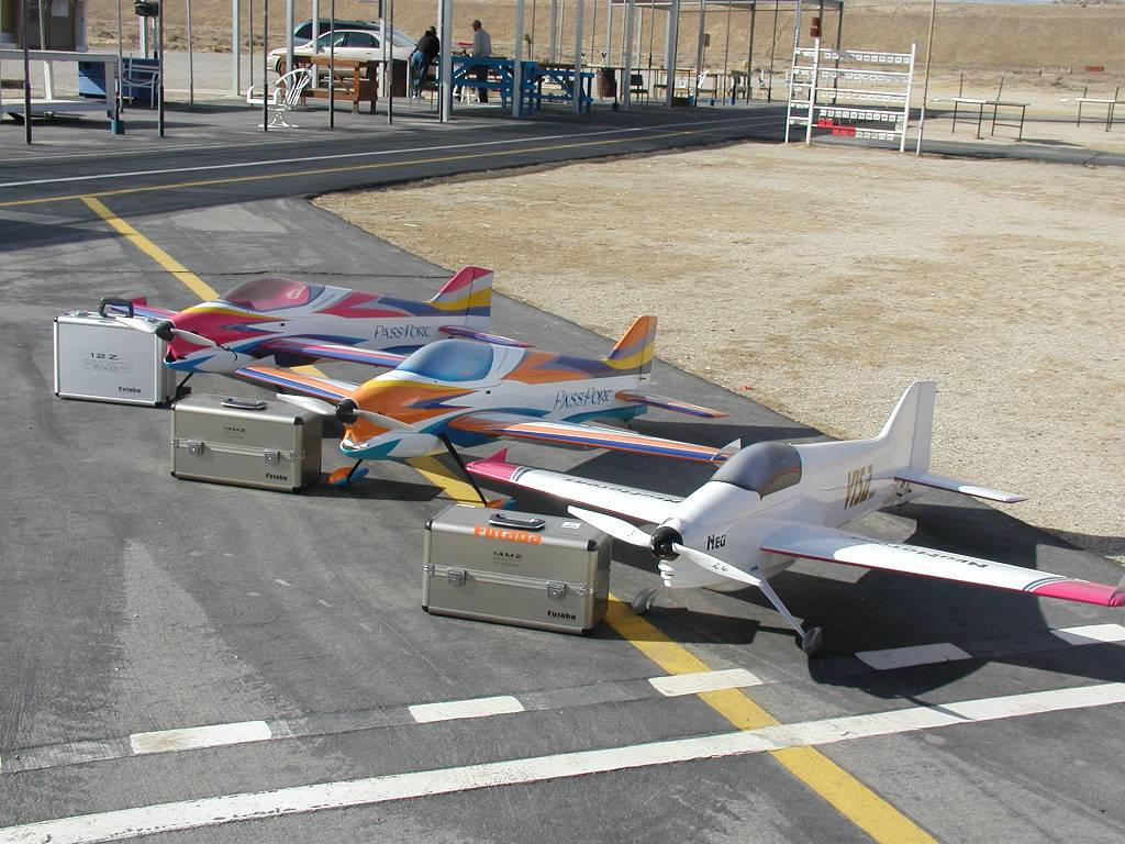

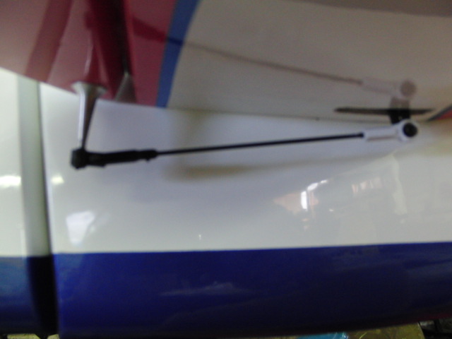

Here are some pics from yesterday.

Bob -
Your plane looks awesome! Still working on getting mine completed. Just finished up mounting the servos in the wing and putting on vinyl (the fun part). Got a few months before we have flying weather here in the midwest and I am going to go nuts waiting to get this bird in the air. I can't wait to fly it.

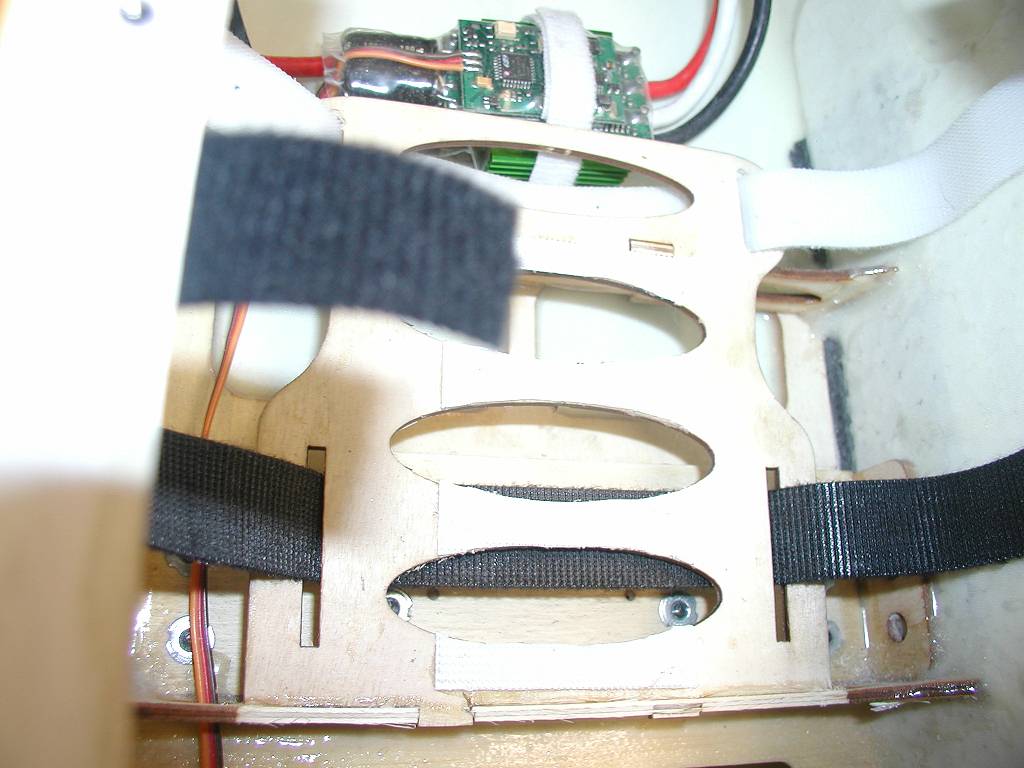

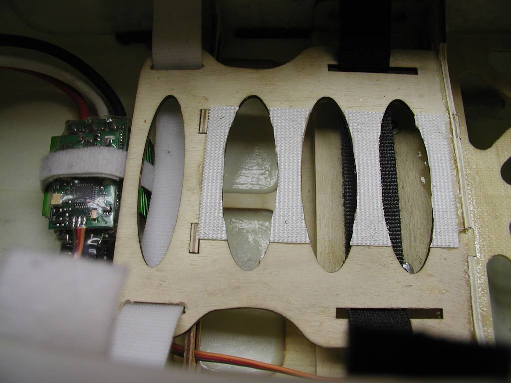

Mike, the snaps are more positive & easier to control than my Zeque is. Here are pic. of the battery tray & servo tray (I hope )

OOPs will try again

Bob -

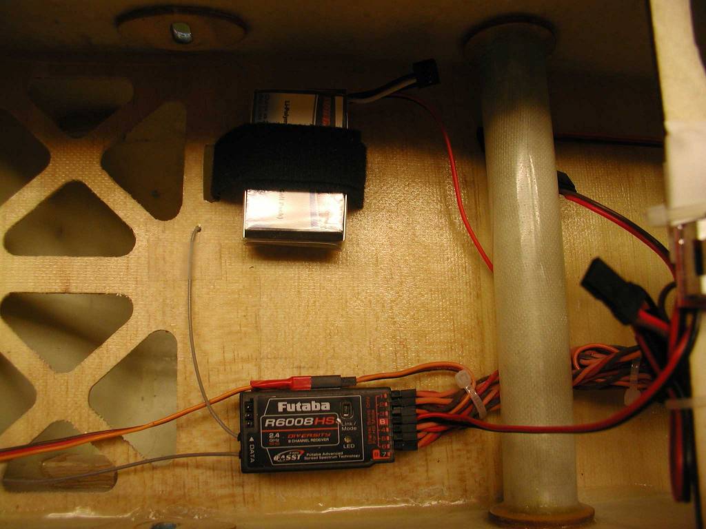

Thanks for sending the pics. That should help me a great deal. I couldn't figure where to put the tray. Are you using split rudder? If not, I may need to push my tray further forward.

Mike,
just put the tray in last , that way you get you CG set.

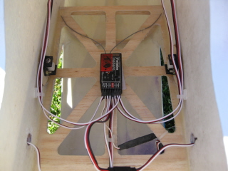

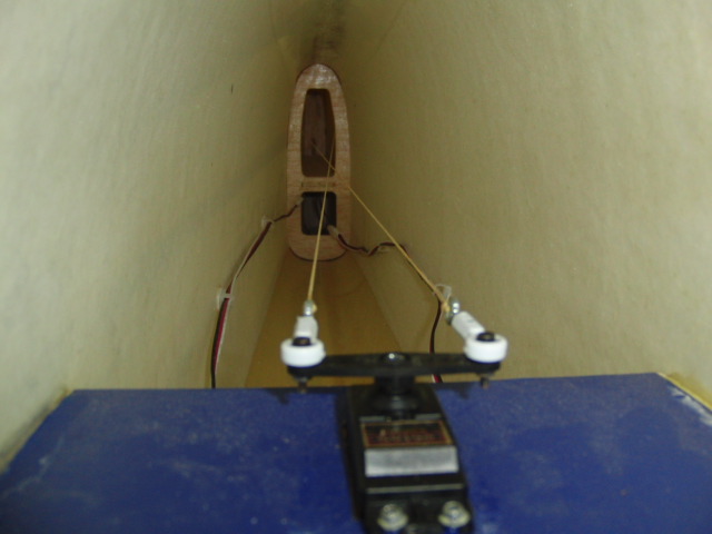

Mike, I'm not using the split rudder. Here are pic of radio & rudder servo.

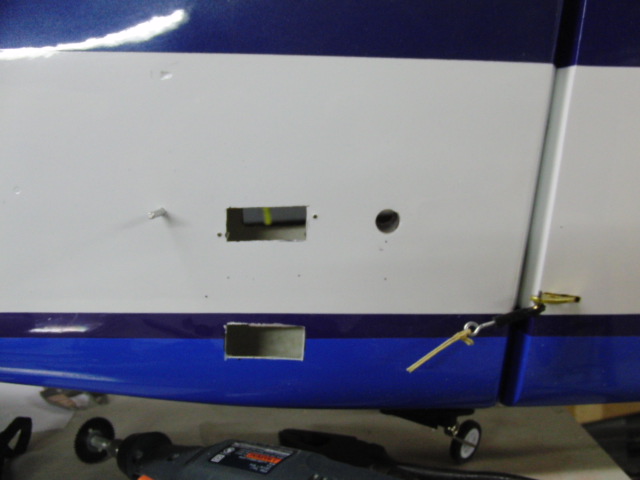

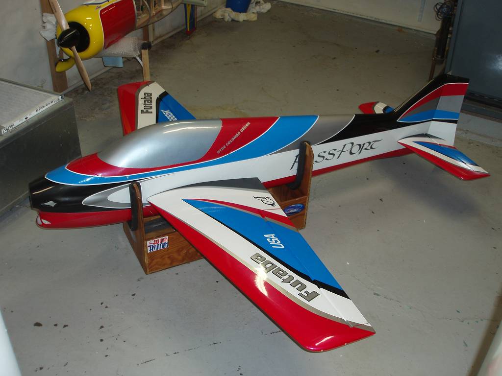

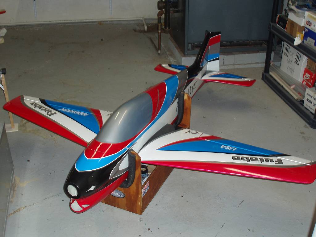

Ok guys.....its taken me a while, but here are some pics of my new Pass-Port. The pics are minus the SFG (side-force generators) which are silver. I didn't want to waste precious building time to put them on for these pics.....got a night that my wife is giving me off of watching my 2-year old to work in the shop :-)
I love the plane....cannot believe that this is the first time I have put it together.....been building on it for a few weeks here and there when I get the time. Got the gear mounted, wings done, the stabs done and elevator servos mounted, the removable split rudder done....now it is time for the rudder servos then mount the motor. Great job Chip and Marcelo, I am really happy with how it looks.

Looks good Mike I like your color scheme. Are the wings painted?

Thanks Stephen - the wings are not painted on this one. My Visa will have painted wings and stab, but these are Ultrakote. I am really happy with the scheme that Marcelo and Chip drew up for me. They are now offering the Pass-Port in this scheme, which is kinda cool. I think they took my scheme from last year and improved on it. The bottom is in the typical Pass-Port scheme, which I really liked because I thought it presented great when I watched you all flying them at the Nats.

LOVE THAT SCHEME!
Very reminscent of my last pattern ship.
Looks gorgeous, well done.

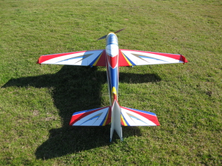

Well I just picked up my new Passport from Todd today and we went out to his field and got three flights on it. I am very happy with how it flew and cant wait to get practicing for the new season. Here are a few pics.

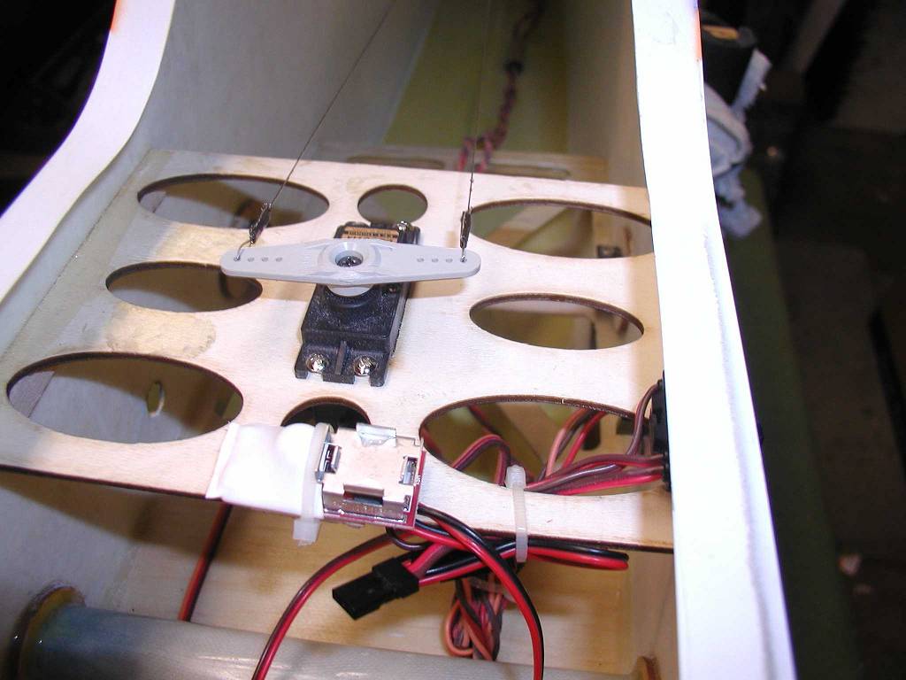

Default RE: Passport 2010

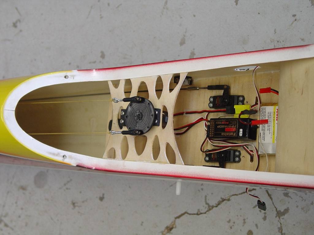

4ptrol,
The rudder servo on my Pass-Port is mounted just behind the canopy. You can also mount it like the Genesis, at the back of the canopy
the best thing to do on the battery tray is mount it last so you can get the CG right.
Let me know if you have any other questions

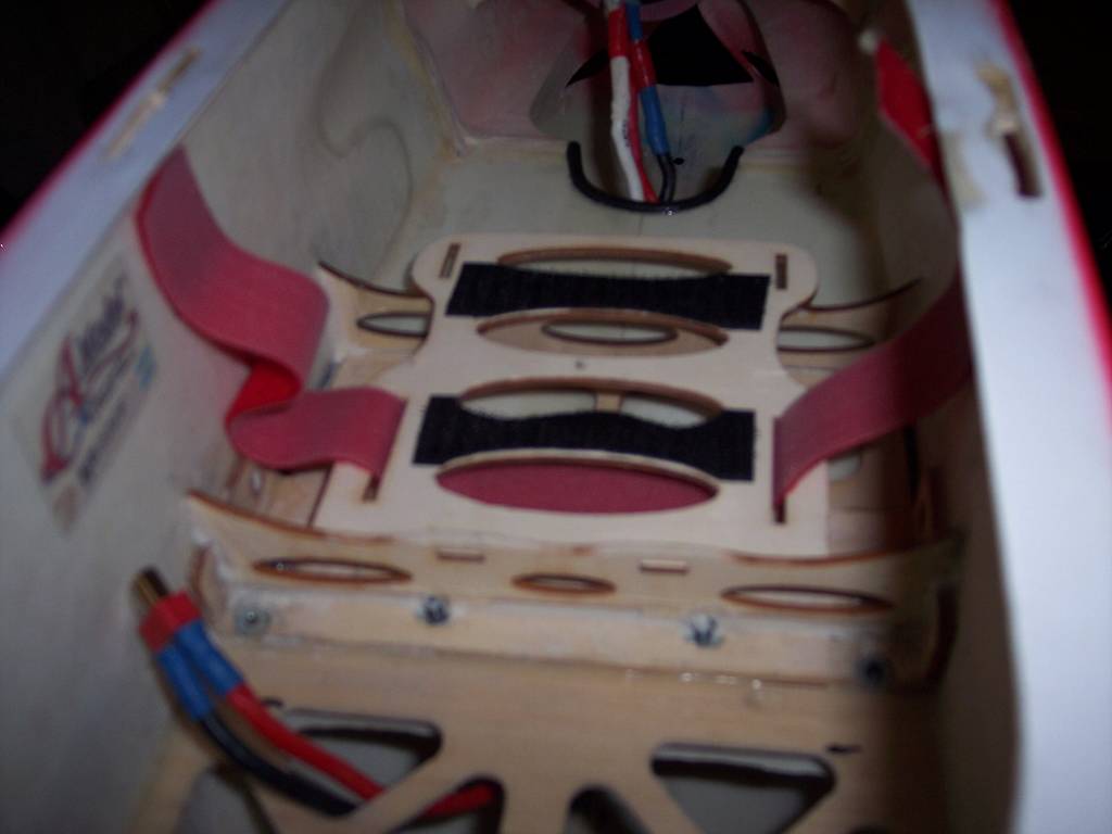

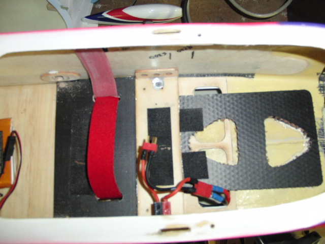

Here is where the battery tray is on the Pass-Port without split rudder. If you are going to run spilt rudder the battery will mount forward of this location.
Stephen post some pics of your batter tray (split rudder location)

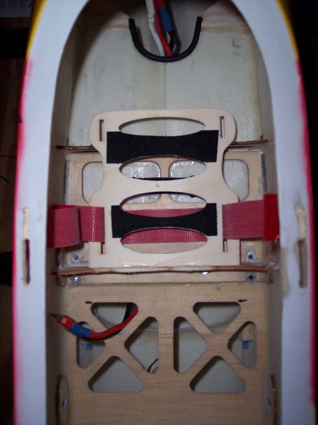

Here are some pictures of my battery tray mounting. I hope this helps you out on your build 4ptrol. Let me know if you need any other pics.
