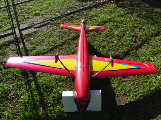

I thought I would show some pic's of the new 2010 Pass-Port that I am putting together for a local guy. The new wings that they are building are 2oz lighter than the ones
I flew last year. The wings on this plane are 14 1/2 oz complete and ready to fly.
One thing I need to let everyone know (some of you may already know) is on the control horns that are supplied with the planes(Visa Pass-Port's and Onas also) the clevis has a ball bearning in it. Make sure the when you put the screw through the clevis you do so on the side where you can see most of the bearning. If not the clevis will slid off of the bearning. They are made this way so the bearning can be replaced.
Just let me know if you have any questions

What kind of exterior hinges did you use on the wing? Is there a reason that the one on the bottom right panel is in at an angle? :-)
Mike
Mike,
I thought I would try something different on Sean's only. LOL
Chuck,
did not know if Sean wanted the word out so thats why I said local, as far as BW he is done for now, the Scandalous is all he has and he has not flown it in 2 years.
Some more pic's of the Local guy's plane. LOL

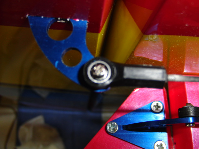

Here is a pic of the new ball bearning clevis that I was talking about, This is how it should look when mounting.

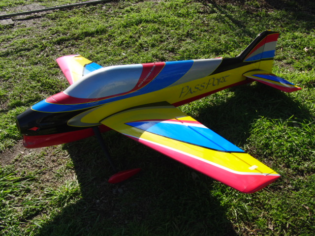

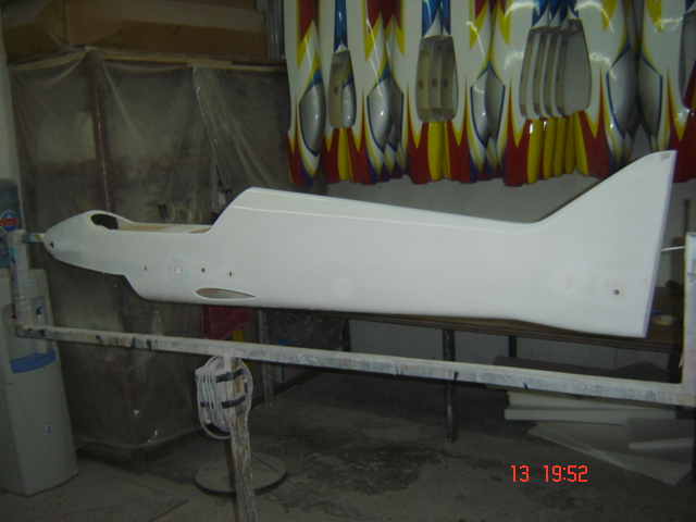

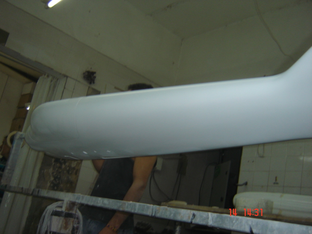

I realize we haven't said to much onthe Passport 2010 thread lately but it hasn't been because we are not working here. The passport has been one of the best sellers we have had and that was before we modernized it. We have completely changed the construction from the fuse through to the landing gear and now its just another CA Models plane that can easily make weight and is compatible with either glow or elect.
Below are some pics of Ron Barrs new Passport 2010 along with some comment made by Dave Stoddart. Both of these individuals are using either YS or OS engines. Dave S. has the old stlye and Ron will have the new.
Daves email
Hey Chip,
How are things going? I have been having so much fun flying my PassPort, and enjoying every flight. I have got the Model pretty much set up with the help of Jason, who loves to fly it when he is at the field. I recently moved the Battery about ten inches forward, and what a difference it has made as the model is even more locked in, stalls much better and snaps on the money.
The pics today are of a 7 hour marathon the painter and I had. I bet him 50 pesos that we could take a fuse from ready to primer to clear in 7 hours. Well I lost we still need to paint on the name of the plane but it was close. I thought since Ron wnted his Passport to look like an Onas it would be easy. WRONG an Onas scheme does not transfer over nicely at all. It took us at least an extra hour to draw it (with mods) to look right. Oh well I am out $15.00 but at least Ron will get what he wanted.
Chip
