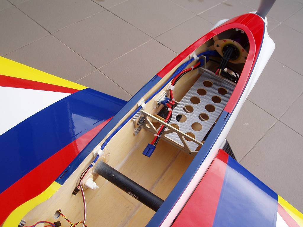

I use EC5 conectors from Hobbycity
http://www.hobbycity.com/hobbycity/store/uh_viewItem.asp?idProduct=9194&Product_Name=EC5_5m m_Connector_(Pair)
While the bullet is hot from soldering i slide them into the outer plastic plug untill they rest up against the clip.
Then use a small flat screw driver down the side of the wire to push the bullet past the clip.
Works easy.

Maybe that's my problem. I have been sliding the housing up the wire before soldering the bullet on. How hot is hot? I solder with a torch and have been letting them cool until I can just barely touch them.

What kind of goop (epoxy?) did you use to make your bulkhead arming connector?
