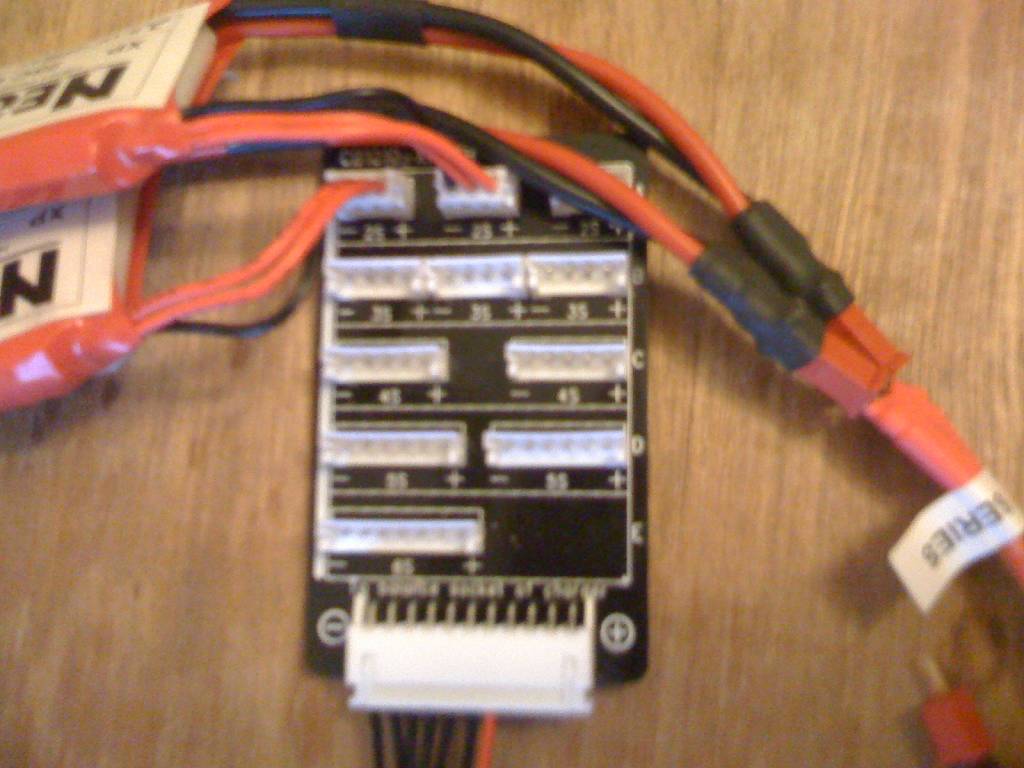

I went to charge my first set of batteries - was practicing with my 2S lipos charging in series as I would with my larger 5S sets. I was sure I hooked everything up right, the charger went through it's paces and let me start charging. Within a few seconds the charger was smoking from inside.
I stopped everything. Charger appears to be working OK, but the batteries differ quite a bit in internal resistance, although I never checked them before the charge. Sometimes both batteries will tell me there is a voltage problem at the balance port.
Here are pics of the setup. The charger is capable of up to 6S charging/balancing (this was only 4). The batteries appear to be properly connected to the balancer as my other charger was able to read all the cells as one 4S battery. I hooked one red battery lead up to the other black lead, then plugged the free ends into the corresponding colors on the charger.
Not sure what I did wrong but I'm afraid to do this with my 10S setup.

Sent you a PM. On my charger I need to have the balance tap from the battery with it's negative power lead going to the charger plugged in as the, for lack of a better term, "most negative" on the balance board. If not you are putting a short on the pack...your charger may be different.
Pete's right, and the way you have it wired makes it impossible to tell which pack is #1 when viewed from the balancing circuit.
As Pete said, the pack who's negative lead is connected to the charger must be plugged into the A or first connection on the balancer board, otherwise you short it out. This is the same for every type of charger I have used, I don't think yours would be any different.
I would suggest wiring it different so you can clearly see which pack negative lead is going to the charger.

Cell count is done from the side of the negative that goes into the charger. The same is valid for the balance plug negative.</p>
I did make a mistake once but the only thing damaged was the balance split cable. Some friends reported damaging Accucell 6 charger if not connecting the balance cables in the right order.</p>

You guys got it, had no idea...
Thanks Pete for the phone call!
So, my IR for the cells are: (55 60) (123 78) - is that a problem, or am I still OK??
Looks like I shorted something out in the charger, hopefully the EE guys at school will help me out
