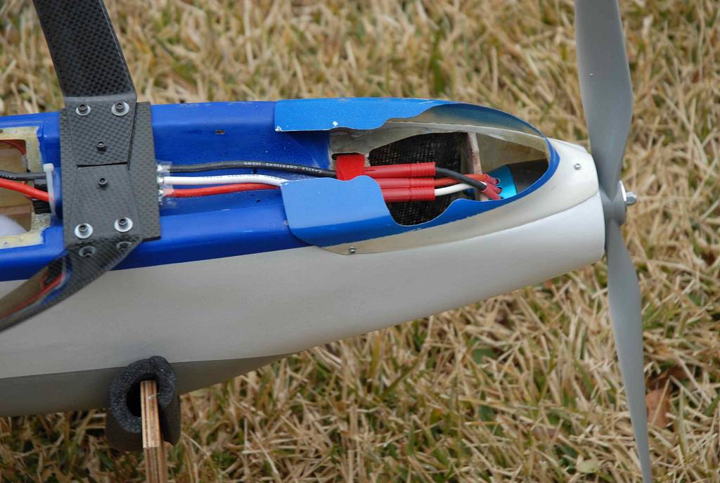

Well, I finally completed the trim flight of the converted and would like to report what I have done.
What I feel important things for a successful conversion are as follows.
1. Trim weight from the glow engine setup as much as possible. Since an electric motor vibrates much less, lighter weight material can be used instead for frames, firewall, etc. On top of that, two 5000 mah battery packs can weigh as much as 2lb 11oz and the outer runner motor 21 oz. One has to trim the weight everywhere to meet the 11lb weight rule.
2. The current design of popular f3a motors suitable for 2m pattern planes calls for big E-props (e.g. 20.5" or 21"). The old landing gear good for 18" prop does not provide enough prop clearance. A tall landing gear is needed instead. In the Sequel, I decided to install a fixed 9" CF gear. The total weight is 4 oz. The landing gear servo will go.
3. Two 5000 mah packs take space and for Sequel I decided to access them from the bottom of the fuse. Originally I thought about opening up the canopy area for the purpose. To save some labor and maintain the integrity of the CF fuse, I decided to let the two packs hang vertically from a deck with Velcro strips. It seems the idea worked well.

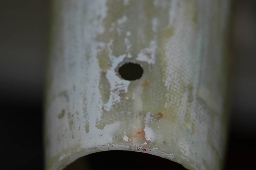

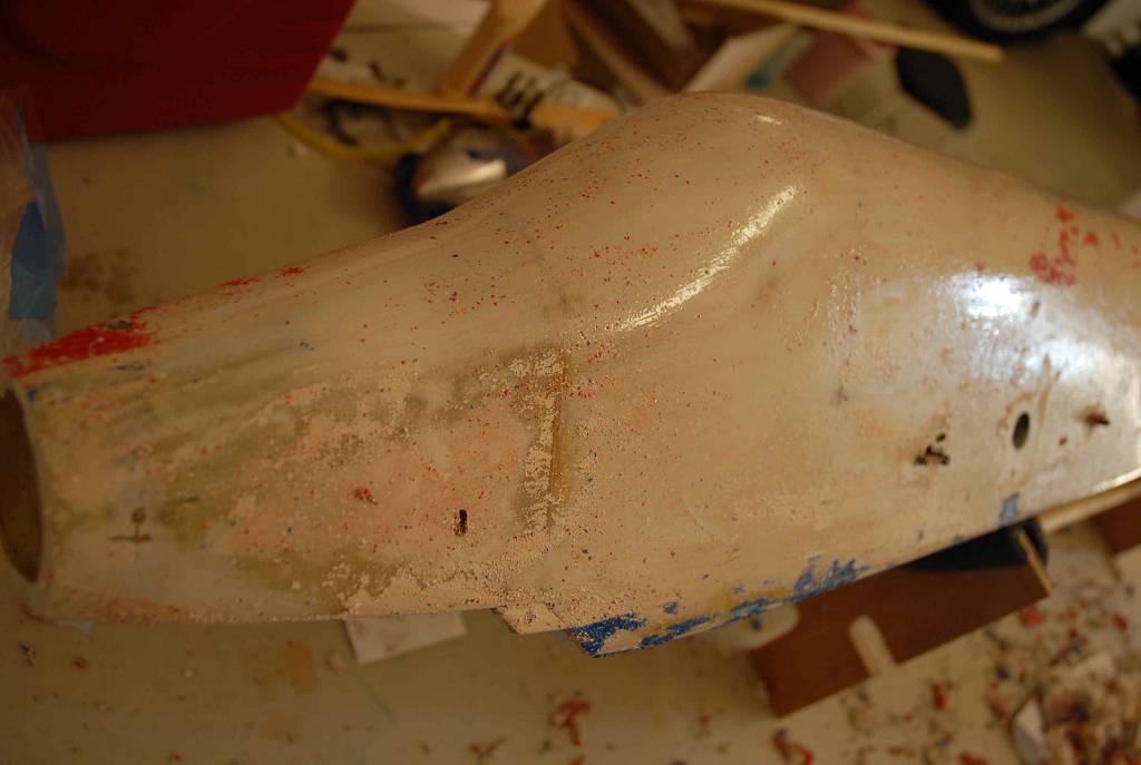

The first thing I did was to strip the Epoxy paint from the fuse. I used Citristrip and it worked out OK. I found one has to careful not to let the liquid to penetrate the fiber glass material as it can leave oily stains that are hard to remove and make repaint difficult.
Anyway, here are the two pics showing how strong the Citristrip is.

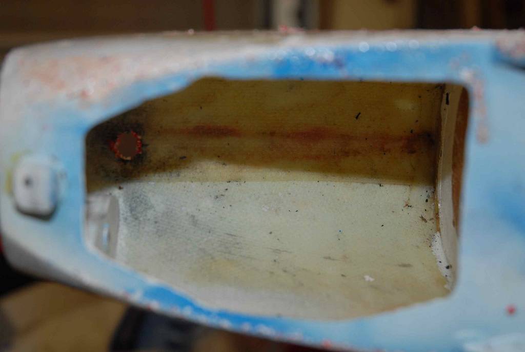

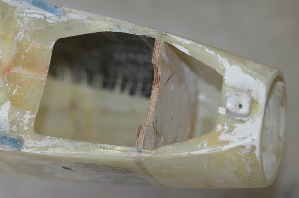

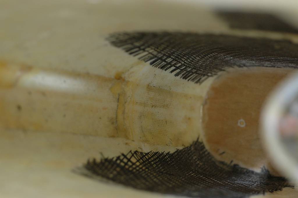

Pictured below are thick plywood parts - firewall, frames, servo decks etc. They must go.
The firewall was removed 90% originally and a thin ring was left untouched. Later on, the ring was removed as well.
From the 2nd picture it can be seen that the wood was "wet". It is so because the tank under pressure of the YS engine leaked and the fuel got to the wood.

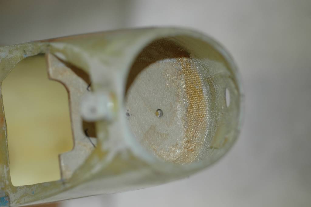

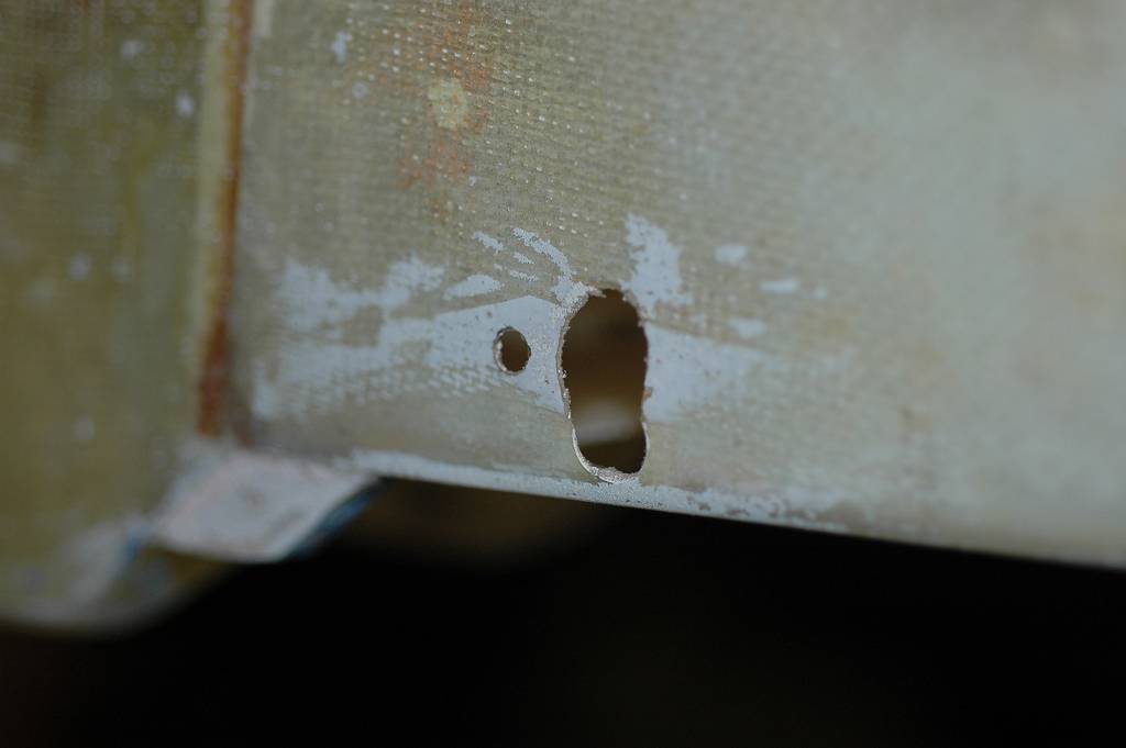

Cutouts for glow engine setup will be patched with fiber cloth and filler. Shown in pic1 and 2 and the needle cutout and fuel/return line mount holes. They will be gone. The wood back plate will be removed.
I purposely left alone the access hole for YS regulator adjustment, as it allows some cooling air to hit the motor. I was also considering install an air scoop at that location if the motor runs too hot. See pic3.

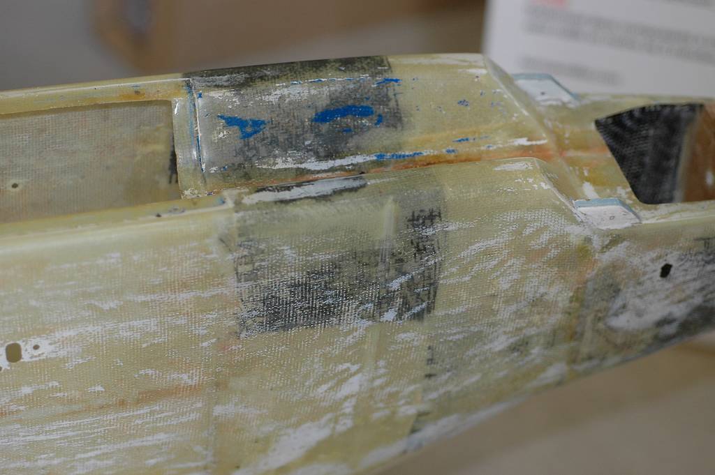

The next step is to reinforce the nose area to better support the motor and to spread the torque/load. I heard stories of motor ripping off the thin fiber glass when it is not done so.
I did the same for a section of fuse where the landing gear mount plate will be installed.
For both areas, I used 1 layer of 6oz carbon fiber cloth. After the application, both area is as solid as it can be.
Pic1 shows the landing gear area, and pic2 and 3 the nose area.

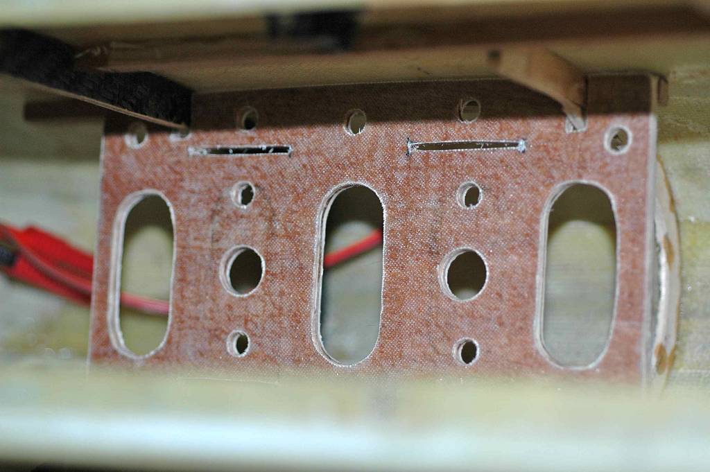

Now the exciting moment came as the motor can be mounted.
FIrst, I measure the depth of the motor from the prop washer to the rear. That become the location of the firewall on fuse. I then draw one line at either side of the fuse. I allocated points on those two lines about half inch between consequent two points. Setting the fuse on the table and put a ruler against the fuse side, I measured the distance between the straight edge of the rule and each point allocated. The measures allowed me to draw a firewall template on paper. I was able to get a very precise template in one step.
I decided to use Himax F3A 6330 motor as it was just introduced to the market and has the same mounting pattern as other more popular outer runner. I figured I can always go with a better motor later on.
Shown below are the installed motor mount / firewall made from 3mm aircraft plywood, and Himax 6300 installed on the new mount.

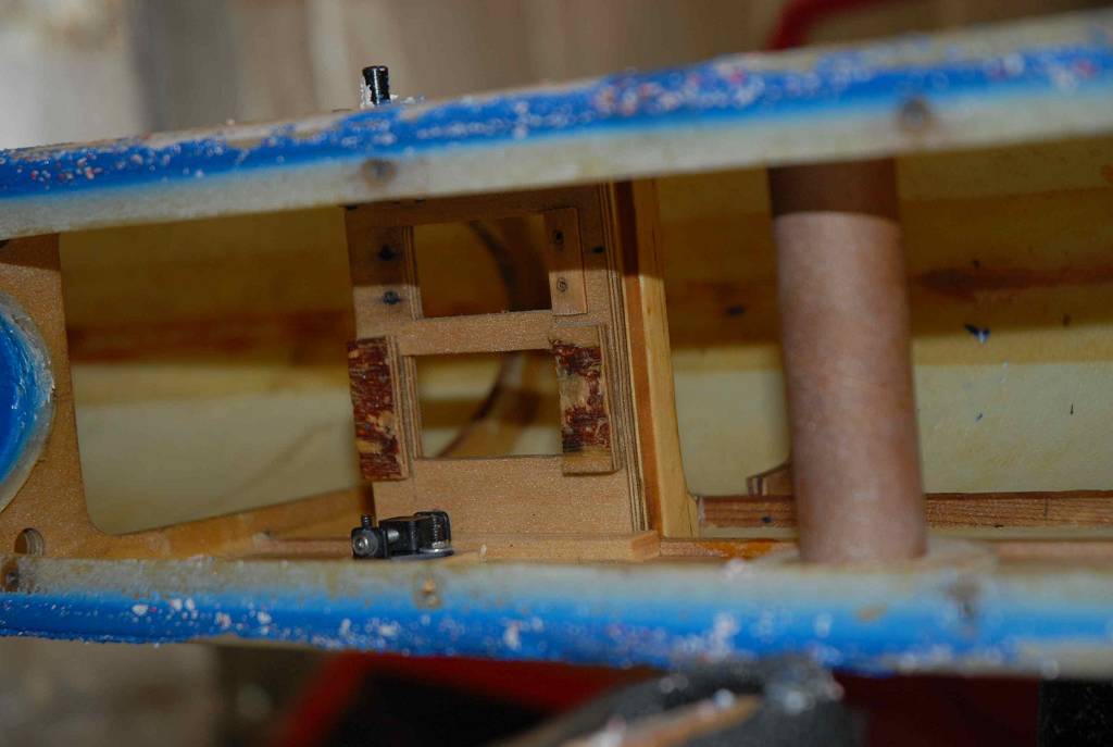

With the landing gear done, I can focus on the deck for battery packs, receiver packs, receiver, and elevator and rudder servos. In fact, I found I need to build two such decks since I want the battery pack to be in the center of the fuse. If the same deck was used for servos, the control links will not be 90 degree to the control horns at the tail.
In Sequel's original design, two stringers are used on each side of the fuse. Together with two frames on each side, they form a rigid box in the wing section. I decided to do the same with lighter material. The servo deck will be built on top of the one pair of stringers.
The battery deck will be built on top of the box, as shown in the pics below.
To save weight, I used 1/8 balsa laminated with 1/32 plywood on one side for the receiver battery and the receiver, and regular 1/8 light ply for servo deck. For battery deck, I used 1/4 light ply found in Lowe's and laminated with a thin layer of fiber glass cloth.
Wing incidence angle adjustment brackets are installed on pieces of 1/8 ply wood. Each is smaller and thiner than the original design for glow engine. To spread the load, I patched the area 1/2" larger on each side of the wood piece with 6oz fiberglass cloth.
Pic1 shows one of the frames for the box structure. Two 1/4" cuts are made to accept stringers for the battery deck. These stringers are supported by a short frame. Pic2 provides a focused view of one side of the mounting structure for the two decks. Pic3 shows the plate for battery deck.

At the end, three more colors of KlassKote were acquired: white, deep blue and gun metal grey. All gloss type. I wet-sand off almost all primer and applied these three colors in this order: white, grey and blue. GreatPlane's mask tape was used to separate colors.
I am pretty happy about the end result as the surface is very tough and durable. I wet-sand with 800 grit sandpaper the entire surface when done. The surface is unbelievably smooth and no edge can be felt between two different colors.
I have been a fan of K&B Ultrapoxy paint and decided to use KlassKote's Epoxy paint instead. Originally I thought about applying only the white primer only to save weight. It turns out the primer does its best to be sandable. The surface is not durable as such and I do not think it can last long. During priming, I added 40% in volume of milled fiberglass to help fill dents, pinholes etc.

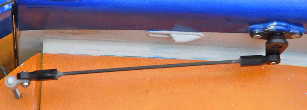

Heavy-duty control linkages can be replaced by lighter ones. I borrowed the idea from Todd Bloss and did the replacement for all linkages. Parts used: 2mm carbon rods JB-welded to CHS 2mm rod ends. A total of 1.5 oz was saved!

Thanks Texzen1. Access from fuse belly for batteries may not be the perfect way but so far it works (with some practice) :-).
So far, with Turnigy 5s 20c packs and the Himax 6330, CC HV85 and 4 cell Nicad rx pack, it weighs about 11 lb 4 oz. I can cut 4 more oz with CC HV80 and Lipo+regulator setup, or go with lighter packs.
