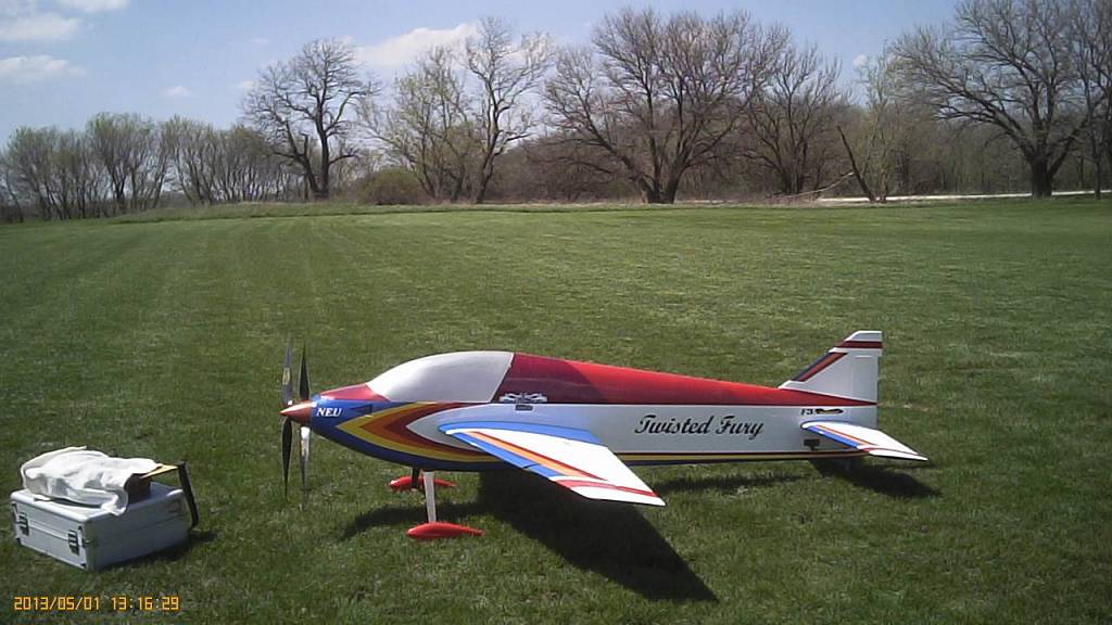

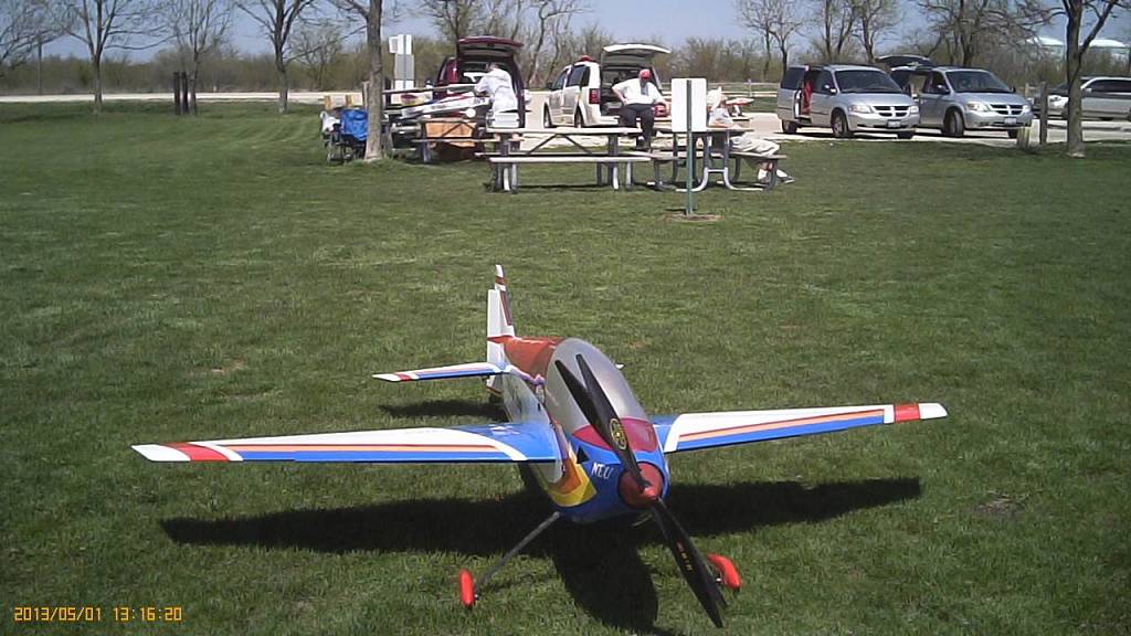

Hi Brenner, finally was able to get out this week with the new plane and the updated contra drive, everything working great and hope to fly in the Muncie contest in a week. By that time it may have 20 flights, as you know weather has been late this year compared to last year so it’s been difficult for our guys to get out.
Here are several pictures of the plane; all wood fuse with Andrew’s Proteus wing and stab, weighs 10.8 lbs with F3AU 5100 batteries. If I ever build another one I think the weight can be reduced some with some modifications to the framing.
Hope to see you in a week.

Hey Dave,
Your plane looks good. I look forward to seeing it fly.
I've resurrected my Wind S Pro with the Spark Evo wings you built for me, and it's flying better than the one I had last year, if that's possible. In my view, it's got to be the best plane I have ever flown.
I'm using a 22x20 rear prop with a 22x18 front prop, and with this combination I am pulling about 3200 mah out of my packs for a typical Masters flight flown at 100% ATV on the throttle. If I back off on the throttle , I use about 2800mah per flight. I am at 4990g using Zippy Compact 5800mah packs.
By the way, my calendar shows Muncie on the 18th and 19th, which is two weeks. This is the contest you are talking about right?

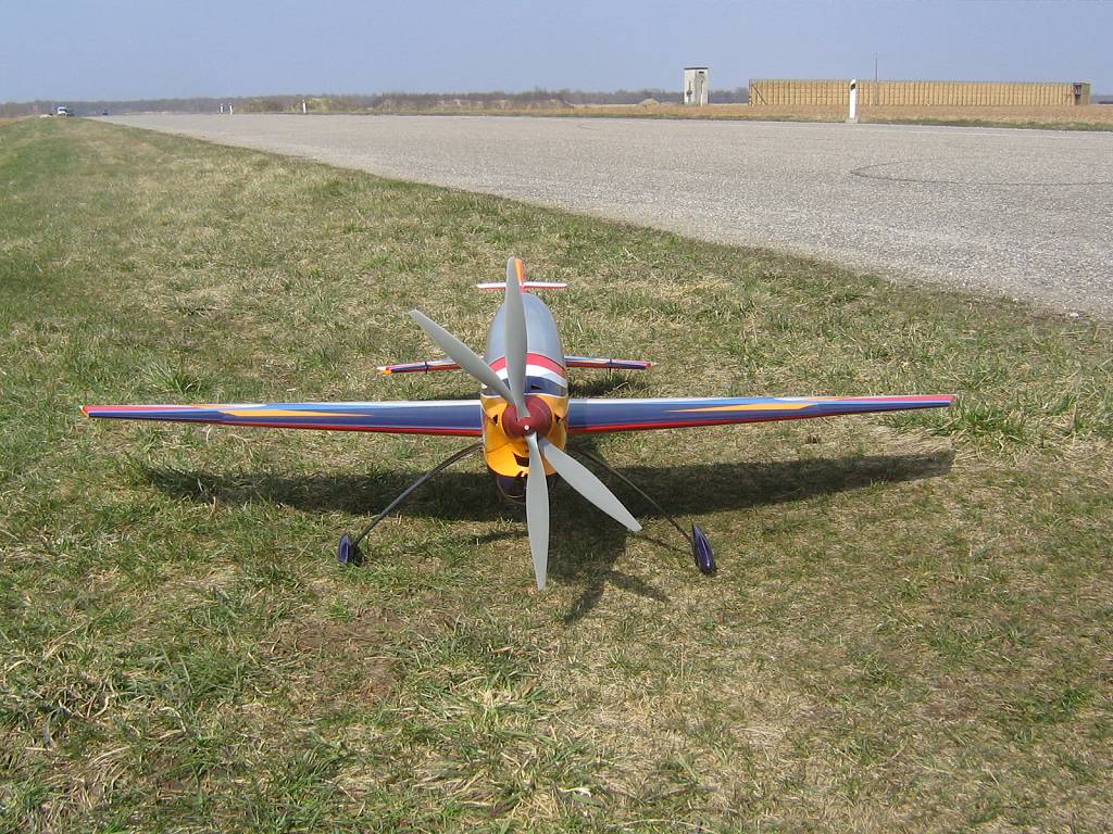

Here is mine. This is the Gadious. Neu motor. 22x20 and 22x18. 10.15 gear ratio. I like prop combination and works well in windy conditions. This spring has been crazy and I still need to try in very calm conditions. I think is going to be OK. I got around 40 flights already. I finished installing the stab fences. I tried the rudder strips and liked more the stab fences.
