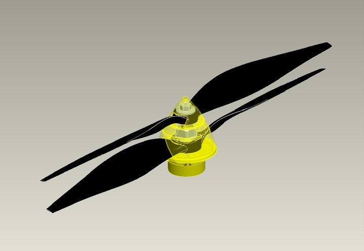

It's a stock Integral with a counter rotating drive swinging a pair of 22 X 18 handmade (by Mike Gaishin ...) carbon fiber props. The motor is a stock Hacker C50-14XL.
I started working on the design back in November of last year, and with the help of Mike and Andy Gaishin of Gaishin Manufacturing doing all of the fabrication, I've finally got it in the air.
I first flew it last Thursday for three quick flights, and I got another three quick flights in on Saturday afternoon after the Jimmy Hubbard Memorial Contest in Chicago. All during those six flights I was trying to get the right mixes in for knife edge, and downlines, but I was still struggling with my vertical uplines. They seemed okay, but the plane wasn't locked in like I'm used to with my Integral.
So last night I added 0.5 degrees of down thrust and flew it again this evening, and it was like throwing a switch. All of a sudden it was absolutely perfect! The uplines are now locked in like the plane is climbing a ladder and the downlines are plumb line straight.
I am absolutely over the moon. Right now it's flying exactly like I hoped it would fly but better because it seems there are additional benefits that I didn't anticipate.

The rpm of the props are 3750 rpm. The gear ratio is 9.8:1. I chose the 22 inch diameter prop because I wanted to swing as large a diameter prop as I could to maximize propeller efficiency, and I chose 18 inches of pitch because I was trading off reduced propeller efficiency at low speeds versus straight line flight speed.
Based on my initial flight tests it looks like the 22X18 prop is working well, but there are fewer problems at low speeds than I anticipated, which is probably due to the fact that the front prop speeds the air up before it enters the blades of the second prop, so even if the front prop blades are stalled, the rear prop blades aren't. Based on this I think I could increase pitch up to 20 inches and beyond, and still not have problems at low speed.
Comparing system weights isn't straight forward because I'm removing the stock Hacker gearcase, and the stock spinner, and replacing them with a new spinner/gearcase that's integrated into a single assembly, and then I'm adding a second prop.
However, what I can say is that the Integral with the complete contra rotating system and the same flight pack, came out two ounces heavier than my old Integral with the stock Hacker C50-14XL, and a single 21X14 APC prop.

Any pics of the gearbox? The ring gear housing / integrated rear spinner section is really neat. Would love to see how you attached the unit to the motor.
Do you plan to market the unit?
Here are some pictures from the Pro-Engineer solid model that I used to design the unit with.
We are to prepared to market the unit if there is enough interest, but the pricing is highly dependent on the level of interest, because for small quantities most of the cost is due to CNC setup time. If the interest is high then we can consider making some tooling and fixtures that would have the potential to bring the price down considerably.
