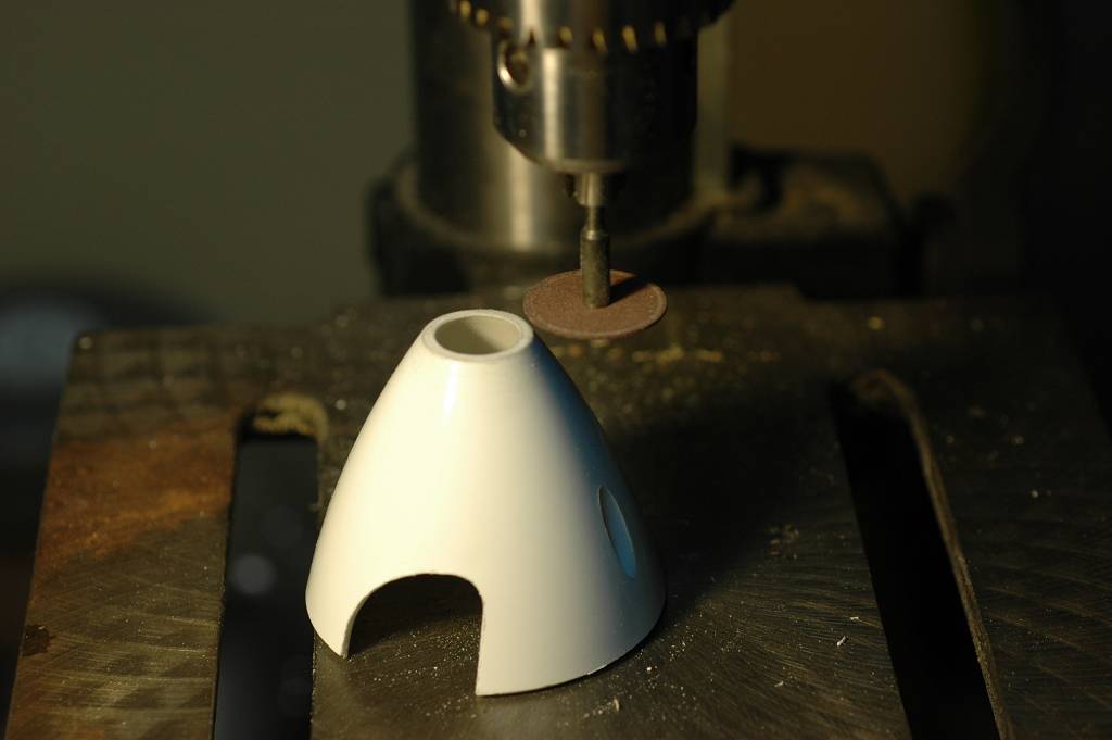

I did the cutting with a Dremel cutting wheel mounted on the drill press. Here are the steps.
1. Adjust the platform to the right hight so that the cutting line is at the wheel level.
2. To cut, just gently push the spinner to the spinning cutting wheel.
I found the plastic material on GP's spinner is pretty tough. It can easily break the abrasive cutting wheel if the spinner is pushed too hard against the wheel. So use caution.
I cut mine with this method in about 5 minutes.

ORIGINAL: nonstoprc
One of the problems you may be having it that even if you put that drill press on its highest speed, it is still about 1/4 what a Dremel tool turns. Those abrasive wheels work better at higher RPM.

I use the Dremel fiberglass reinforced #426 cut off wheel in my drill press to do the job. No Problem!

Yes, some better and sharper cut wheel can be used.
I do not feel the abrasive cutting wheel cuts that slow on dress press. Just take the time. The benefit would be precision cut. Actually, you can use this method to help make pilot cuts and then enlarge them to shapes such as those of water drops shown in F3A Unlimited's CF spinners.
