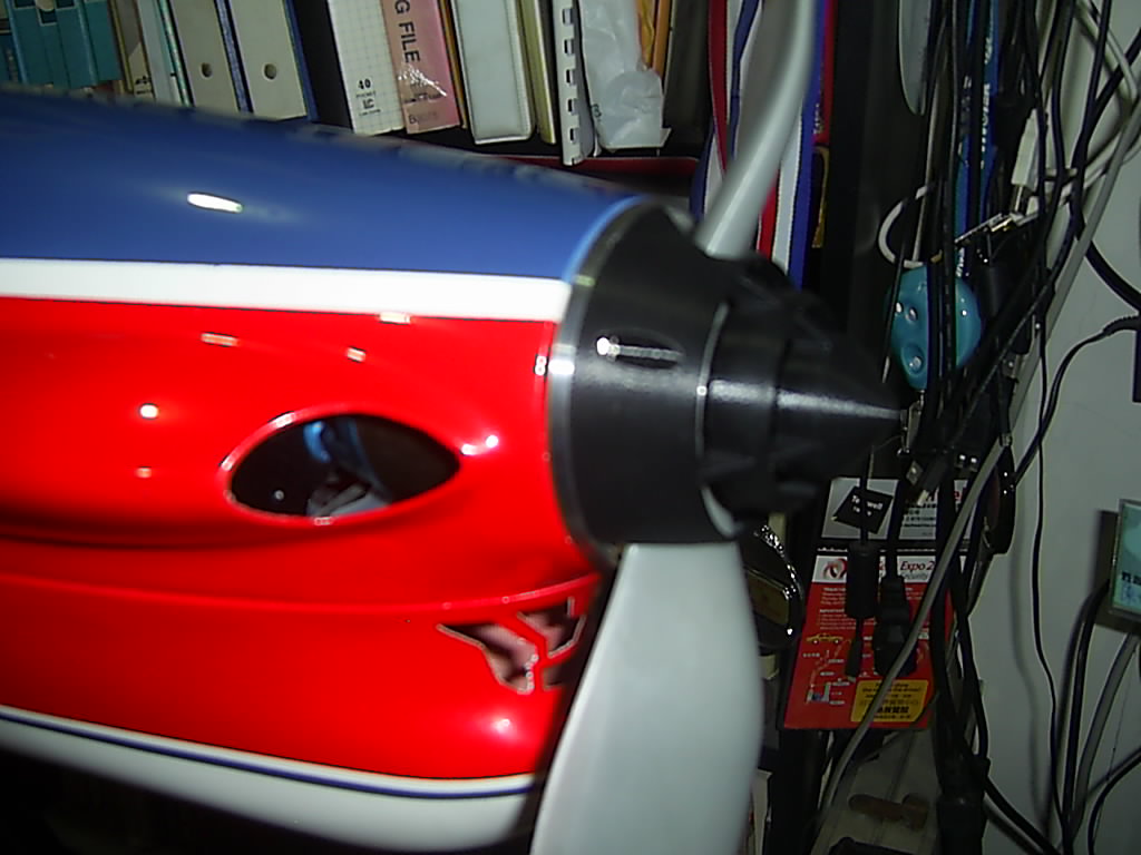

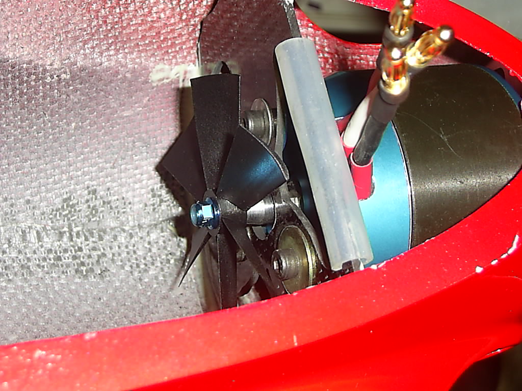

Hi every one,
Same as my problum. I am fly E-F3A in Taiwan, it's hot and humidity weather here,
So we also need cooling spinner too
and i have one good idea of cool spinner share for every one.
maybe another day i'll do it one sample by(RP FDM).[img]

Andy, that is one cool looking spinner[8D]

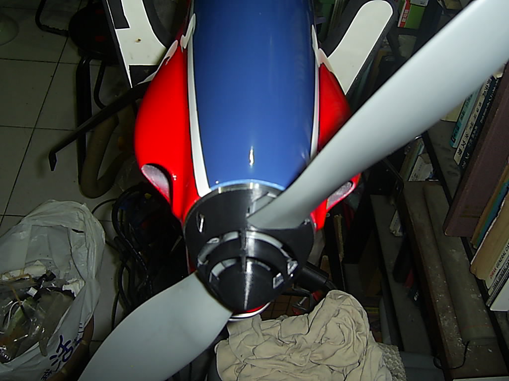

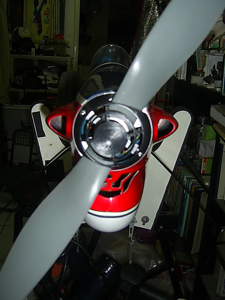

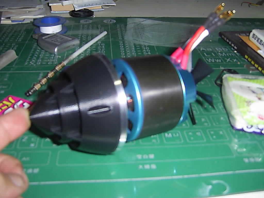

Thank's matt13
I am keep on this idea come true
Used my company 3D printer do it one for test..
share picture for every one...
check it out..
