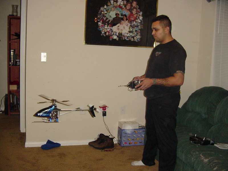

just go buy a micro whip antenna for about 15 bucks and be done with it. when you get the micro whip antenna the instructions tell you to cut the old antenna to about an inch long any way, so if you still have that much left you can install the whip antenna with no problems.
thanks Chris
ps check out the pic of mine that is what the whip antenna looks like. the antenna is mounted to the lft skid.
