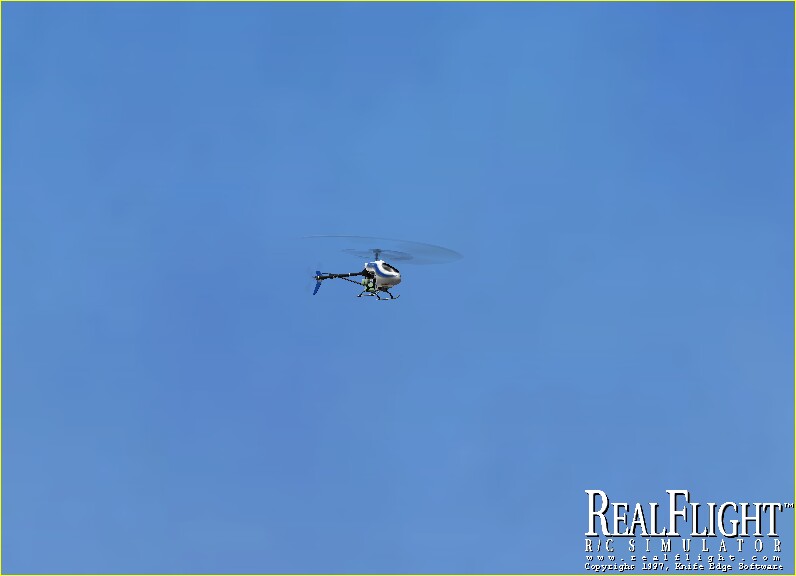

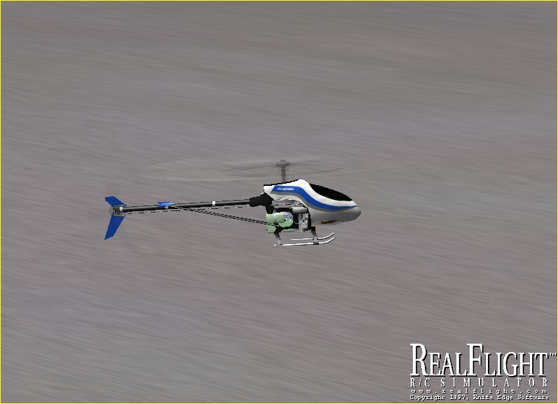

Trex on G3:
ID:	290718   Click image for larger version
