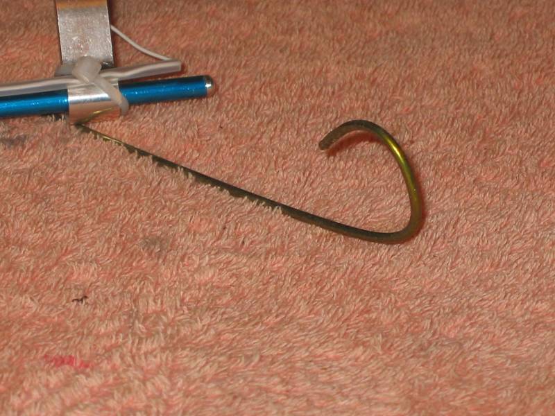

As RussWisc mentioned, with CF rods bigger in diameter than what you currently have. However, I don't think you'll get them to be rock solid and not vibrate at all. There's alot of force coming from the main blades, it's not the rods causing the vibrations, it's the size of the ping pong balls or whatever you come up with. The smaller the better. Best thing is to look around the kids toys at a mall somewhere and get some ideas there. Hmmmm, something smaller than a ping pong ball, that is the question?
Hold on, I'm thinking.......................................... .......................................... Got it!!!!
Just use some metal coat hangers with the ends made into a loop, you'd have to construct a center point for all four to meet and connect to. Probably a small piece of hardwood. Here's a picture of the idea, it's only a mock up, of one hanger. But should work and give no vibrations. Also, forgot to mention, you can make them any length you want them.
Let me know if you consider it and if you do, how it works out,
Dave / Choppersrule

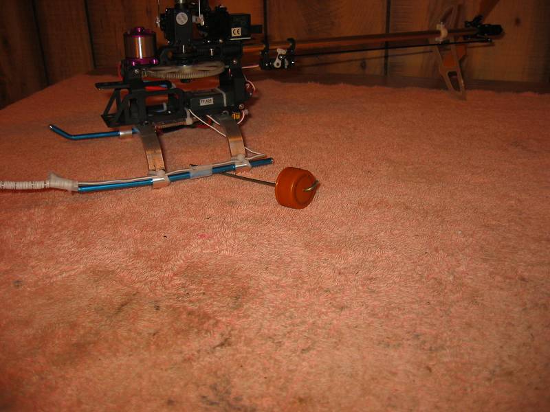

My orignal idea of the coat hangers, would more than likely get snaged in the ground or carpeting. Here's a modification to the modification. Add, plastic tops from water or pop bottles. To keep it from sliding around you could use wheel collars.
See pictures of the modified mod. [8D]

ping pong balls and CF rods still looks stronger and lighter

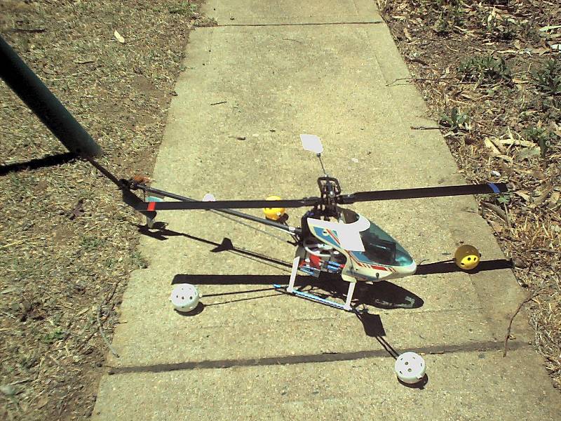

I used practice golf balls and 3mm CF rods to make mine. They dont seem to be heavy because i have had them on my DF22E and my DF36 without any problems. They also dont wear out on concrete like ping pong ball will.

[quote]ORIGINAL: guru101
[/quote
now that looks strong and light

Simple answer is no. If you are getting excess bouncing of your ball's, perhaps you have a vibration problem somewhere else on the chopper. Either that or you need to tell the missus to leave ya alone while your flying
