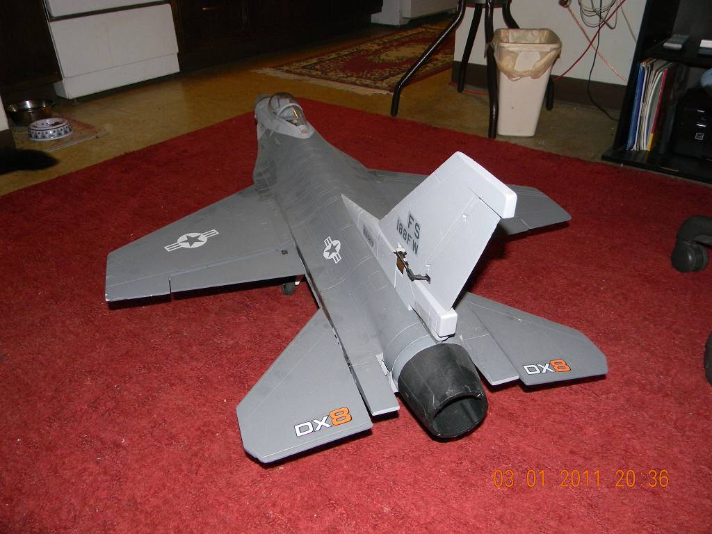

<span style="font-size: larger;"><span style="font-family: Tahoma;">Name's kodiak536.
Just getting into electric EDF jets.
I've flown balsa wood & paper skin model years ago as a child....mind you, I'm now 51....and 1/2
As bad as the reputation online for them, I just bought a F-16 from bananahobby.com
Ordered it Sunday night and just received it few hours ago...not too bad considering their reputation.
All parts accounted for and no apparent damage, it was packed very securely and no loose parts.
Being that I bought just the airframe only model I have some questions as to what & where to purchase the needed parts to complete this plane for flight.
Folowing is what's required, according to their picture book instructions:</span></span>
<span style="font-size: larger;"><span style="font-family: Tahoma;">8 CH RC
9 X 9G servos
50A Brushless ESC w/5A UBEC
2400KV brushless motor
18.5V 25C 2200mAh Li-Po Battery.
Will these be sufficient or will it be underpowered? I have no plans right now to hook-up or activate the vectoring...got to learn how to fly RC before I can do stunts.
I'm former USAF so, I do have knowledge of how the Aircfat fly and do have actual fighter/trainer flight times.
Thanks & Aloha</span></span>

9G refers to the servo size, UBEC is a battery eliminator circuit which is an integral part of the ESC (Electronic Speed Control which provides the control of the motor). Is the fan included with the kit? You might need to procure that also, though I am not sure. Strongly suggest you don't go cheap on the equipment, quality is really cheaper if you don't loose the airplane to electronics failure. Do your homework on the battery. These are not cheap and you don't want one that will not last very long.

Which F-16 is it?
9 9-gram gram servos, must be a vectoring nozzle to it. 2 for the thrust vctor 2 for aileron 2 for elevator one rudder one nosegear 3 retract. Makes 10. If you don't have a rudder servo, and only nosegear steering you need the t/v to stay straight on the runway. Personally, I add in a rudder to planes that lack them. I don't believe in driving a plane off the edge of a narrow runway and toasting it without even getting airborne.
Be careful setting up mechanical retracts. The servos can overload when the throw isn't set right. (center the servo on another channel. Reduce gear throw to plus and minus 30 percent to begin. put the gear halfway and make your link. Then actuate the gear. Best to do one gear at a time. Once they are in the plane, there are more bugs to work out. Gear doors for instance. Don't jam up the servo for long, unplug something)
You've bitten into a beast of a project for a newbee.

If you need a motor, some things to consider. In my F-16 tv, I had to add weight to the tail. I flew it first with the factory CG, and you should as well, a longer static margin is better than a short one. I've set up finally with a 5cell 2200mah 40c pack, outrunner 3300kv 1000watt Cyclone and about 2 ounces of lead in the tail. The motor and lead balance the 5 cell pack to about, 1 cm behind the factory recommended. You should start on the CG set in the plans first, and zero setup on the flight surfaces. Get ready to hold up elevator, well, that's me. Don't STALL the aircraft with too rearward a CG or by applying up elevator against little airspeed. Jets need airspeed for the control surfaces to work, there's no propwash. I flew it maiden from a 75' paved surface. The wheels are small.
I've contacted you to further set up an assistance communication, so you can be specific, and so can I. I've built functional R/C aircraft since 1979. I'm not the greatest, nor am I exact scale, or a master builder, but I can help with the hurdles.
Do you have hardware? I always like to have extra, gives some extra options, and some building experience has told me to save ALL hardware, especially from old or crashed planes.
I will attach a pic of the fan in my LX F-16, which is the same or very similar to the Blitz.
