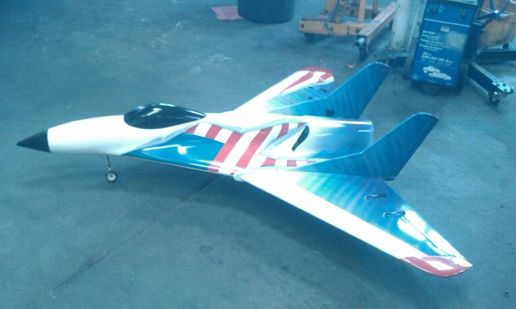

Old 05-29-2011 | 12:17 AM
Joined: Oct 2008
Posts: 10
From: Albuquerque, NM
Default RE: Help!!! More flight time needed...
Pictures of the jet. Still working on the video upload.
