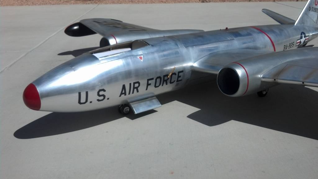

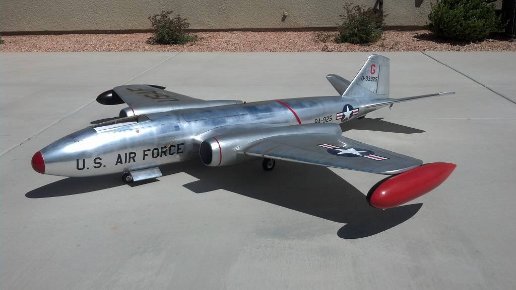

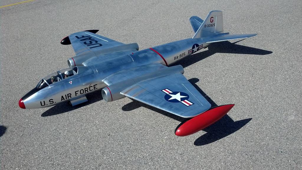

Scratch built Canberra. Just about finished. Just need to do a cockpit.

Very nice Capt. Is that flitemetel on it?

Covered with chrome Ultracote and weathered a little.

Capt G,
That's awesome!  What's the size and fans/motors?  I just received the plans for Chris Golds' Canberra and am planning finishing it as an EB-57.
Rob
Old 04-22-2013 | 10:53 AM
Capt G's Avatar
My Feedback: (8)
Posts: 1,469
Received 18 Likes on 14 Posts
From: Las Vegas, NV
Default RE: B-57B Build
Thanks for the kind words. It has HET 700 -60 2610kv motors with the HET 700 fans. Scales out at 1/9th at 86" span. Weight is about 19.5 lbs with batts on 6s lipos. over 1400 sq in wing area. What are Chris Gold plans?

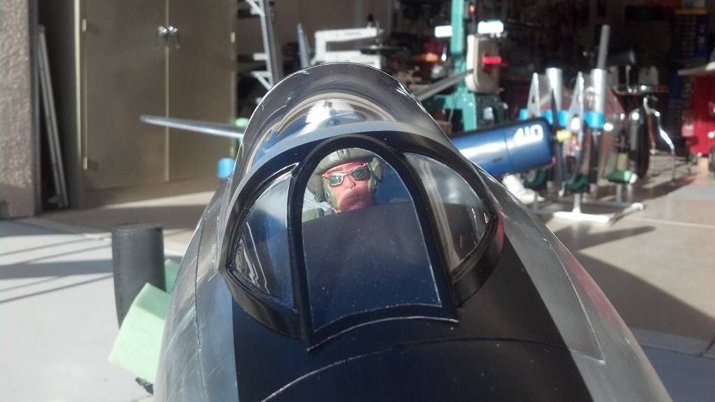

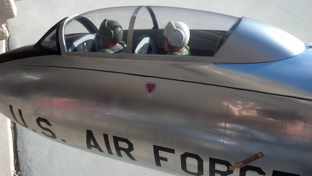

Cockpit is done. Kind of minimalist until I can find a couple scale 1/9th commercial ones somewhere.

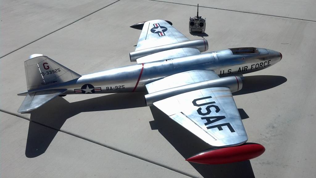

Maiden attempt today. Had to abort when motors were cutting out. Posted a vid on you tube but can't find it.

very nice, I always liked the B-57Bs!. Best of luck finding out the problem with motor cutting out and then successful maiden flight.
