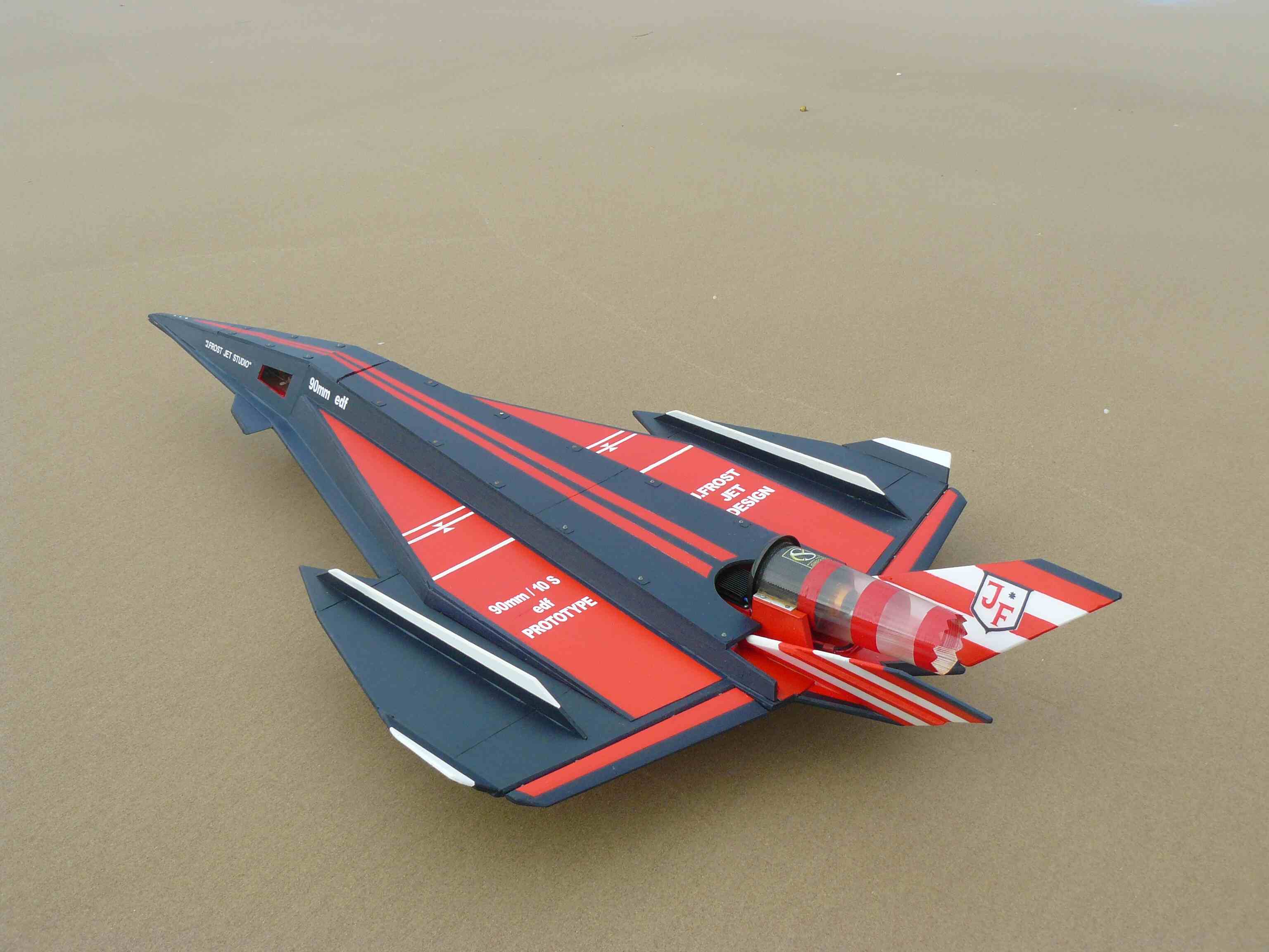

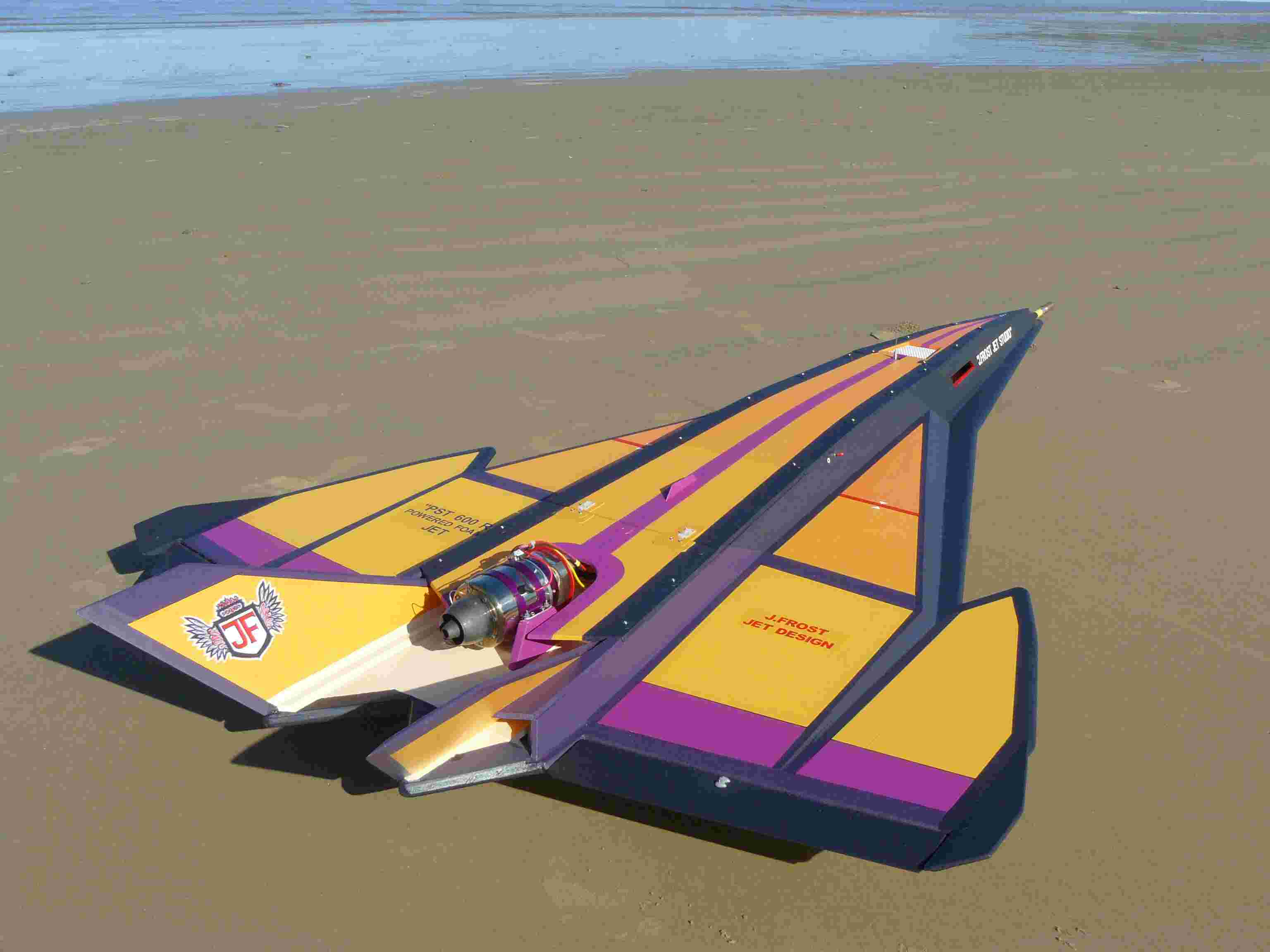

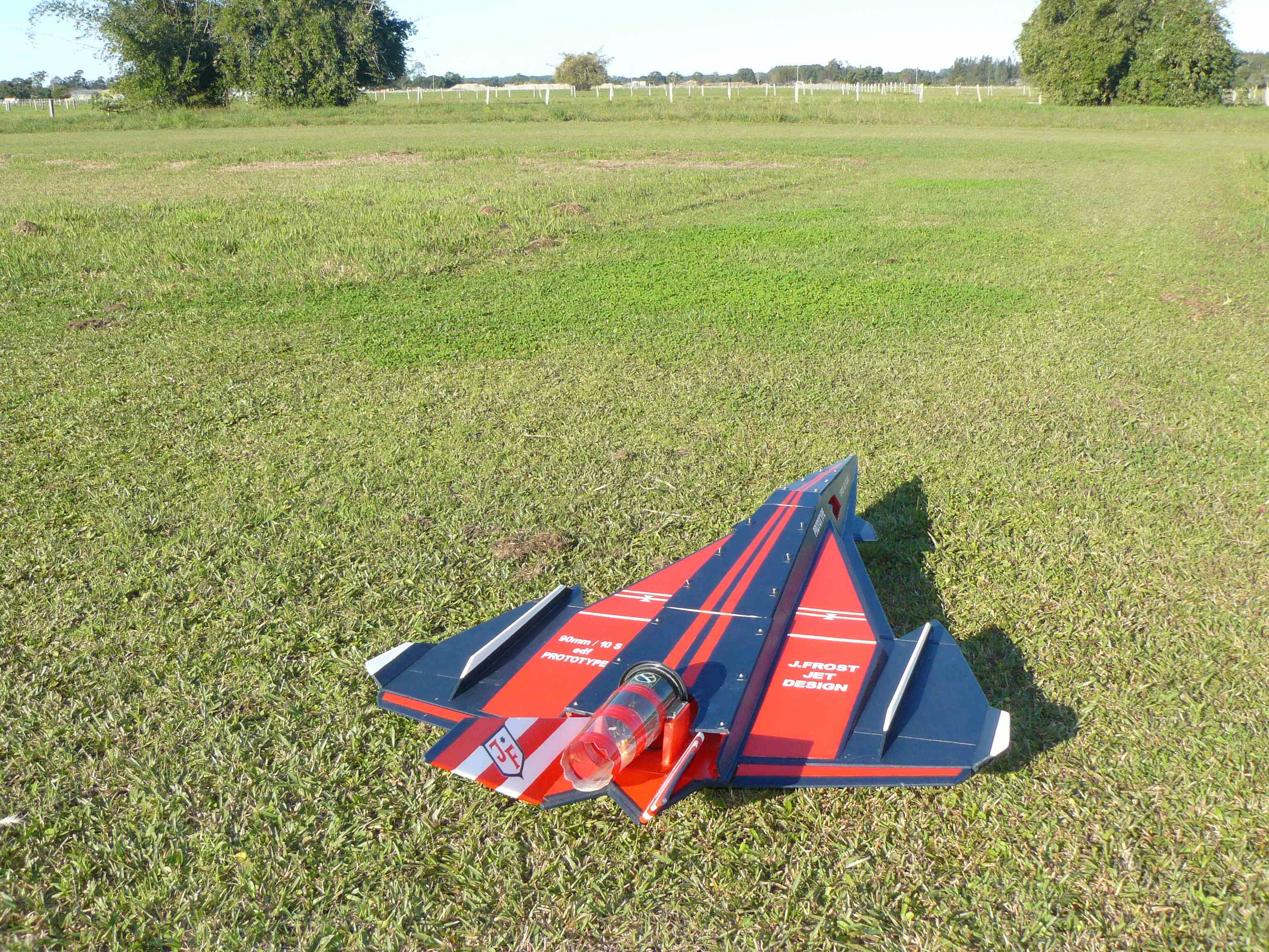

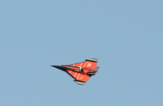

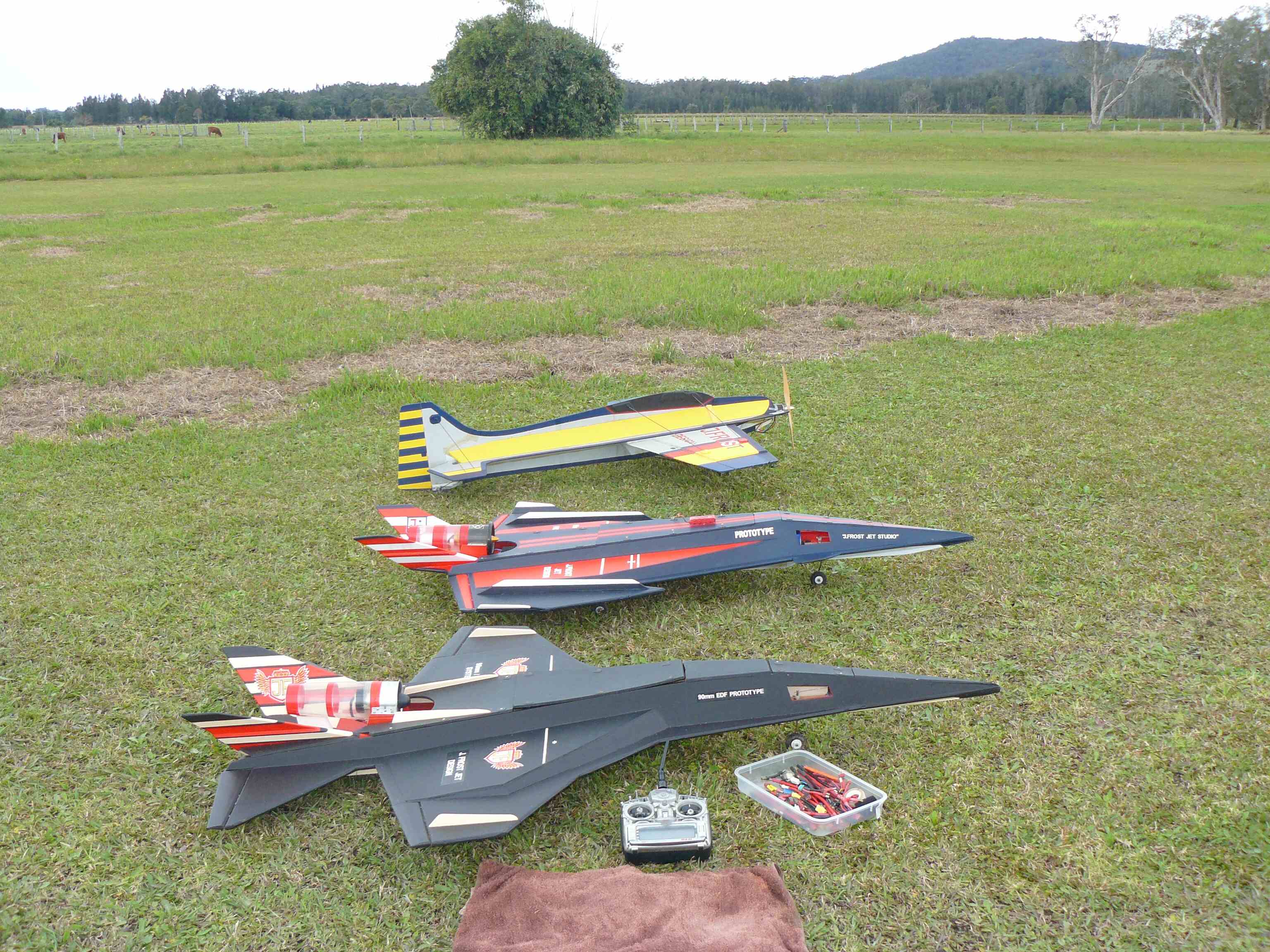

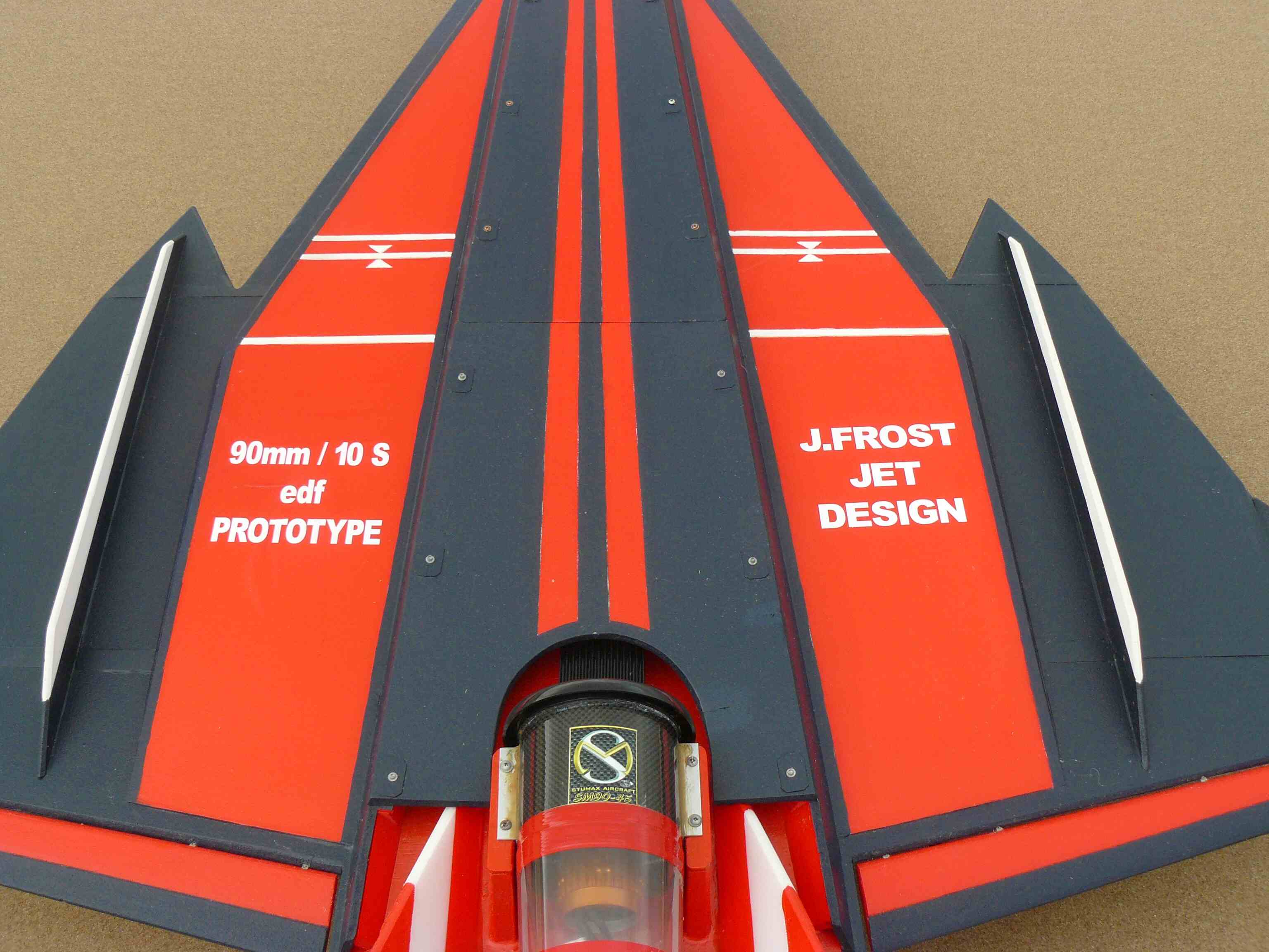

Another of my project I have built some years back as an experiment before building the same but much larger jet turbine powered,
"Touch of Magenta". To make sure it would fly, the safest way was building simple foamy test bed, powered by 3.8 Kw/10S unit with
some 1 to 1.5 ratio size and power wise, comparing to my turbine version. Being own design scratch build, the C of G is always the main
concern with models like this so it is better to be safe than sorry. Simple 2ch. Elevon controls with no Rudder, only extra channel for the
nose steering makes this 7 feet long model run like on rails. The 90mm multi bladed fan with specially designed thrust tube is giving it the best
static/dynamic thrust after bit of experimenting. 4-5Ah packs are used to give me 3-4 min flight times. Not the fastest, but confortably
reaching 200km/h in level flight which is more than realistic scale-wise for such a large sleek air frame. Few pics flying today in perfect calm.

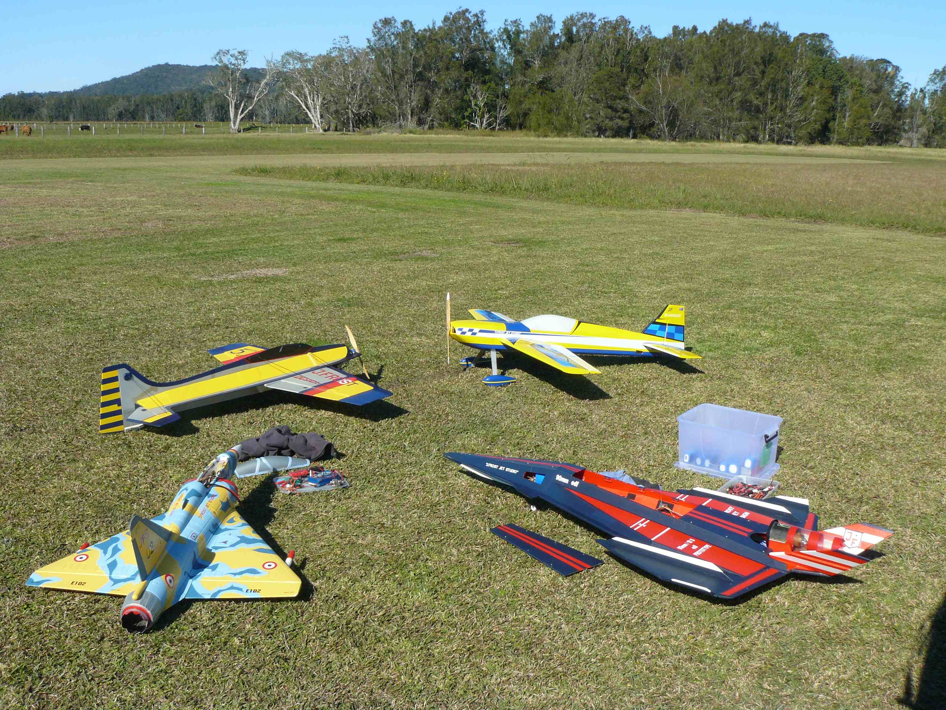

Slightly wet under feet but perfect flying weather for the last 3 weeks enjoying every flight with this beaut. With my new batteries I'm getting 4+Kwatts power, easily taking off the pretty harsh and wet grass strip at my new flying venue.

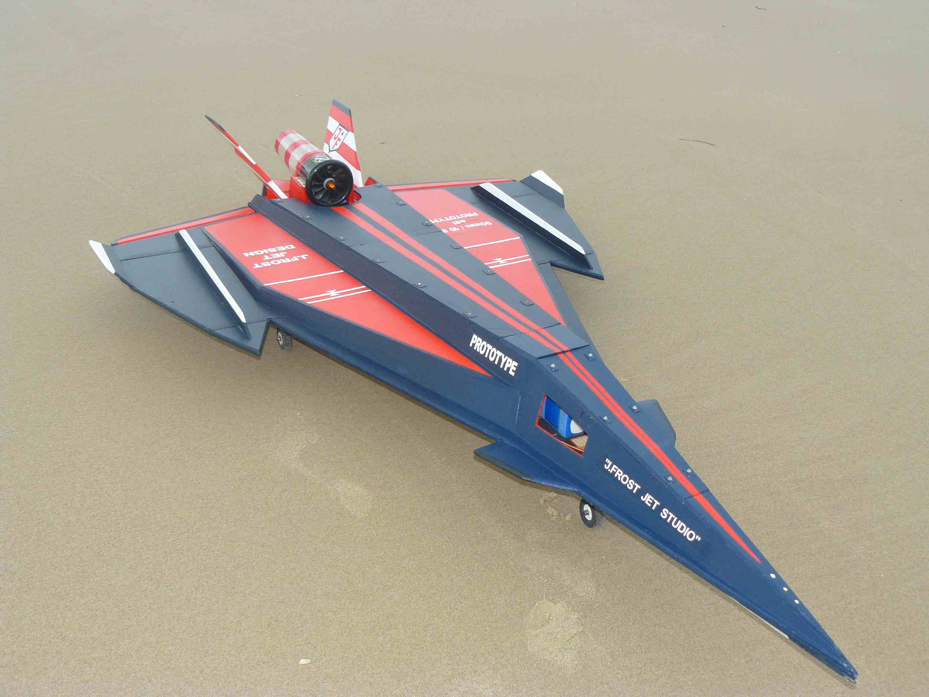

Latest footage, playing in the sand..
https://youtu.be/X2GiivN8X98
