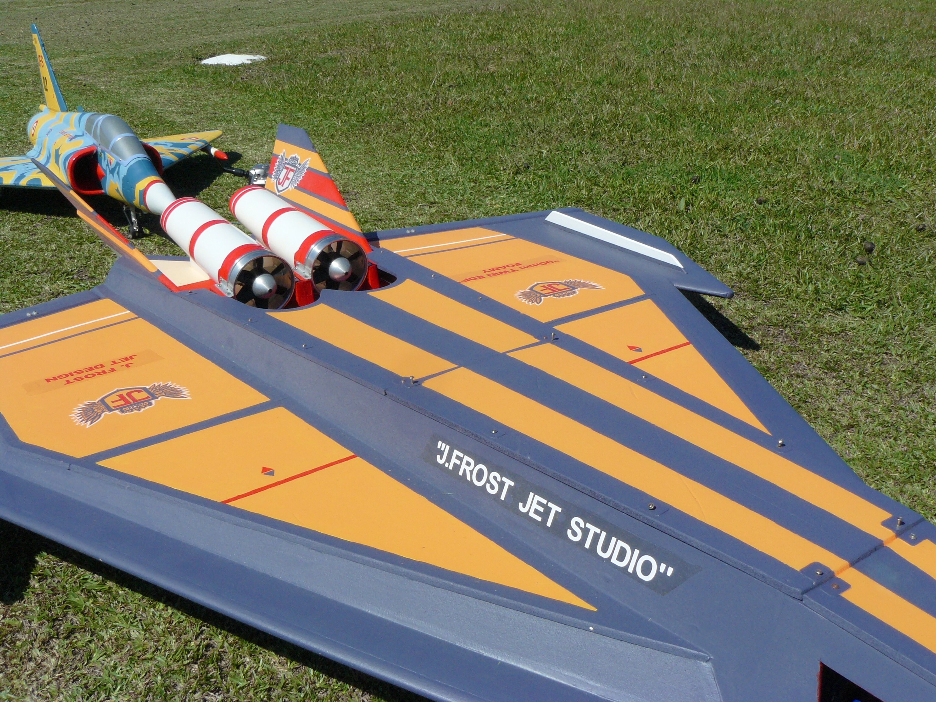

Originally Posted by mayoub
the plane is an me 262. the fans, the ESC's are new and the plane has not flown yet. I have ran the motors and just suspect that the thrust is not equal( no measurement is made) I am asking the question in case I CONFIRM SOME DIFFERENCES then I have some ideas where to look to make any corrections. the batteries are placed forward in the fuse and the ESC's are close to the leading edge of the wing( somewhat long wires between them). no obstruction in the ducts. A far as I know the the throttle position was learned but this can be checked again. Thanks for you response.
With your model having motors so well apart, you try to get them to run as evenly as possible to avoid assimetrical thrust. No motor or ESC would be perfectly identical especially cheap stuff from asia, but most like reason for your power difference is in your batteries if all the leads are identical. I fly number of EDFs ranging from twin to triple motors but having the power units pretty close to the centre line it doesn't create any problem beside the difference in sound, mainly when I fly my "Mig-29" which might be also caused by the long term wear and tear after over 250 flights.
