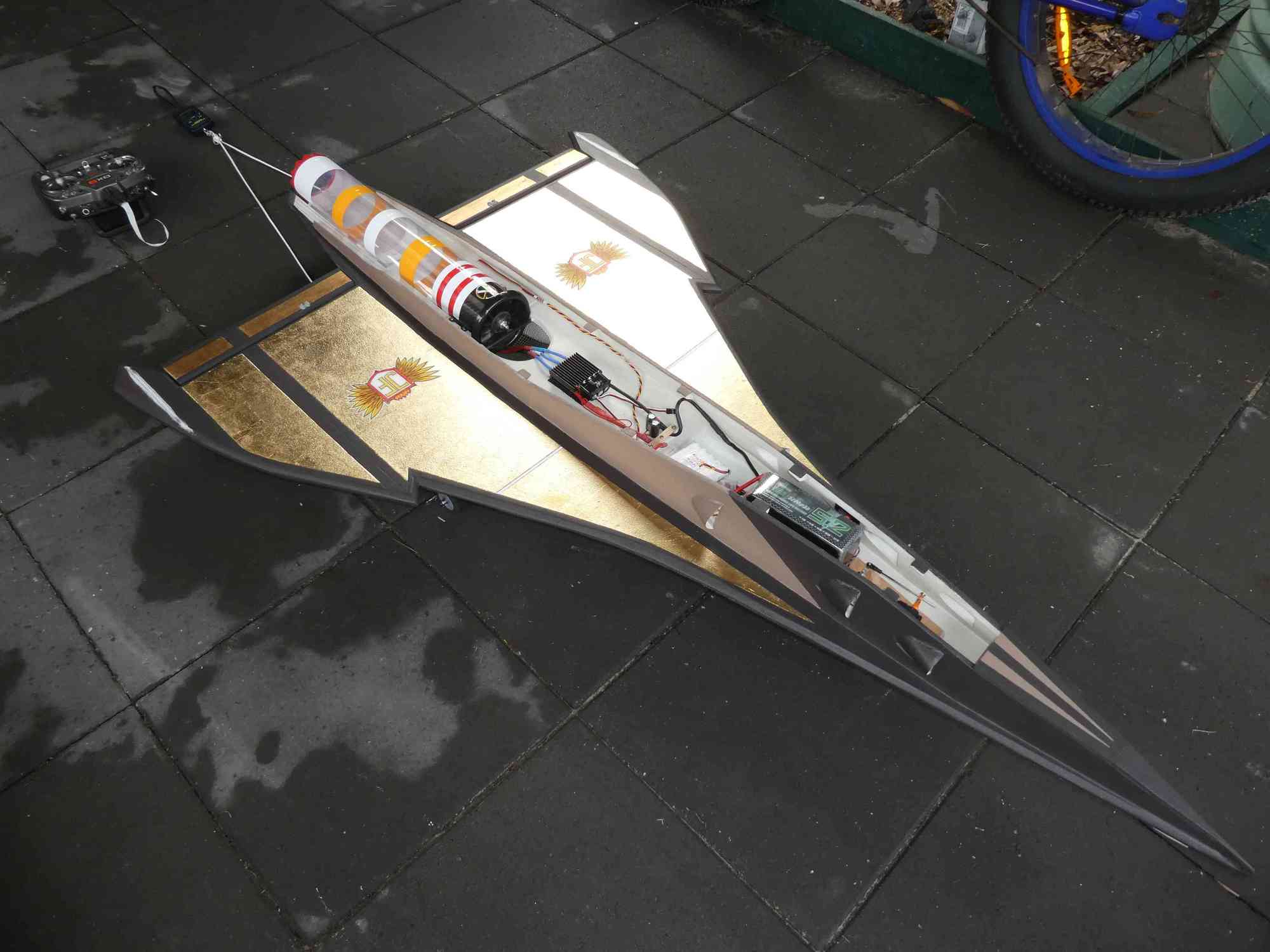

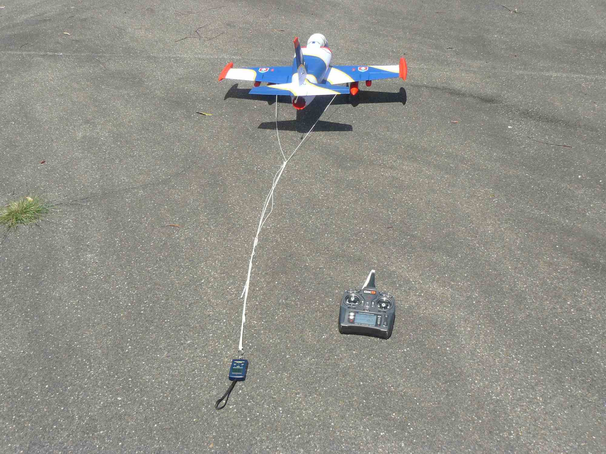

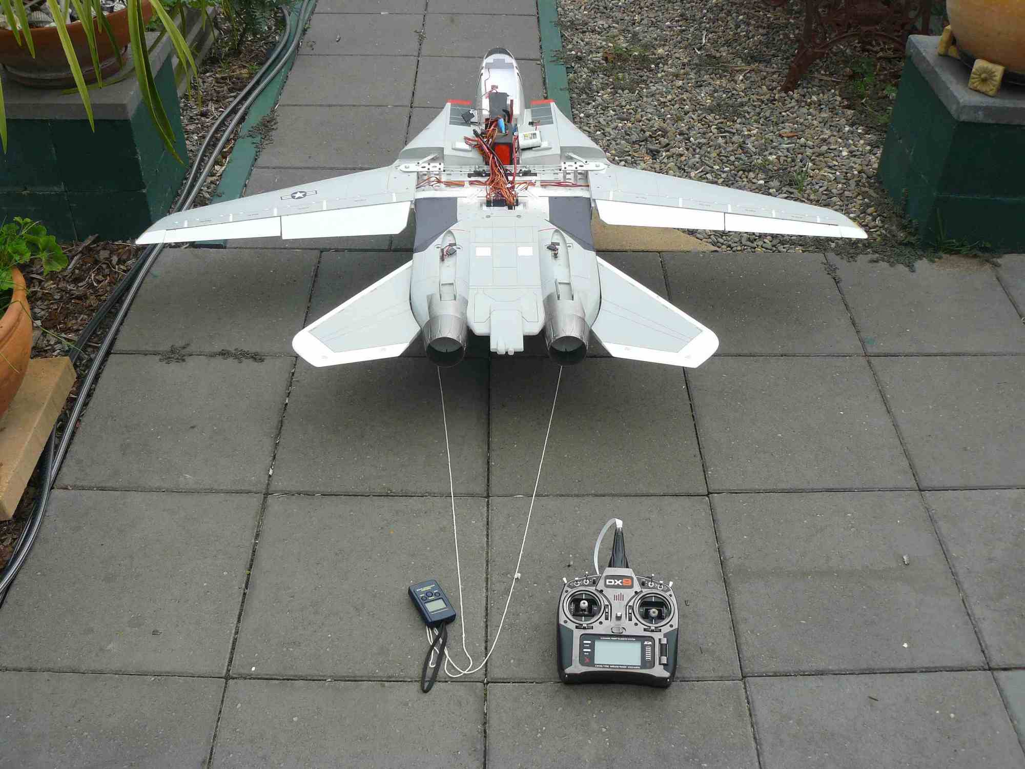

Only one way to find out about the true EDF thrust, hook it up in competed model and test it it.
There is only one thrust that counts, fitted inside the model.
Hook it up to test it.
Gives me good idea how will it fly well in advance.
Regular homework.
It's all in the log books.

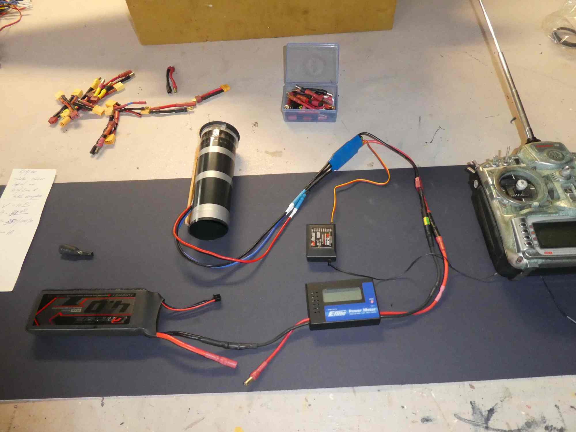

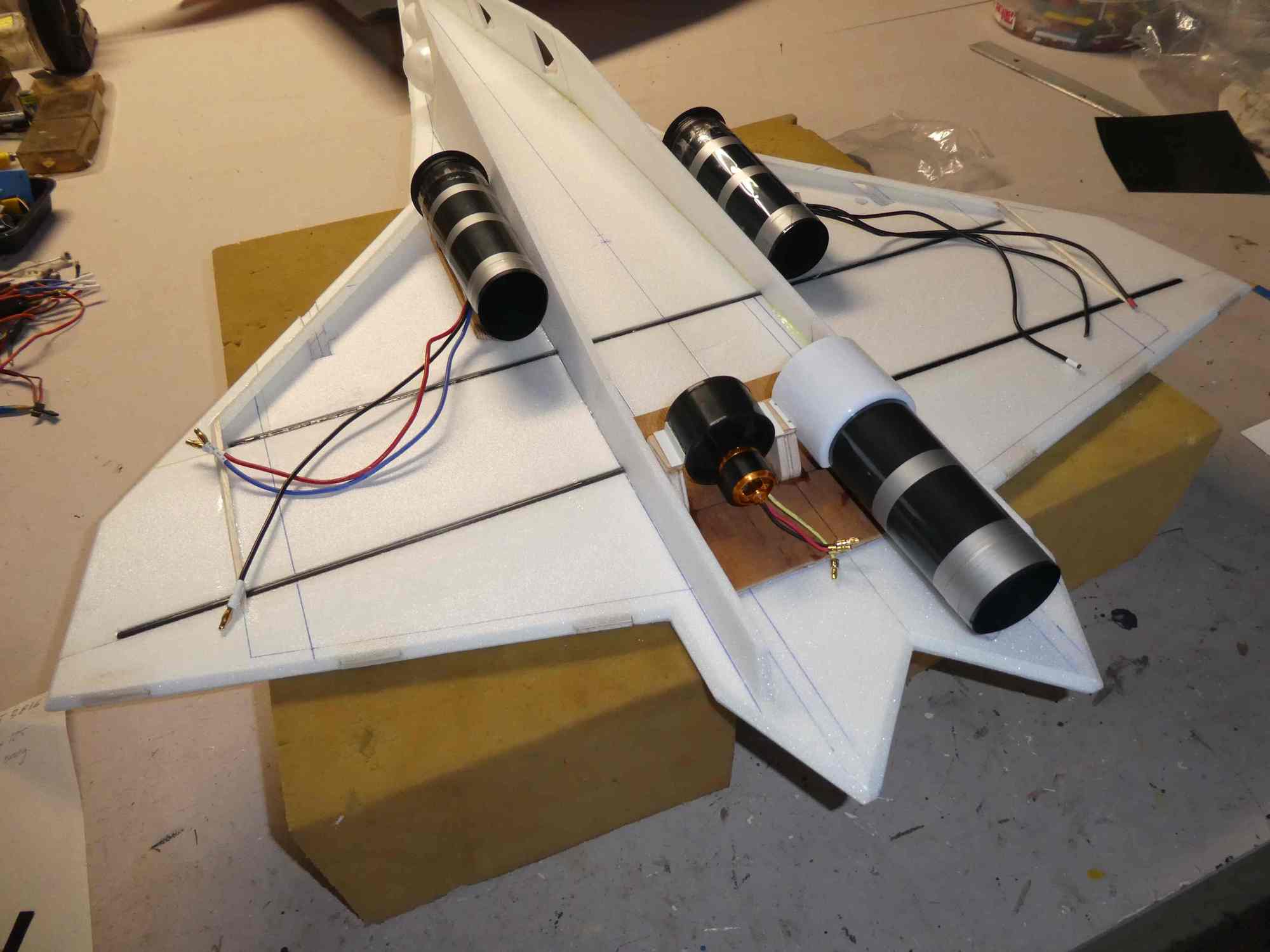

Mate, these days all you have to do is just a "click" with index finger, and you can find any info you are after on anything above. In my case, it's all about experience, building so many EDF models over the years with all the info in each model's log book.
Only few days ago started on 4 engine EDF jet build, the first thing I wanted to find out aprx. thrust of each unit, to give me an idea about the size of the air frame to cut out of Depron base.
I was rather conservative, making up the smaller frame before power units arrived.
Rather have more juice than not enough. Can't wait to hook it up to see what it pulls on the ground combined as "quadrosonic",
First check run gives me some idea about the thrust.
Circa-200 hour job in progress.
but after the first quick check run to see the current draw, I think I could have gone lot bigger.
(2B2 power unit check run)
