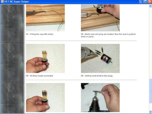

Not really sure what info HB will have with theirs. Our manual was done in a step by step and comes on a CD disc that has over 225 pictures on it. Each and every step was included in the build and is very complete. Or kits will also include the thrust tube stock and a military decal set for the white version. Credit does need to go to Carl who also did the build manual for the HET-RC Sniper AND FA-18 & Skyray for Markos and myself.

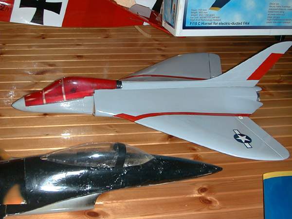

3S2P lipo 2100/2200 and mega 2 rurn is an excellent combo for the MF480.I have the same setup on a FA 18 and on a F4D, the 2 other arf from HET.
