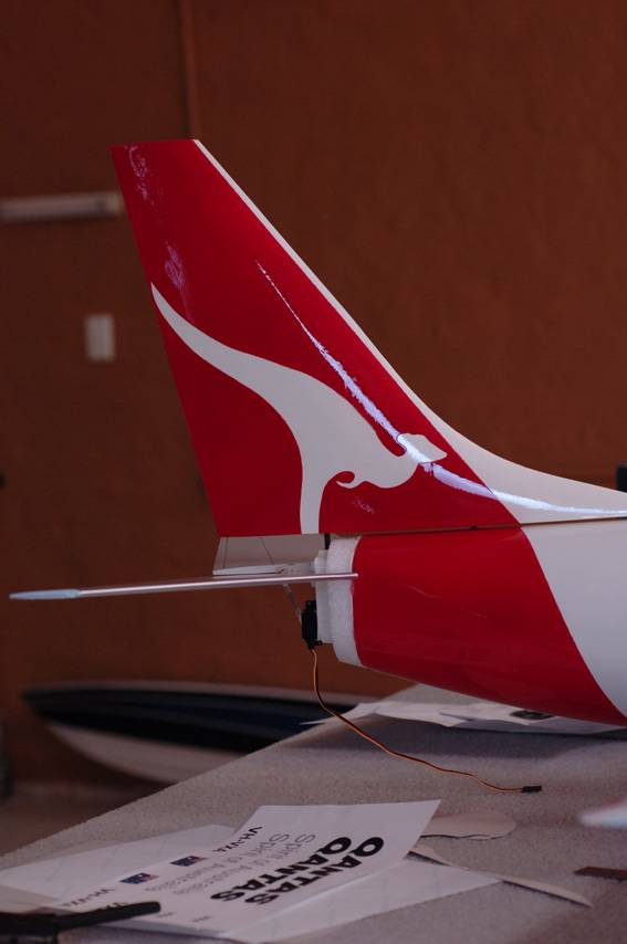

absolutely and with respect to another who has split the stabiliser to include elevators, I would not have it any other way. Pitch control is important and an all moving stabiliser provides smooth control. The other aspect is keeping it simple with a lesser of parts.
All the EDFmodel range use all moving stabilisers for this very reason.
Ian.
Ian.

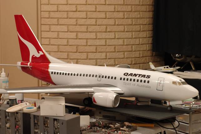

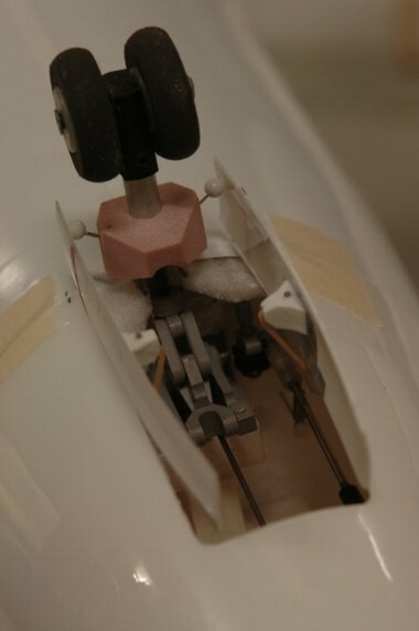

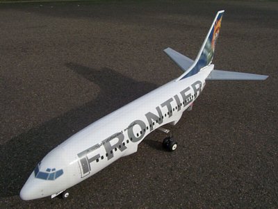

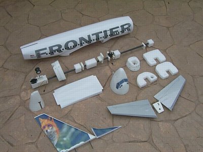

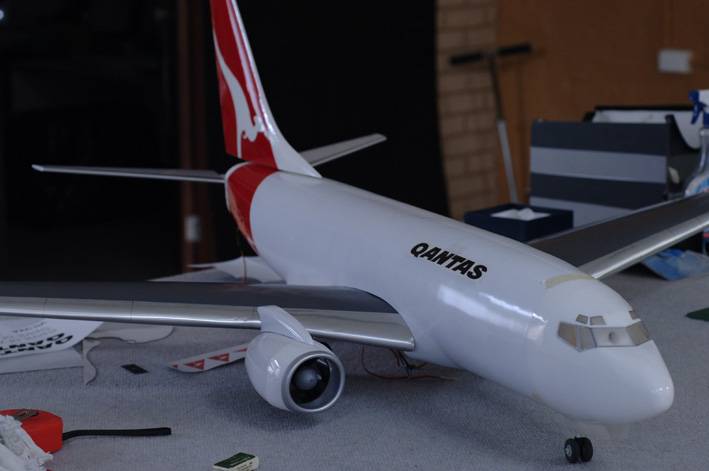

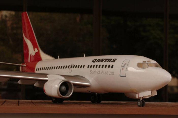

More progress on the 301 Frontier Airliner.
Some may not have seen our models before or understand EDFmodel’s building philosophy. The two photos perhaps give one insight.
Once the major subassemblies for the fuselage are complete they are then all assembled to produce the complete fuselage. No glues are used in bringing the sub assemblies together.
If a model suffers damage at the airfield there can be nothing more frustrating than cutting and re-gluing bits and pieces. A repair should not take so much time and effort that it destroys the modeller’s enthusiasm. My view is models should quickly come apart for inspection and part maintenance. Additionally, upon impact much energy can be dissipated before any serious damage is done because parts can ‘give’ a little. Nylon screws pop out for example.
The challenge is to actually fly the model and keep it flying.
My dislike of balsa comes about because of the need to start “butt-gluing†wood together forming rigid structures and ‘foamy’ type models tend to suffer that gradual hanger damage just putting them in the car. Another silly example is gluing landing gear legs to styrene wings in the hope they stay there on a rough landing.
I believe more energy in the model workshop should be directed toward developing better assembly technologies for the construction of electric models. One answer is designs that are modular which offer improved model impact resistance with ease of maintenance. Your model costs halve with every bad accident because generally you can repair the model.
I appreciate my views are not for everyone and so please no one take any offense.

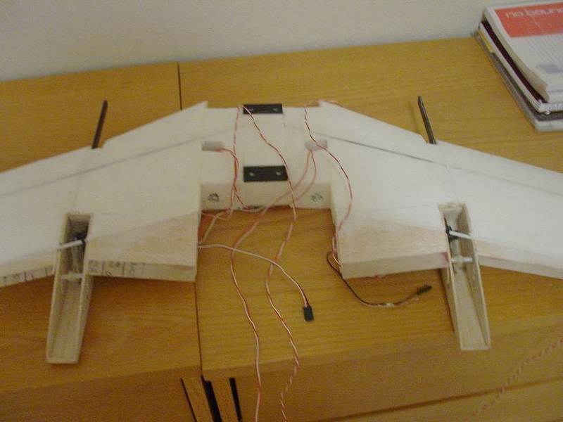

#69
Join Date: Apr 2004
Location: plano, TX
Posts: 40
RE: EDF Airliner build thread

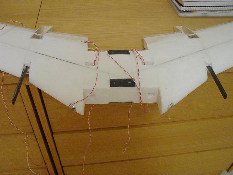

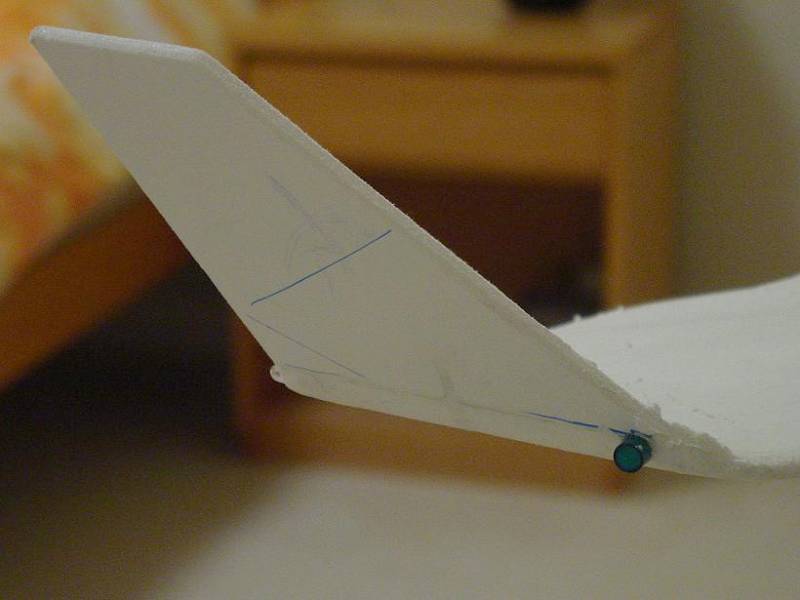

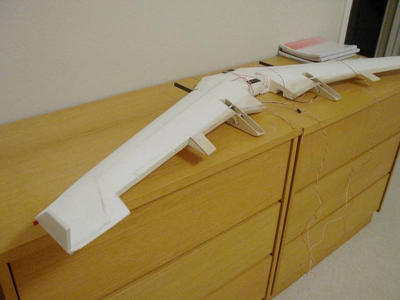

My 301 assembly is moving, yet very slowly. This weekend I have assembled the wing and the winglets. I have installed the navigational lights and the white strobes (facing back at the wingtip). Also the landing lights (halogen) have been installed. The lights have their own reflector and are focused forward but the cylindrical holes are also covered with chrome to enable the lights to illuminate sideways also.
Since I have extended the wing length, I thought I might as well shape the new wingtips, go thinner as I move towards the end, add a 105 degrees bend and blend it with the foam-board winglets. Of course the new section is reinforced but still flexible. The wires for lighting go through aluminum pipes which double as reinforcing struts inside the foam wing extensions.
A big part of the mid-section has been removed and the carbon plates have been re-shaped to make room for the retractable gears. Naturally the aluminum chassis for the gears can not be used, but a newly shaped aluminum part will be used.
Next is the assembly of the flaps, ailerons and applying the wing skins. I will use brushed chrome all through the wings (same material in the kit is for the leading edges of the wing). I have also experimented with real aluminum (kitchen wrap) and got outstanding realism. I used a special plastic spray (water based) which makes styrofoam solvent proof, which is essential if you want to use real aluminum. This requires extreme care (it is easy to wrinkle aluminum) and a lot of time, which I do not have. But if you like to learn more, please drop me an email at [email protected].
More to come...
Serdar
More to come...
Serdar
#70
Join Date: Aug 2004
Location: Queensland, , AUSTRALIA
Posts: 134
Serdar
Nice work. I can not wait to see the finished wing.
You said "The wires for lighting go through aluminum pipes which double as reinforcing struts inside the foam wing" -did you replace the carbon spar?
What sort of AWU are you aiming for ?
Ian.

Carbon spars are in there, aluminum is for the extended wing tips. I could have used brass (more flexible) but I needed lesser weight.
Serdar
Serdar

Mr Zimmermann of Perth has been busy again with his second 301.
He has added retracts.
I know others have some amazing models to show as well. Stay tuned.
Ian.
