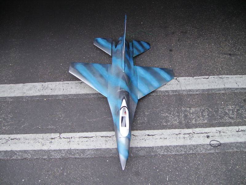

Hi there,
I just built mine stock and I am planning on building another one just for the fun of it. I want to follow up with you on your comment regarding the VASA Fan and the Jet screamer motor for a hopup. What Vasa fan and Motor are you saying is the best setup?
Thanks in advance!
Newman

Hello Newman, Its the Alfa fan model#alf 51031 I believe make sure you get the optional 3mm aluminum derill for rotor and the JSwith the adapter. Hope this helps............Tim http://www.rcgroups.com/forums/showthread.php?t=706277
new f-16 at hobby people .net - RC Groups,,,,,,, By the way great looking F-16. this thread i posted is just over 90 days old with almost 1100 replies. Information ......Oh Yeah[X(]

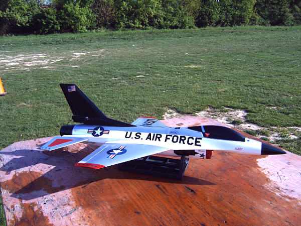

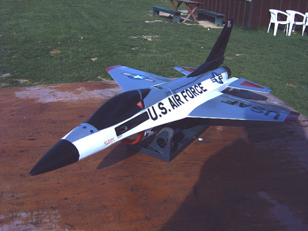

Here's mine with a few mod's. Took off the paper covering on wings and the did the whole jet in 1/2 oz glass with water based polyurethane it comes in at 20 oz without battery. Have 2-6 inch C/F rods in each wing going into the fuselage. Tail rods were covered with 1/8 lite ply and a rudder was added. I also have the wings setup for aileron's so if I want to add 2 more servo's down the road. Running the XF fan with the 5100 Kv 8XL motor on 4/S 2200 25C Air Thunder pack 40 amp ESC and 5/6v 3A UBEC. I am pulling about 30 amp's with 430+ watts and top speed is well over 100+mph. But now that I have about 50 or so flights on it it's getting too slow for me. I am thinking of re-powering it with a 480 fan with a 700 watt 2W-20 motor and 5/S pack. Damm!!!!! the need for speed has got me once more
Keep em flying
raido56/Herb

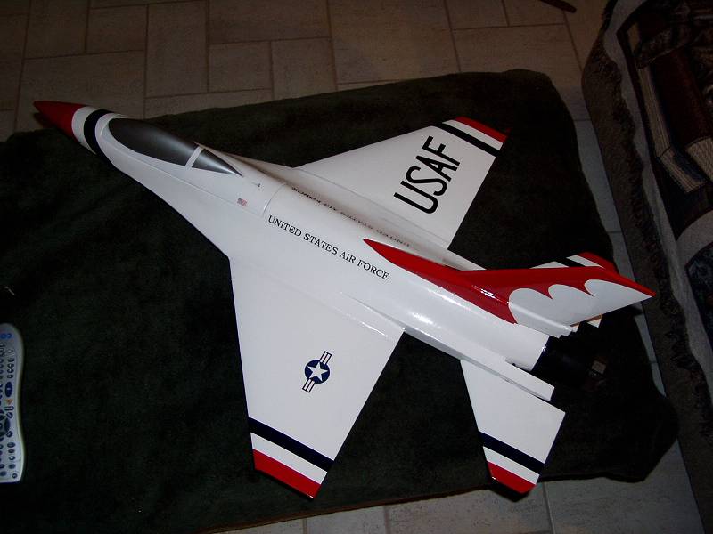

Here is my stock EF-16. I covered it in vinyl. It's a grand total of 22 oz with the battery. Flys like it's on rails.

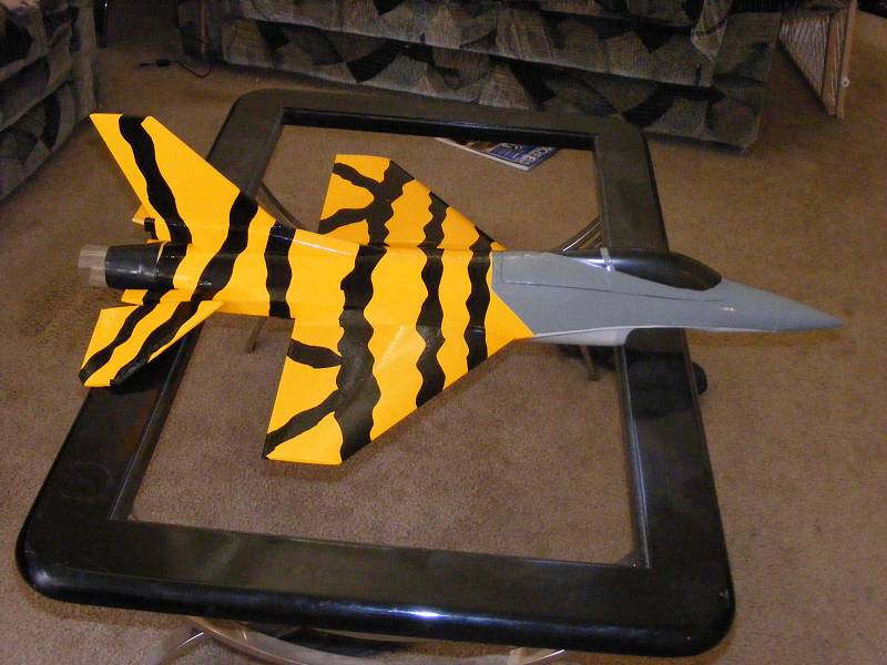

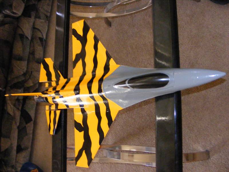

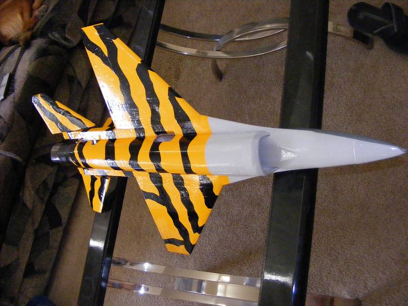

Here is my 1985 Tiger Meet F-16. Just as with Skyracer68 (who helped late one night last week to get the covering started ), this one is all stock aside from the speed control, which is a Castle 35. I didn't want to put on a smoke show with this one. The sign vinyl adds minimal weight and looks cool!

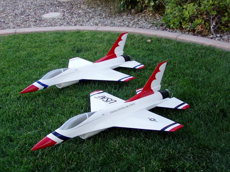

Double Trouble! The EF-16 is faster with a extreme TP 2200 Mah battery. I am running a CC Phoenix 35 though.
