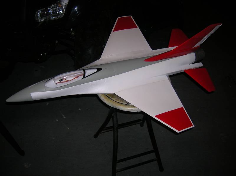

It is a blast to fly on the stock set-up.

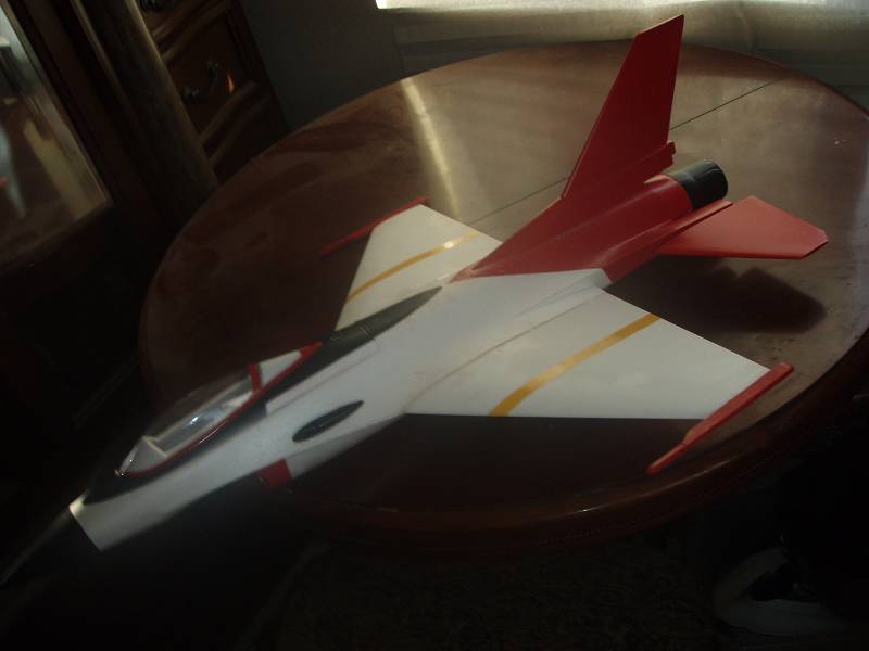

Here is a pic of mine flies great good product...
