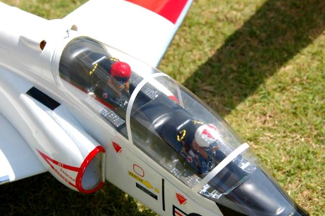

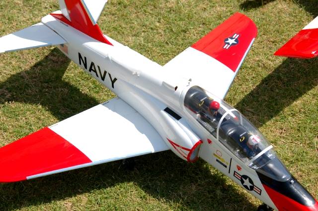

Default RE: SAPAC T-45 COMPOSITE GOSHAWK
HET makes some really nice ones and that is what I put in mine Here are a couple pic's of mine taken at SEFF

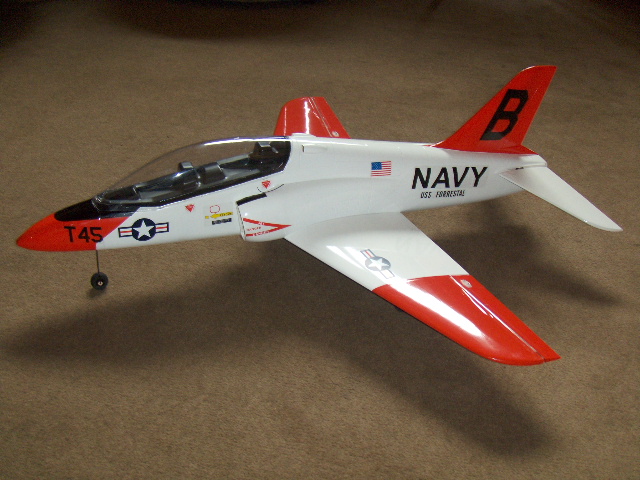

mine flys great 4cell missle

rvincent,
What scale and where did you find the pilots for your HAWK.
keith
Old 08-19-2008 | 05:10 PM
Joined: Dec 2005
Posts: 215
From: tehachapi, CA
Guys it's been awhile since i have posted here .just about ready to reattempt the madien flight on my T-45 .my set up is silver motor (long) with a turingy 80 amp esc PQ 4350 4s batt HET retracts and Air sally intake ducts. AUW is a porky 4 1/2 pounds. if any one is interested in a set of my custom complete ducting sytem i can be reached by e-mail at [email protected]
PS myersflyer the pilots are 1:12 scale Boomer 52 pilots he can be reached in the rc groups pusher thread...also Jet Hanger hobbies sell a version of them...hope Bob does'nt mind me answering for him,just wanted to help you out.
