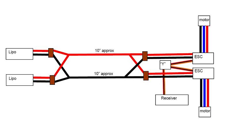

Hi Everyone,
I am putting together the Executive Jet at the moment.
Without starting a debate! (I have read every forum I could find on this topic), what is the best option regarding the BEC's.
1. Is it ok to have them both providing power to the receiver, or should I remove one of the red wires from one of the ESC connectors?
2. What gauge wire should I use between the ESC and the Batteries (I will connect them in Parrallel so I only have 2 wires from the ESC to Batteries). I.e I will make a harness so I can connect two deans connectors to the two wires, then at the other end, create another harness that the two ESC's can plug into completing the parrallel setup. See Pic. Deans connectors.
The ESC's will be located at the rear of the aircraft between the engines (near the cooling exit), and the batteries up the front (around 10" away) at the battery hatch.
The setup is:
ESC: 2 x Mystery 30A
Motor: 2 x Mystery 4000 Kv
Batt: 2 x Force 11.1V 3S 2200mah 20C

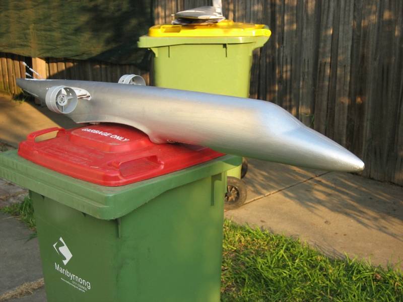

Some photos attached - I am painting it like a lear I used to fly.

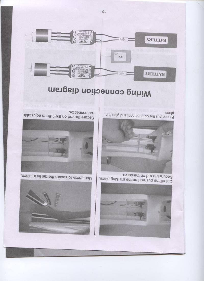

Because you will want to charge the batteries separately, you may want to consider just wiring the ESC power leads to one Dean's male connector, put a Dean's female on each of the batteries, and construct a parallel wiring harness to connect the batteries togther (two male connectors) running to a single female connector. I believe using a Wye servo lead for the two ESCs would be fine. It's how I've wired my upgraded SU-27 and followed the directions that extremeRC.com provided.
I am puttin the same jet together right now and I will send you the diagram, you should have the same one. It is very simple wire set up. The one y servo wire goes to the RX and the two ESC and then the other y wire goes to the servos for the flaps. I hope this helps.

No luck actually - I ended up going down the path of filling the weave using RedDevil Lightweight spackle (this is a waterbased product used for filling cracks in plaster). A huge tub of it weighs nothing. I mixed it in a small bucket with water so it was like paint, then brushed it on - then sanded.
I will prime next with Acrylic Lacquer High Build primer from SuperCheap (I think it is pentone brand - something like that). I have not gotten around to it yet as it is cold here now, and the investment in a compressor is a larger one that i thought.

Tasesq: sounds like you bought the gear from eflypower, the ESC's are pretty cheap, I would not be using them in parallel BEC wise, in fact I would not be using the BEC in them at all! I would fit an external UBEC, a good one that is fully shielded, that plane needs good power supply for the radio gear.
