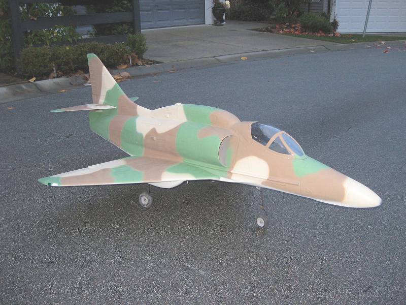

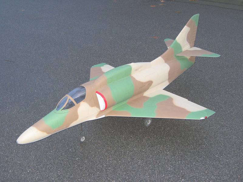

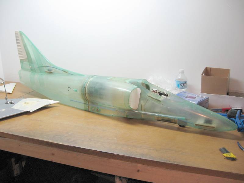

Here is my Byron A-4 conversion to EDF.
It started life as the glow version - but after some time in the rafters I continued building it as an EDF. Stock Byron fan converted to EDF with a Hacker motor, CC HV85 esc and 2 5S 5000mAh Flightpower batteries. Weight will be about 12 lbs. Paint is Testors model master military colors in the correct FS colors for the IAF.

A few more pics.......Radio is a JR XP 9303 2.4

Last ones for a while. I'm off to warm sunny places!
I'm going to finish the wings then add some small scale details and highlight the panel lines after my vacation. The power system puts out equal power to an OS 91 setup - about 12 lbs thrust.

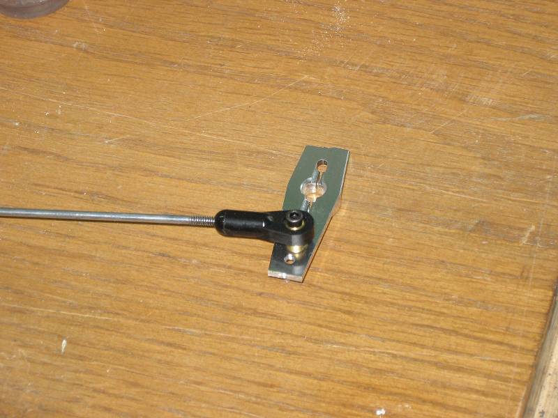

Looks good, one thing I realy sugest is not using the nirod control linkages , my a4 and f16 both had stab and aileron flutter .Some of the flutter was cured by some lead in the leading edge of the stab close to the root but the final fix was to move the servos close to the aileron and stab control links and use 4/40 hardware to connect. I kept the linkages as short as posible and ended up with a whole new animal as far as solid control of the plane, and at 135 mph 4ft off the deck you definitly don't want flutter or sloppy control surfaces, just my thoughts.

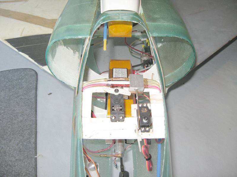

Old 10-24-2008 | 09:25 AM
Joined: Jun 2002
Posts: 817
From: Langley, BC, CANADA
Default RE: Byron A-4 Skyhawk EDF conversion

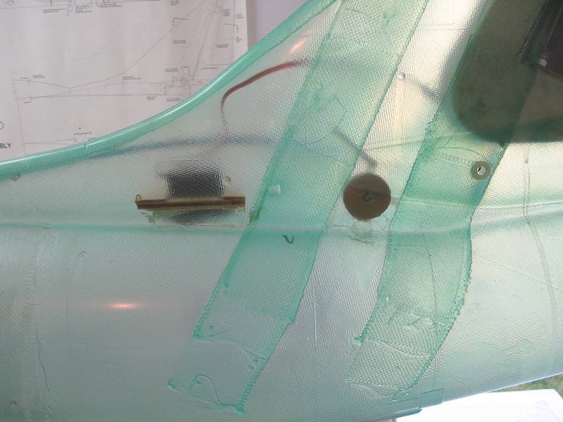

Thanks f16 man............way ahead of you though.
I had made a mount for the elevator servo in the dorsal fin and it's all bolted together with 4-40 hardware and aluminum control horns.

Old 10-25-2008 | 08:21 AM
Joined: Nov 2005
Posts: 1,264
From: MANTECA, CA
Nice job on that control, I also had to add an oz of lead to the leading edge of the stabs cause at wot in a dive I would get just a hint of flutter, mine would fly at about 155 mph with a os 77 on steroids he he he , your electro will be faster yet Ill bet.

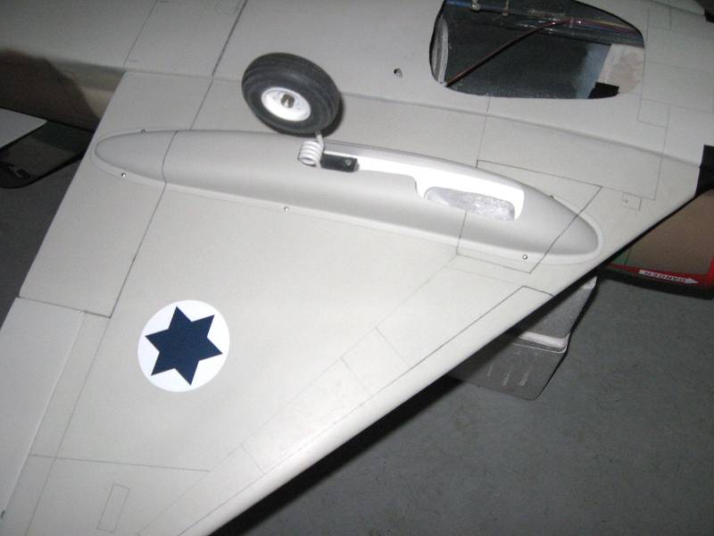

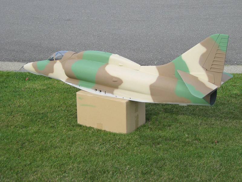

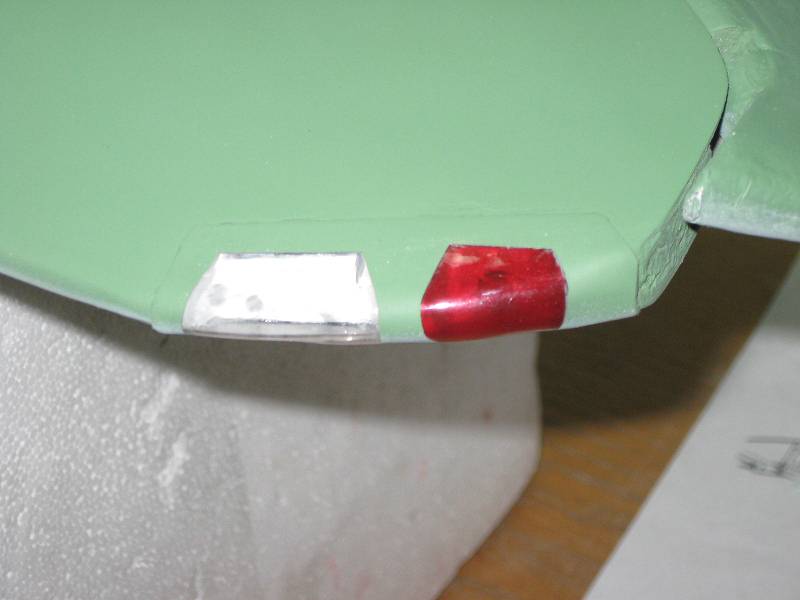

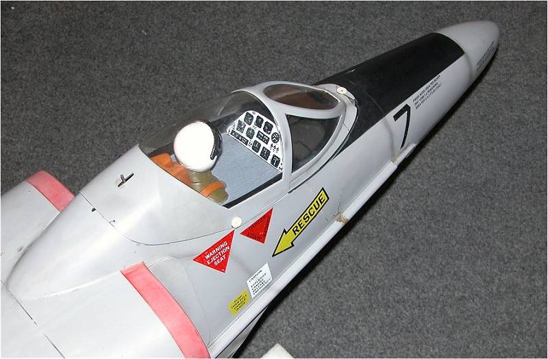

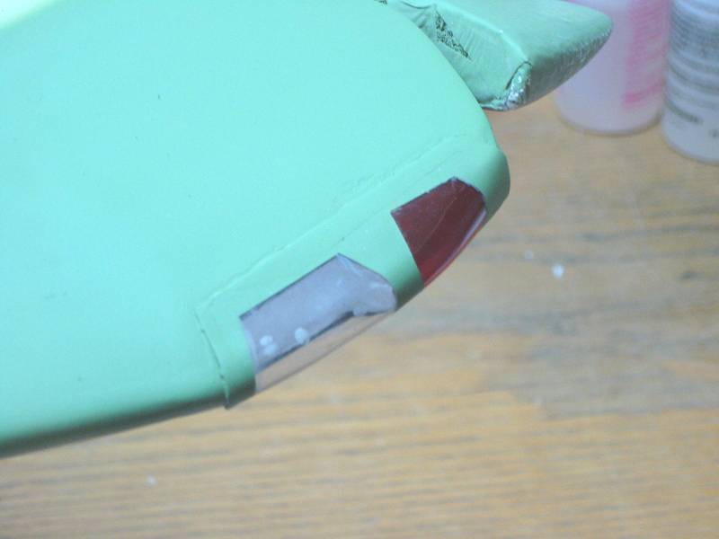

More work and paint done.
I made nav and strobe lenses for the wings and I've painted then tried my hand at panel lines and simple weathering. Needs a little more work and some markings yet.

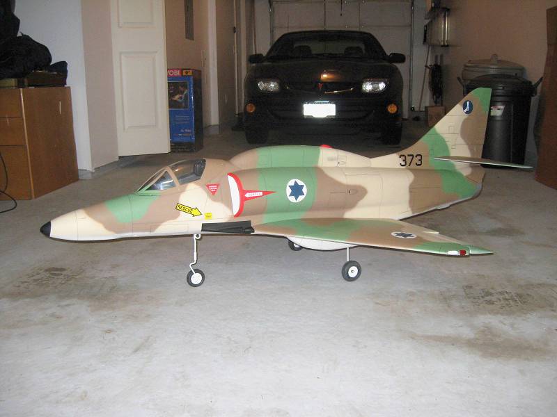

Been pluggin away at this and am almost finished the panel lines. A little more detailing is required yet.
I'm thinking of adding a working rotating beacon to the top of the avionics hump and adding a second rx battery for good measure.

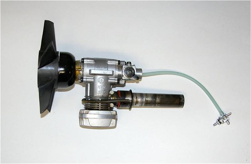

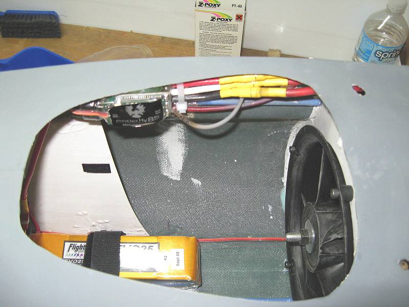

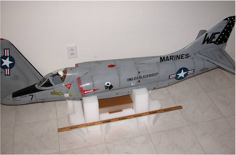

My Byron A-4 Skyhawk arrived and is ready for the first stages of its conversion from GDF to EDF. The plane is owned by Lynn Bowerman who has done test flying for me on many projects. We plan to work together on the conversion and fly it this summer.
The plane is in good shape but will require some minor repair and upgrades. All the servos will be replaced with JR DS-821 Digital Sport Servos. The 72MHz receiver will be replaced with a Spektrum AR7000 2.4GHz dual receiver. The nose gear will get a Robart strut upgrade and the exhaust tube will be replaced.
The power system with be an [link=http://www.jethangar.com/]E-Turbax[/link] ducted fan unit from Jet Hangar Hobbies. It will be powered by a Neu [link=http://www.castlecreations.com/products/neumotors/nm1500.html]1527/1.5Y[/link] motor, [link=http://www.castlecreations.com/]Castle Creations[/link] HV110 ESC, and two 6s Flightpower [link=http://www3.towerhobbies.com/cgi-bin/wti0001p?&I=LXWPB8&P=7]EVO25 5AH[/link] LiPo packs.
Next up, OS .91 engine removal.

Terry,
Thanks for the suggestion. I am familiar with the EJF Byron conversion but did not choose that method because I already had the E-turbax unit. I was looking for a host plane for the E-Turbax and stumbled across a free partnership project with one of my test pilots so it was a convenient and very low cost find.
The Byron conversion using the Scorpion 4035-630 motor on a 12 LiPo produces about 3600 watts but the E-turbax with the Neu 1527/1.5Y motor on a 12s LiPo produces about 4500 watts. The Neu inrunner motor, at about twice the cost, is much more efficient than the Scorpion outrunner motor.
Skyhawk,
After I read your post, I decided to try the link using MSIE 7 instead of Firefox and it worked fine. They may already be aware of it but I'll let them know their site has issues with the Firefox 3.0.5 browser.
It's good to know that I may be able to buy some parts for the A-4 like a new canopy.

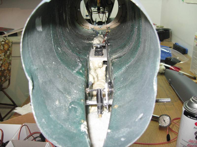

Greg,
Are you going to add ducting and eliminate the cheater hole? The Turbax fan is smaller than the 6" Byron so the intake may have enough area(?)
Sean
Old 12-30-2008 | 08:19 AM
Greg Covey's Avatar
Joined: May 2003
Posts: 5,710
From: Rochester, NY
f16man,
If that slimy engine was mine, I would send it to you for the cost of shipping.
I removed the O.S. .91 engine. It weighed 24oz (1-1/2lbs) with the fan attached. I can't seem to angle the tuned pipe enough to remove it so the fan unit may have to come out first.
Sean,
I was looking at the giant holes and thinking the same thing. I haven't measured anything yet but my instinct tells me that the cheater opening can at least be reduced. The GDF design of these old Byron models makes them a great host for an EDF conversion.

I've been busy with work, hoildays and a family illness, but I'm finally nearing the end. The paint and panel lines are done, as are the decals and clearcoat. The pilot is on backorder and the aileron pushrods need one more support each. The rudder has been pinned. I will re-install all the equipment this week and try to finish the cockpit.
This has been my first try at panel lines and I think it turned out alright.
