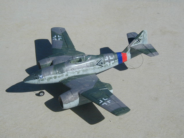

PS..here's a GWS Me-262 that I'm flying now...

i like your gws 262 carnt say i know much on these but i think you paint them ? if you have it looks great. one of our club members has alot of the gws stuff but i have not taken too much notice . i will post someting on the het when i get going on it but have a few projets on the go to get completed first. GOOD LUCK ON YOUR BUILD ASWELL
