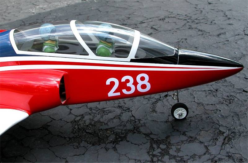

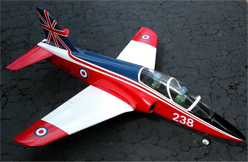

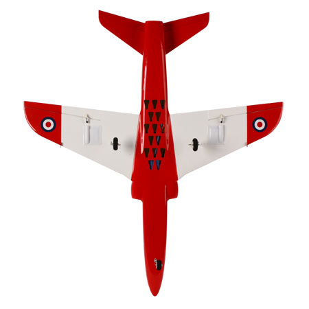

E-flite’s [link=http://www.horizonhobby.com/Products/Default.aspx?ProdID=EFL8025]BAe Hawk 15 DF ARF[/link] is a sport scale version of the trainer and light combat aircraft for use by the British Royal Air Force. This R/C model is constructed of fiberglass and balsa, the fuselage is beautifully prefinished with scale details. The British Aerospace (BAe) Hawk boasts the rare and very visible Central Flying School airshow trim scheme from 1987 in red, white and blue.
This exciting R/C model was designed around E-flite’s [link=http://www.horizonhobby.com/Products/Default.aspx?ProdID=EFLDF15]Delta V 15[/link] (69mm) fan unit and matched [link=http://www.horizonhobby.com/Products/Default.aspx?ProdID=EFLM3015DF]BL 15 DF[/link] brushless motor. Pilots can use a 3-cell LiPo battery pack or utilize a 4-cell LiPo battery pack for increased vertical performance. The built-in fan mounts make installing the fan easy—just drop in the fan unit and tighten four screws. The removable front hatch also allows easy access to the radio equipment and battery. The entire trim scheme is pre-painted, pre-trimmed, the wings are covered in UltraCote and all the decals have already been applied. Created for the advanced sport scale pilot, the BAe Hawk 15 DF ARF easily lives up to its reputation of being a stable flying jet.
Key Features:[ul][*] Molded fiberglass fuselage and built-up balsa wing construction[*] Pre-finished scale trim scheme of Central Flying School RAF BAe Hawk[*] Designed to fit the E-flite® Delta-V 15 EDF unit and BL15 DF Brushless Motor[*] Built-in fan mounts[*] Pre-assembled quick access cockpit hatch[*] Removable landing gear[*] Concealed elevator linkages[*] Optional pilot figures sold separately
[/ul]Specifications:[ul][*] Wingspan:33.3 in (845mm)[*] Overall Length:35.4 in (900mm)[*] Wing Area:206 sq in (13.2 sq dm)[*] Flying Weight:43–46 oz (1219–1304 g)[*] Motor Size:15 DF brushless motor[*] Radio:4+ channels[*] Servos:Sub Micro (3 required, 4 with nose gear steering)[*] Speed Control :60-amp brushless[*] Recommended Battery:3S 11.1V 3000-3300mAh Li-Po[*] Landing Gear:Optional use, included
[/ul]

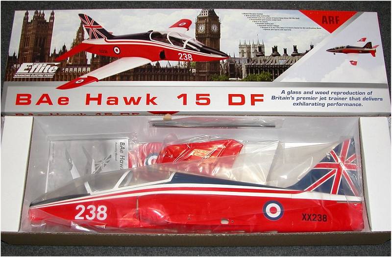

There are very few parts in the Hawk box so it looks to be a quick build. All the parts were sealed in plastic and well protected for shipment. The 36-page manual is loaded with clear photos and instructions to help insure a successful build.
What impressed me the most here was the quality of the fiberglass fuselage and sheeted wing covering. It was flawless! The detailing on this EDF model is fantastic!

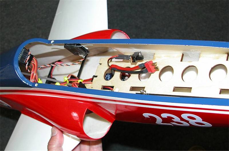

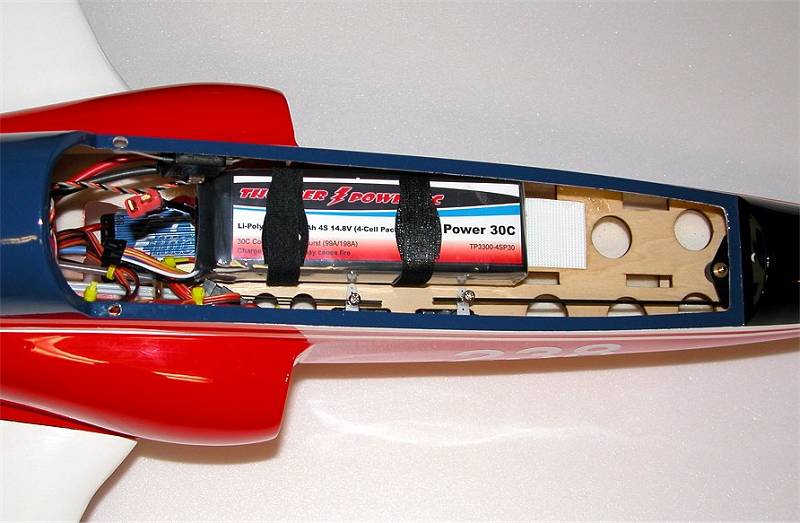

A closer look at the fuselage reveals an easily removed hatch for access to all radio equipment and battery. A side access hatch allows easy removal of motor and fan unit. The pre-painted vertical fin gives added details in appearance without using decals.
The BAe Hawk’s high-quality fiberglass fuselage provides strength and durability while the painted finish resists dents and dings. Note the "cheater" holes on the fuselage bottom to allow more air into the ducted fan for increased thrust on take-offs. This allows the Hawk to retain a very scale look!

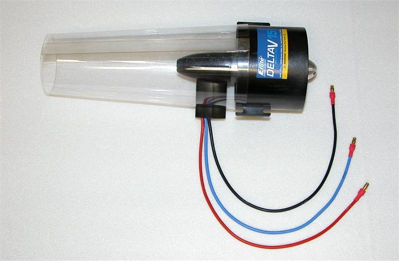

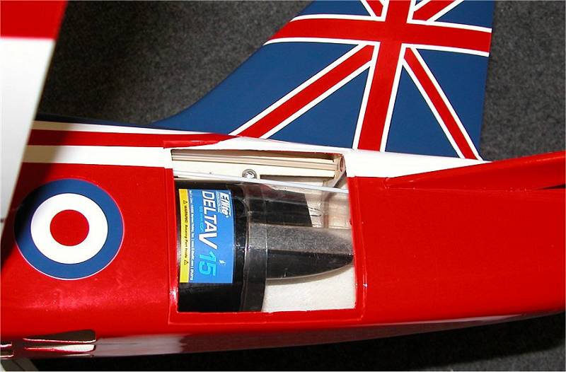

The recommended components for the EDF power system are as follows. I will also be testing the BAe Hawk with a 4s LiPo pack.
[ul][*] E-flite [link=http://www.horizonhobby.com/Products/Default.aspx?ProdID=EFLDF15]Delta-V 15[/link] 69mm EDF[*] E-flite [link=http://www.horizonhobby.com/Products/Default.aspx?ProdID=EFLM3015DF]BL 15[/link] Ducted Fan Motor[*] E-flite [link=http://www.horizonhobby.com/Products/Default.aspx?ProdID=EFLA1060]60-amp Pro[/link] Brushless ESC[*] E-flite [link=http://www.horizonhobby.com/Products/Default.aspx?ProdID=EFLB32003S]3200mAh 3s 11.1V 20C[/link] Lipo Pack
[/ul]
The assembly starts by attaching the center body fairing to the motor and then the motor to the DF unit. Note the longer length of the BL 15 ducted fan motor wires to make the installation easier. The center body fairing helps reduce drag.
The factory-balanced 5-blade rotor is installed after first pressing the collet adapter onto the motor shaft. It is then secured in place by the aluminum spinner. I used an L-wrench (or hex wrench) to help tighten it properly.
The overall design of this 70mm EDF unit is the best I have seen to date. The longer motor wires, balanced rotor, pre-soldered motor connectors, and center body fairing are all excellent design details by E-flite.

After the EDF unit has been assembled, a hole is cut in the thrust tube to allow the motor wires and center body fairing to exit.

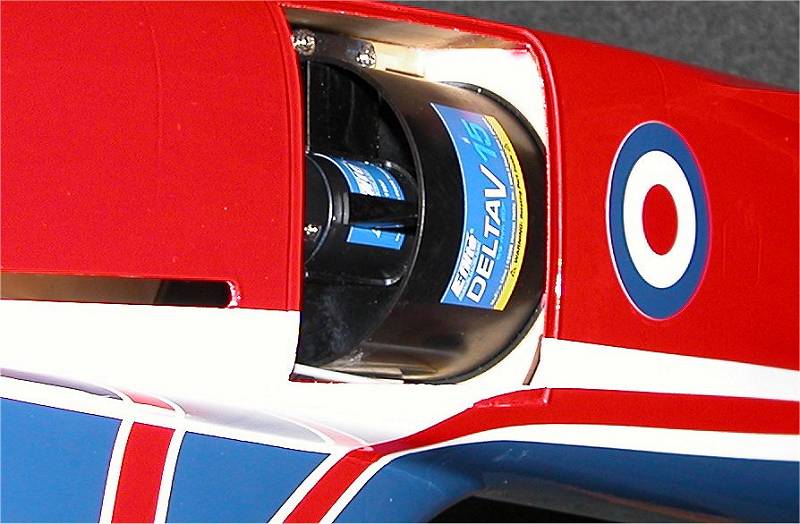

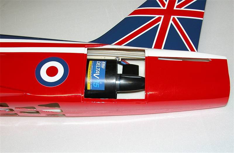

I ran into my first issue when installing the EDF unit into the fuselage. I could not get the DF unit to properly align in the pre-mounted fan intake. It appeared that my bottom plywood runner was pre-glued in the wrong spot. Since the plywood runner was securely glued in place, my fix here was to place the top mounting flange on the opposite side. It was then held in place with a screw, washers, nut, and some Loctite.
The important part of this assembly is to be sure that the DF unit sits flush into the pre-mounted fan intake.

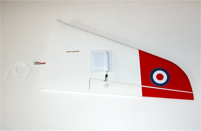

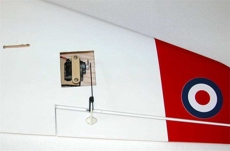

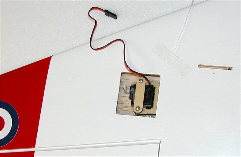

The aileron servos installed in the wing halves without issue. The S-75 servos are held in place by a well-designed mount and the pre-run string provided for easy routing of the servo control cable. The control rods, horns, and keepers were all supplied. A plastic cover is then trimmed to size and secured with the supplied tape. The top side of the wing does not show any holes from the control horn.

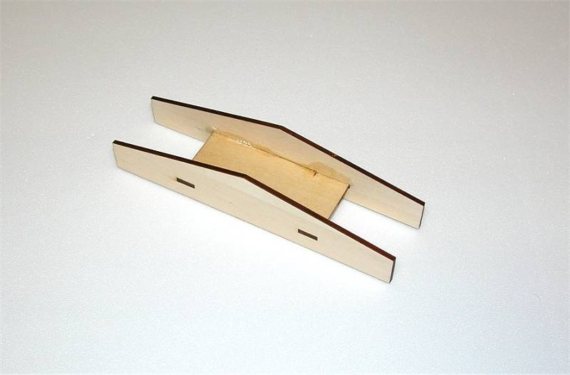

The BAe Hawk comes with a plywood jig that is first CA'ed together and then used to hold the stabilizer halves at the proper anhedral angle when gluing them together with 5-minute epoxy. The stabilizer assembly is then properly positioned in place, measured, and marked. The top and bottom side covering is removed where it resides inside the fuselage. The stabilizer is then CA'ed in place from the tail opening.

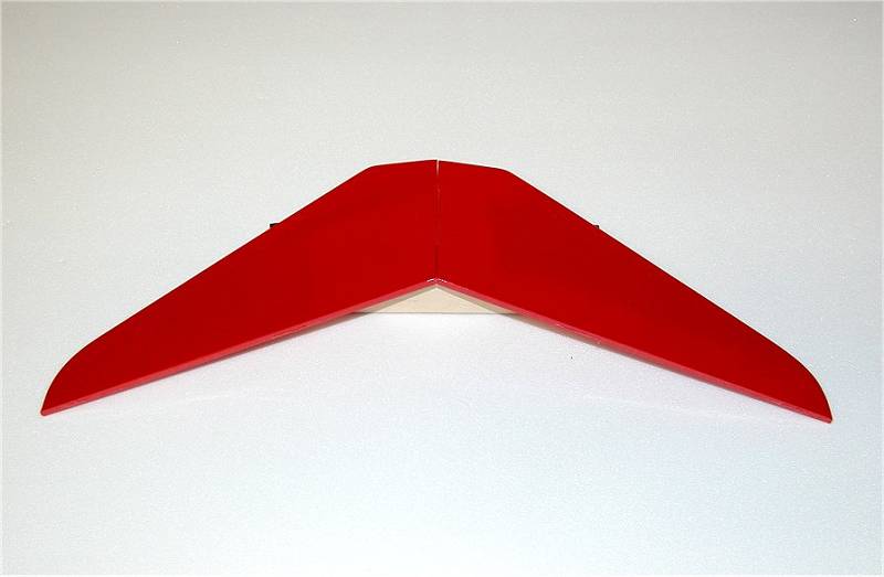

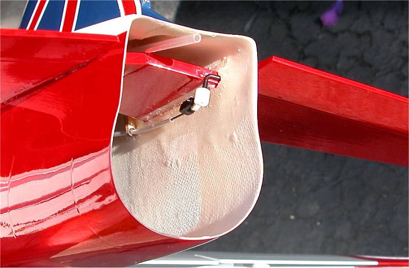

The elevator installation starts with gluing the pre-bent control wires into the elevator halves using 5-minute epoxy. The two elevator halves are then CA'ed to the stabilizer via pre-cut hinge material pieces.
The elevator control and linkage is designed to provide a clean look on the outside of the Hawk. The control horns and keepers installed with minimal effort.

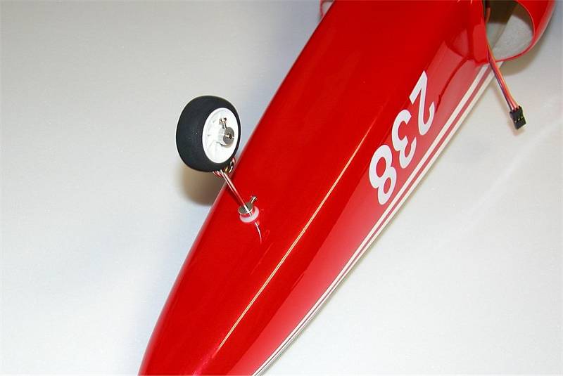

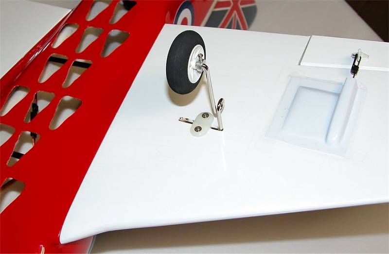

The landing gear installed easily but I noticed some minor issues. The kit came with 2mm x 8mm machine screws for the wheel collars instead of shorter Allen head screws so they stick out a bit. The flat spots on the gear metal rods where all facing downward so I just went with it. Typically, I install my wheel collars with the screw facing aft to minimize any grass snagging and provide a cleaner look from the front view.
These minor issues can be easily fixed, if desired, by obtaining some 2mm x 4mm set screws and using a Dremel tool to create a new flat spot.

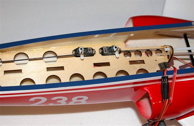

The elevator and steering servos were installed at the same time using the same technique with pushrod connectors. The two smaller elevator half control rods are controlled by a single servo as is the larger steering control rod. The manual provides exact details for which servo arm and hole to use.

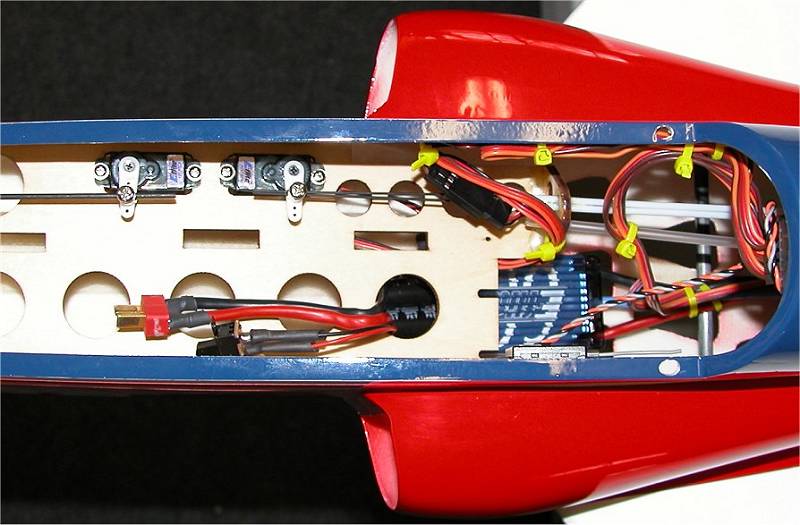

The E-flite 60-amp Pro Brushless ESC and Spektrum AR6200 receivers were installed per the manual without issue. Note that all the loose wires are wrapped to keep them from flapping in the air flow. It is important to secure the wires in a way that still allows the ESC and receivers to be removed from the hook-n-loop material, if needed.
Not shown in the photos are the motor/ESC wires that I secured to the carbon tubes inside the fuselage.

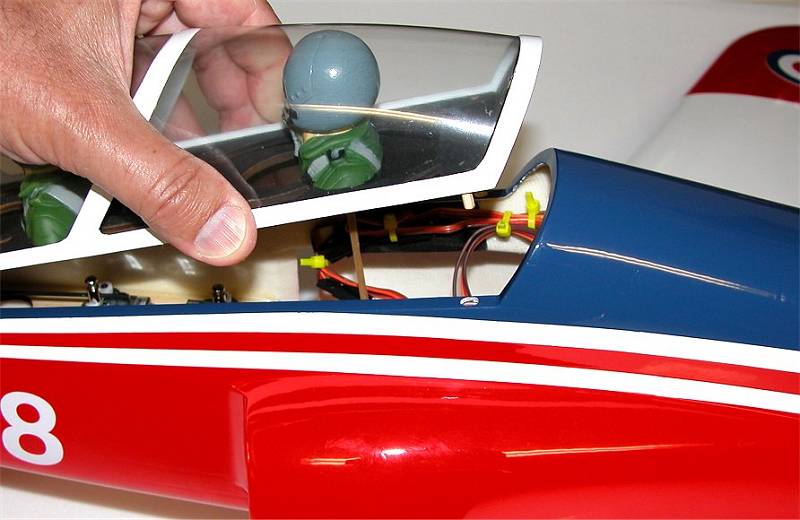

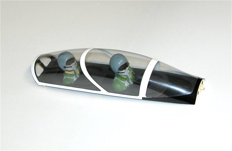

On a model this nice, adding pilots should be an option that you don't leave out. Fortunately, Horizon offers their ParkZone [link=http://www.horizonhobby.com/Products/Default.aspx?ProdID=PKZ4414]T-28 Pilot[/link] that can be cut down to fit inside the Hawk canopy. The canopy is held in place using supplied eye ring screws, a rubber band, and a hook made from cut-off control rod.

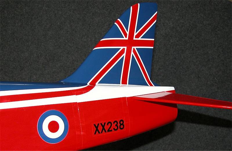

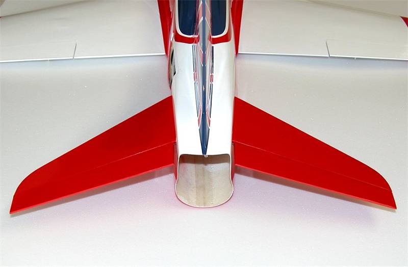

I added some black sticky-back covering to block the holes in the canopy bottom. My BAe Hawk is starting to look almost complete!

The thrust tube is installed through the tail opening and then taped in place along the DF and at the tail. I also added some Zap-A-Dap-A-Goo II (or plumbers Goop) to the area around the center body fairing to keep the air from escaping around the cutout.
Once the thrust tube is installed, the rear hatch is taped in place on all four sides.

The 3-cell E-flite 3200mAh pack and 4-cell ThunderPower Pro Power 30C 3300mAh pack are shown in their positions to obtain the balance recommended in the manual. For less than a 3oz weight penalty, and some additional cost, you can more than double your power by using a 4-cell pack. This upgrade should really make the BAe Hawk perform well.
Since the E-flite 60-amp Pro Brushless ESC has a fail-safe switch design, I find it easiest on these smaller models to simply cut off the switch and get it out of the way. I cut one wire slightly shorter and then cover the ends with a small piece of shrink tubing.
I measured the power level of each pack as follows. The E-flite 60-amp Pro Brushless ESC can handle 75-amps peak so it will still be within specs on your high-speed passes at full throttle.[ul][*] 3-cell pack, 360 watts, 36 amps[*] 4-cell pack, 900 watts, 64 amps[/ul]
