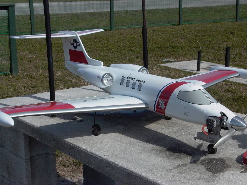

Here are some shots of the last build at the club. He built an old kit and glassed and painted. Wish he would have gone with fans!
