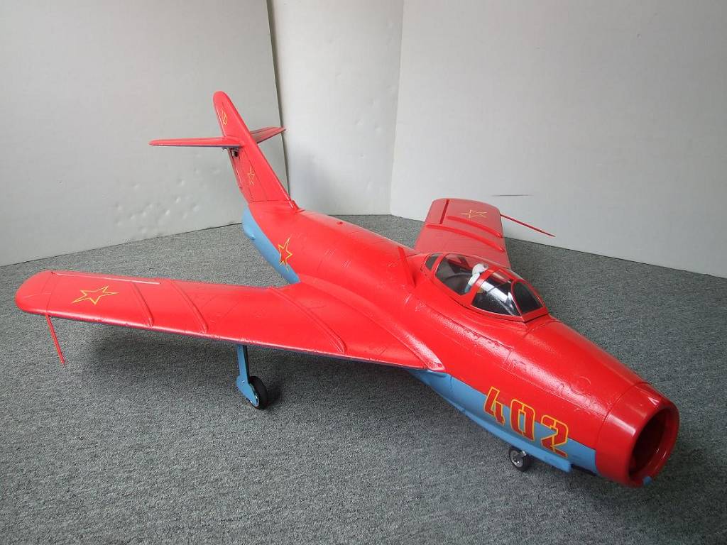

<span style="font-size: x-large"> "RUSSIAN RED" PC MIG - 17

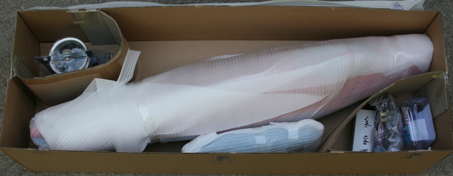

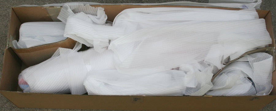

The Mig arrived from China in a strong double packed carton and the actual model box was
divided into custom sections which held the individual parts covered with white sheet foam
and packed in individual plastic bags. The bags were all taped in place to avoid any movement
during shipping.

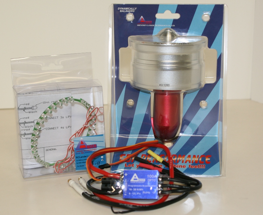

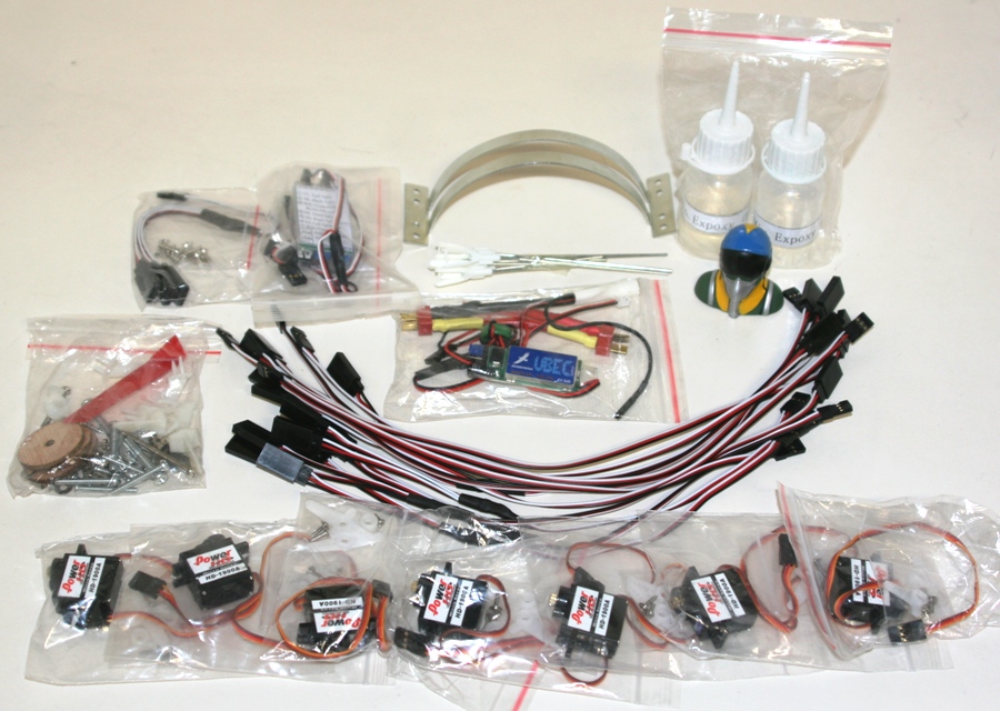

My Mig came with most of the available options, outlined in post #1 and I plan to add a Spektrum
AR 7000 receiver and use my DX-7.

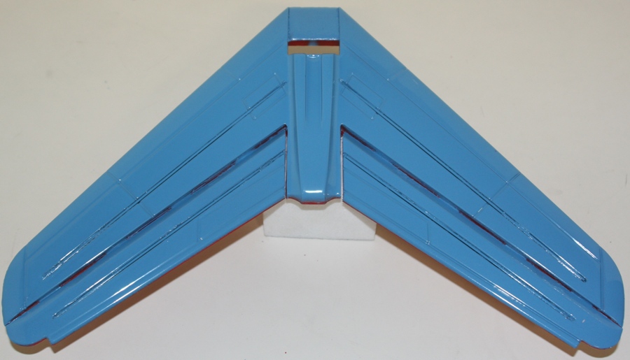

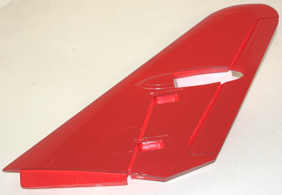

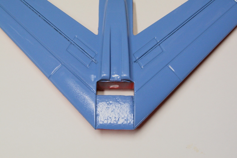

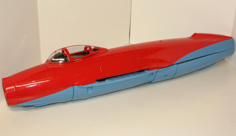

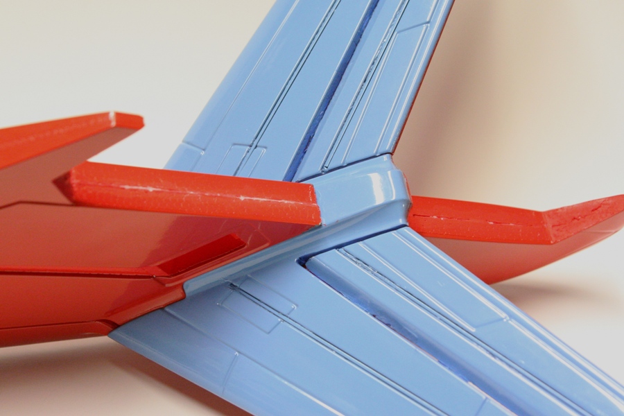

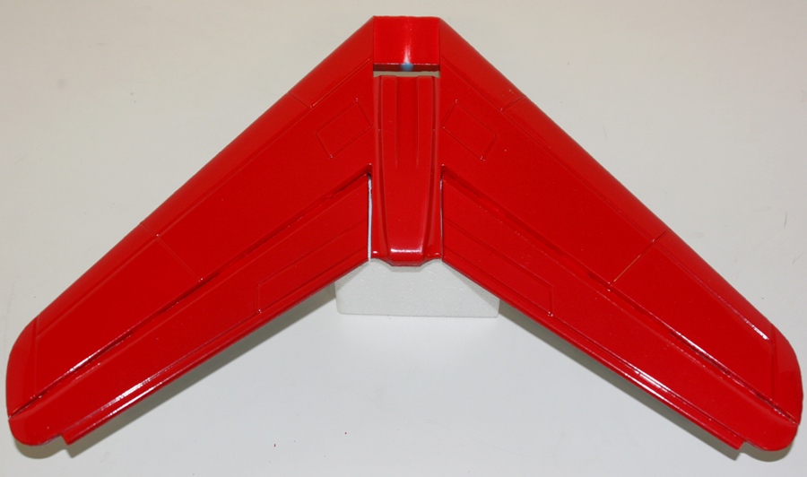

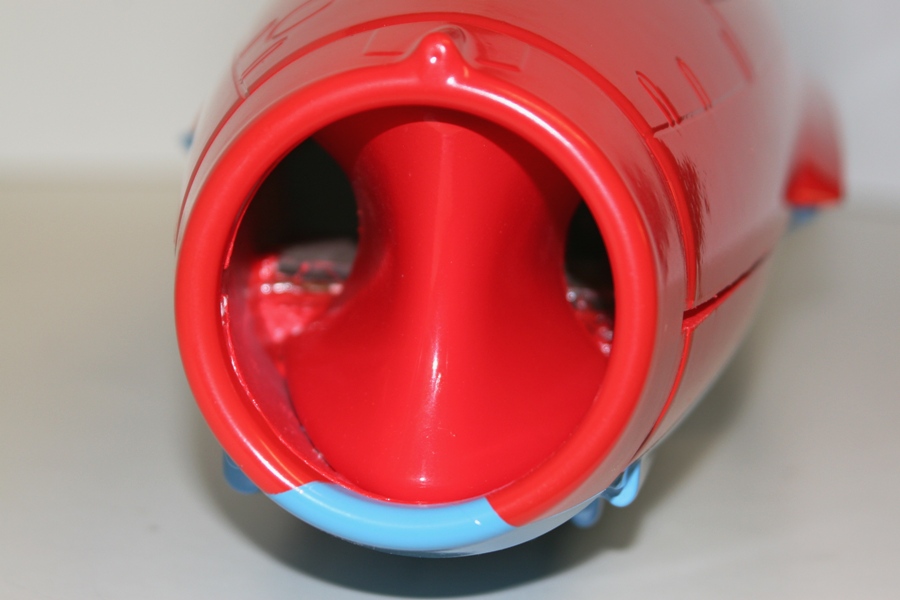

The actual parts count is low and made up of the following; upper fuselage, four part lower
fuselage, horizontal stabilizer (elevator), verticle stabilizer (rudder), canopy,intake nose cone
and wing tanks.

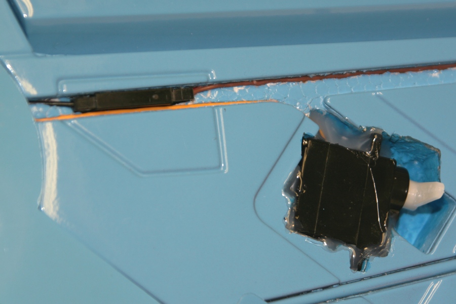

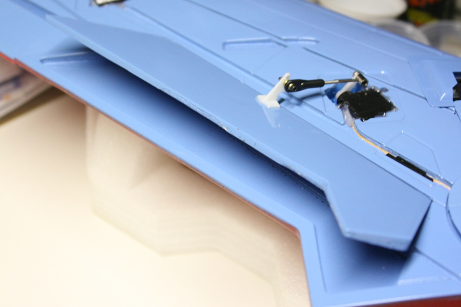

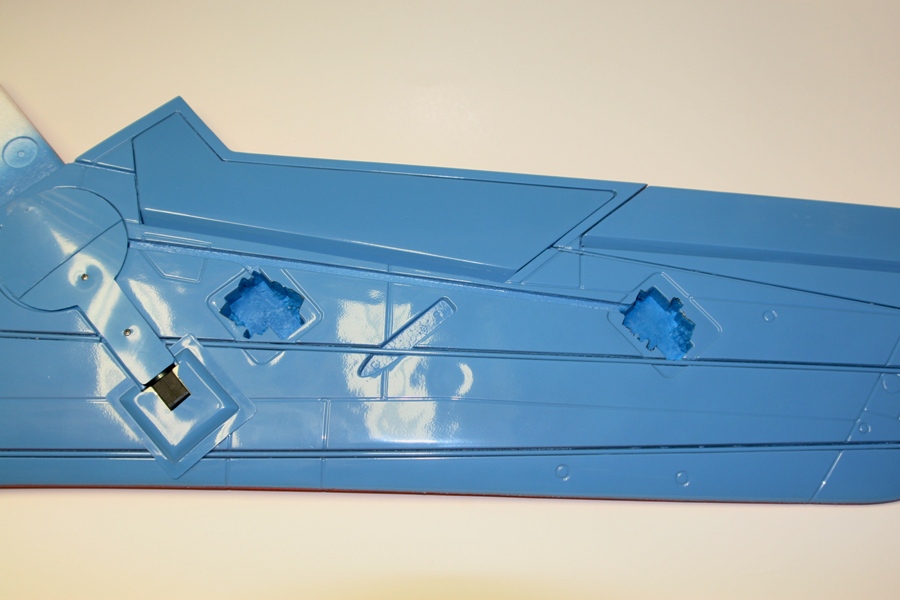

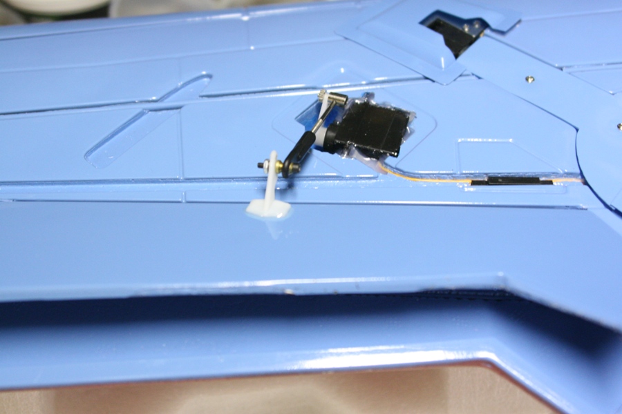

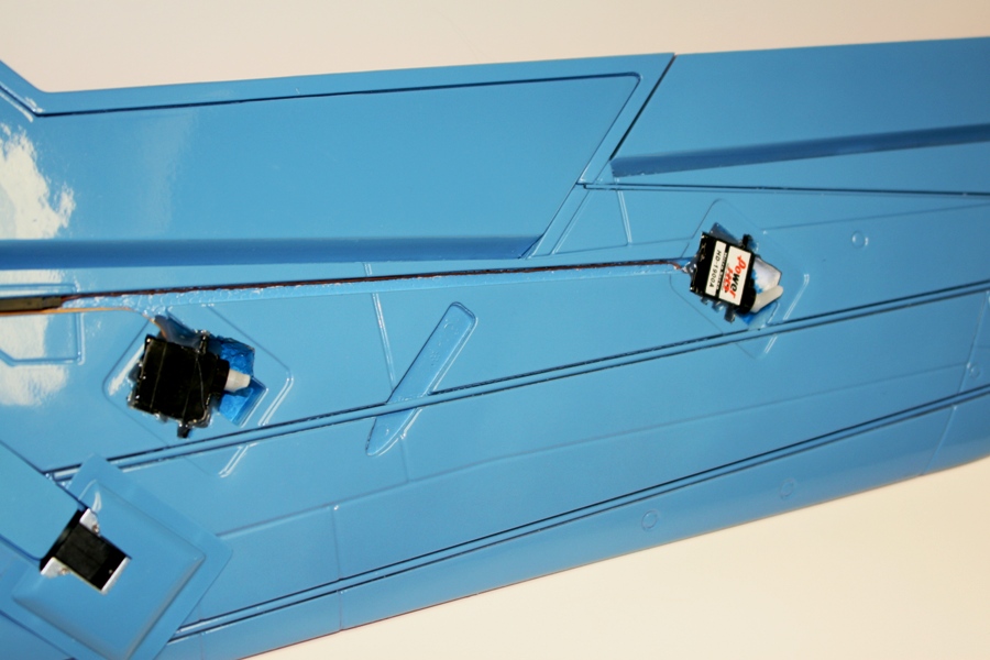

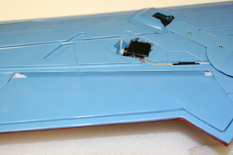

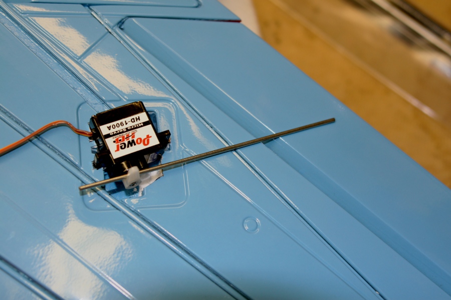

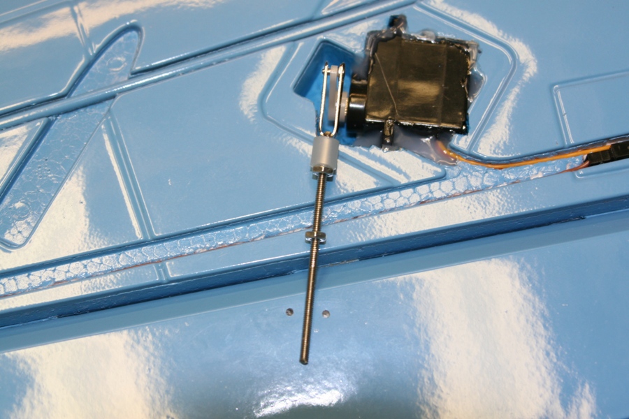

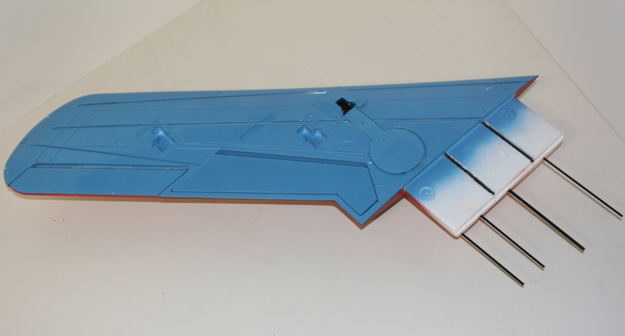

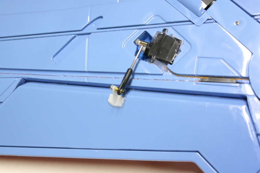

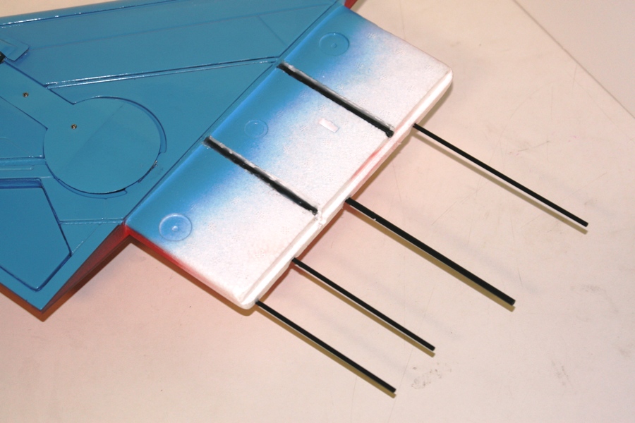

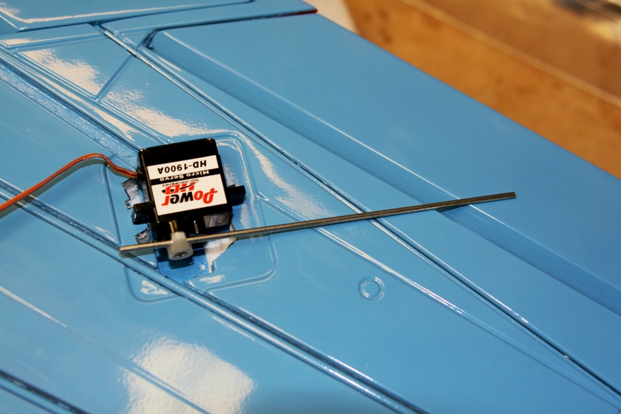

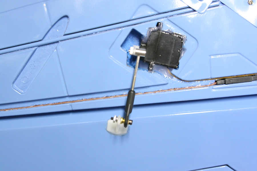

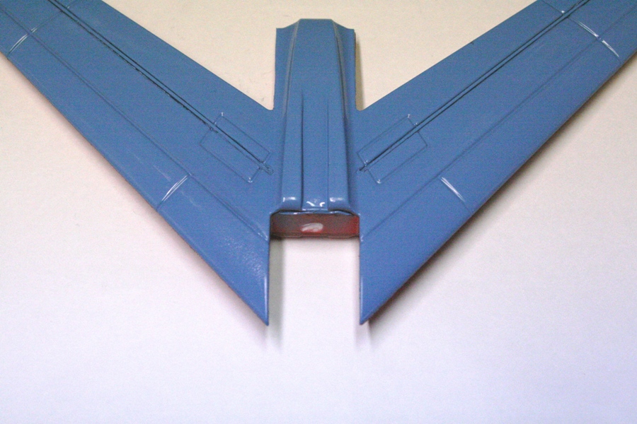

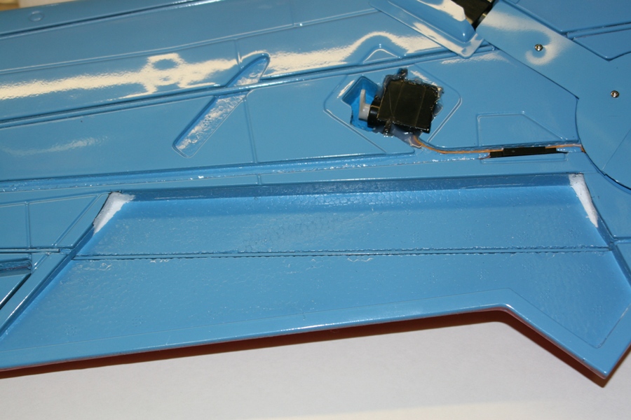

I thought to start the build by connecting the two wing halves. Since the electric retracts are already
factory installed, it made sense toplace the aileron &amp; flap servos into their pockets first. There was
one evident problem with the pockets as they placed the control rods way off from the expected 90
degrees. So, I slightly changed the servo position within the pocket which required a few cuts in the
PC skin and the removal of a little foam. The photos are better than words, to show what was done.
It may not look like much of a difference, but 2" toward a 90 degree control rod position was gained.</p>

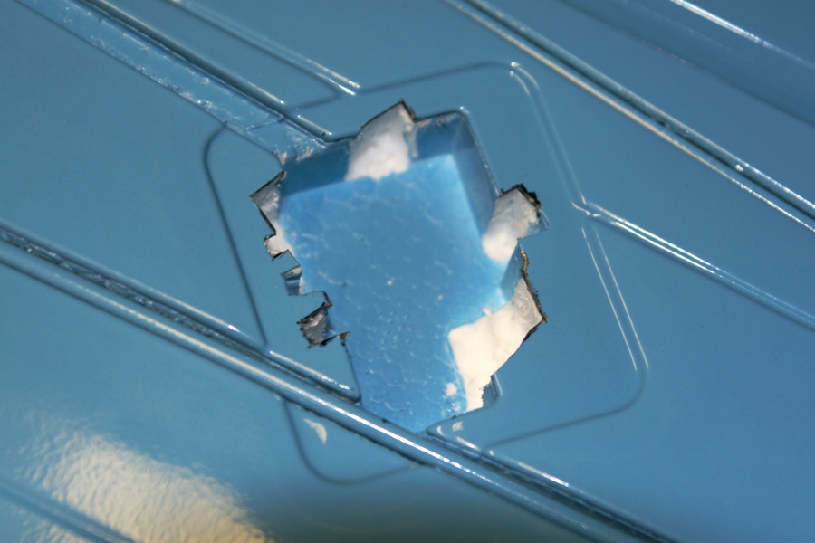

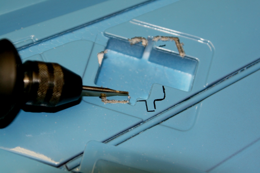

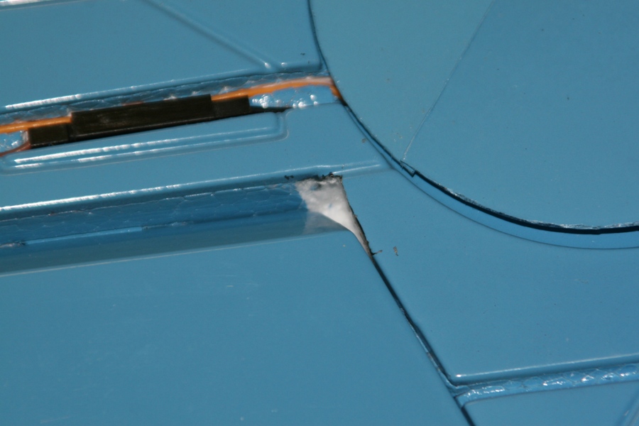

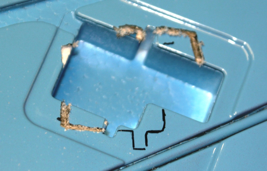

Once the new servo positions were marked, a dremel tool with a small burr bit cut through the PC
skin like butter. Then a regularexacto knife was used to cut the foam out.

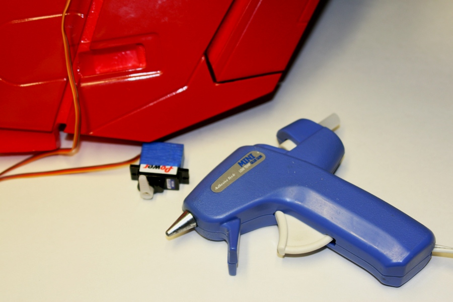

The servos are now going to provide better control to the flaps and ailerons, since the geometry
of the control rodswill bemuch better. I just used hot melt glue to hold the servos in the pockets
and then just pushed the servo wires into a slot I cutin the foamchannel. It makes for a better
install than having the wires just laying in the channel.</p>

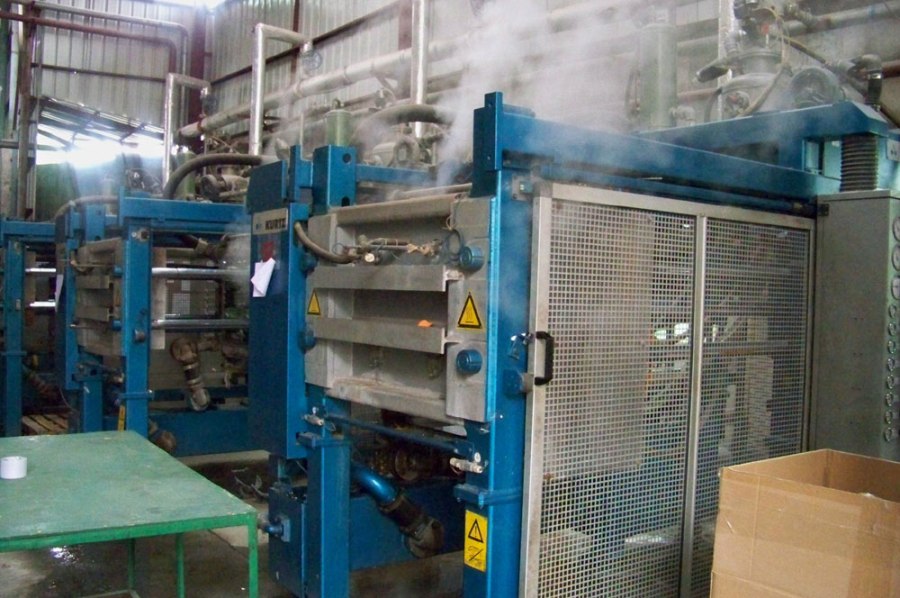

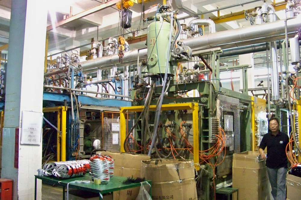

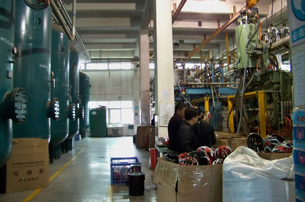

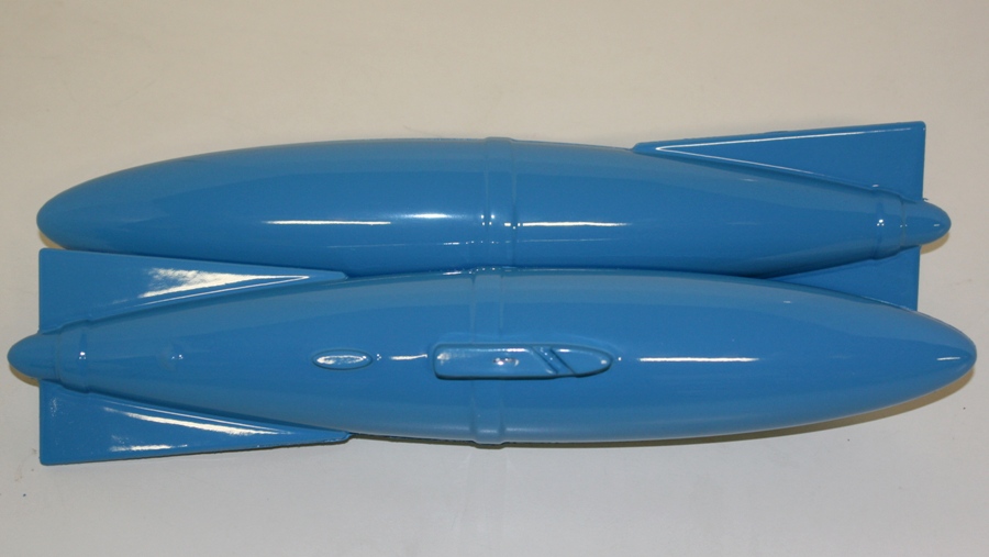

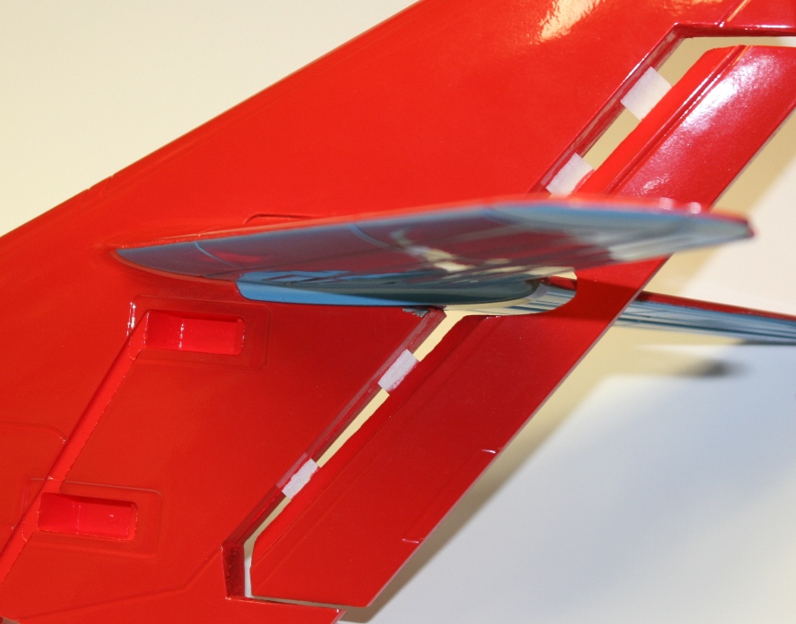

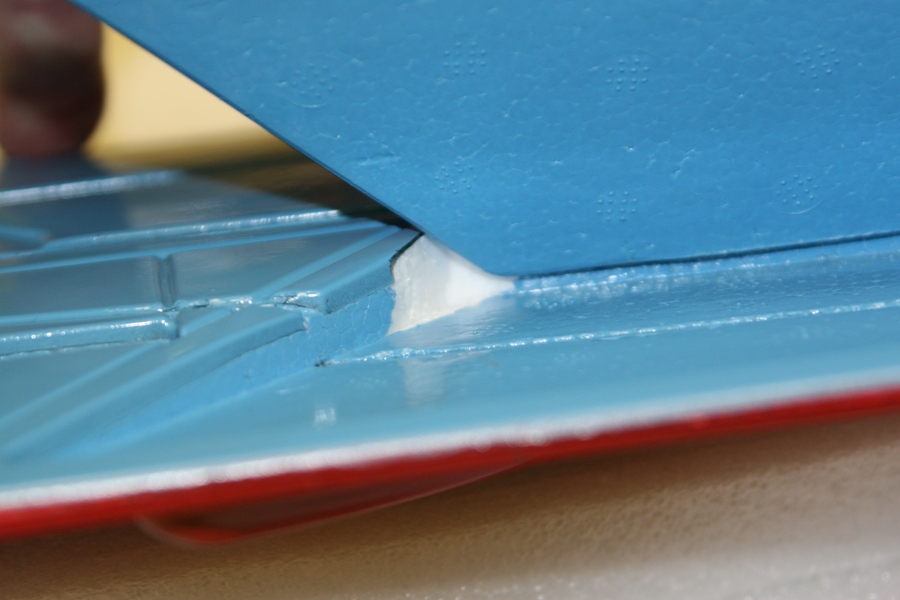

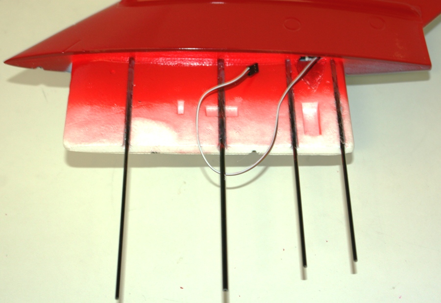

Let me digress for a moment in this Mig-17 build, to share with you some photos regarding the process
of convertinga foam airplaneinto aLander PC covered EDF. These photos weretaken by Richard, from
AirShow R/C, when he was in China at the manufacturing plants. I hope that it gives you a slightly
different perspective on the Lander PC covering.

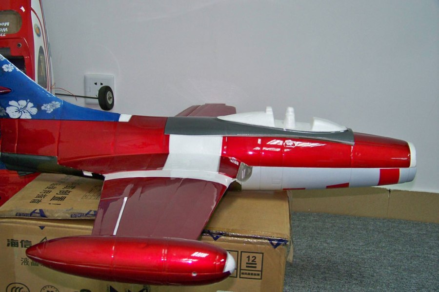

The added strength and durability of the Lander PC coveringis evident when you realize that
it's the same as the covering on a bicycle helmet. The PC Panther, below,is a custom paint
job which shows how great the PC covering looks when painted.

Starting with the flap servo controls first, it was noticed that the flap was basically stuck in the flap
pocket and could not move at the hinge line in order to be deployed. It looks like the thickness of
thePC covering was not accounted for in the design development. So, after a lot of figuring, which
really taxes my old brain, a small triangle of PC covering was removed from the wing atboththe
right and left corners of the hinge line. A new sharp #11 exacto blade was used and again, the
photos should be most helpful.
ID:	1463628   Click image for larger version
ID:	1463629   Click image for larger version
Old 07-05-2010 | 07:31 PM
papajeff's Avatar
Joined: Aug 2004
Posts: 833
From: Rochester, NY
Default RE: RC LANDER MIG-17 (PC VERSION II)

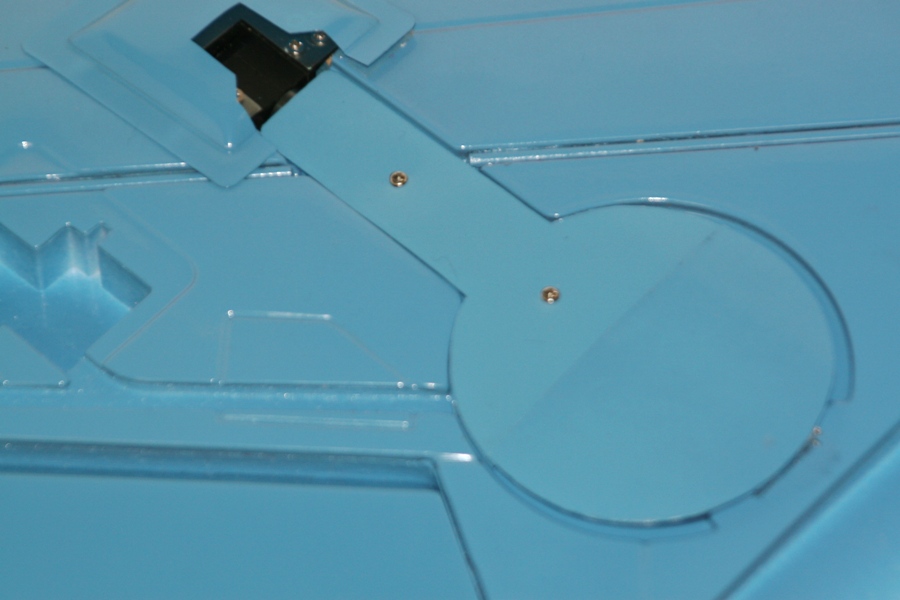

I was pleased that the flap was not pre-hinged, as it made this process much easier with the flap
removed. The flap was placed in position and the hinges glued in with foam safe ZAP CA.

The first attempt at the control rod set up just did not allow for proper flap movement. So, a swivel ball
was used and provided the proper flap deployment. Notice that the flap control horn was attached
after the control rod was placed, so as to get the best allignment with the action of the servo horn.
In addition, the photos show that the control rod is much closer to the 90 degree configuration now
that the servo pocketshave beenre-alligned.

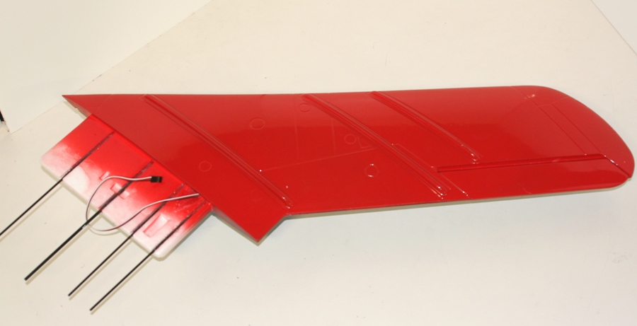

After a slight delay due to the flying season, the tail of the Mig-17 was next. The first step is to remove
the little "plug" that was part of the foam mold, so that the horizontal tail can be fit into the slot of the
vertical tail. First remove the rudder and trial fit the horizontal tail into the slot to make sure that it
lines up properly. Make any necessary adjustments and then epoxy in place. I used a thin layer of
ZAP 5 minute epoxy and wipped up any excess before it became tacky.

OK, so it's been a few months since any build posts, but that will change now that I have healed up
from my broken left hand. Long story we will leave for some other time. So, where were we? Oh,
yeah, the rudder! The rudder was hinged with your normal CA hinges. I wrapped the servo in
masking tape and then hot glued it into the pocket of the vertical tail. And the same for the elevator
servos.
