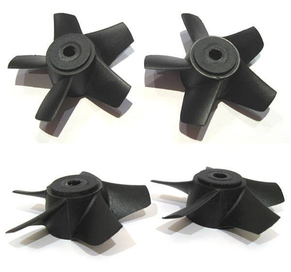

The EPF fan is running a copy of landers current rotors, imho not a very efficient design. But thats not the real issue with their fans, the rotor material is (see photo). Metal blades are illegal in AMA regulations which is why noone makes them for props or EDF (which is considered a shrouded prop).

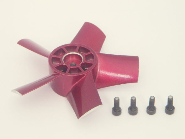

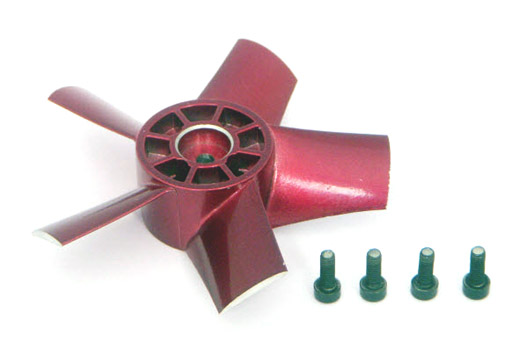

I thought I should post up a pic of the EPF 640. that way you could see what I am talking about.
And regardless of what some may like to think, it doesn't use a copy of a lander rotor, its their own design from 3 years of CAE work and wind tunnel testing..

Its great if you can get the aero bodies to accept metal blades, I wish you good luck with it, but it doesnt address the issue of efficiency, and 57 amps to get the same thrust as the current 64mm fans get at41 amps brings us back to the same problem of battery size and/or stress induced on the batteries.

They even have the same factory stamp inside the molding
Compare the basic blade designs of all the rotors below, very similar.From my experienceyou need to take most asian factory claims with a grain of salt until you actually try the gear. 3 years of testing? Simple fluid dynamic design would have done this rotor in 3 weeks, there are some classic mistakes in their theory too, they claim to have closed the blade to housing gap to much closer tolerances than other fans, thats great, problem is there is turbulence at the blade tips and having a gap is actually a good thing! Up to 1mm is acceptable for fans up to 70mm in diameter,1.5mm for 90mm up. This makes no impact on performance at all.
