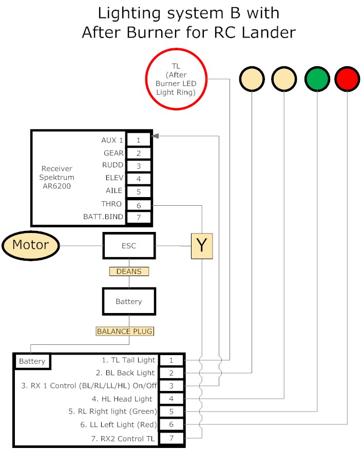

I ordered a RC Lander Lighting System B with After Burner from Sonic Electric. I found the instructions to be very vague and the diagrams were inconclusive.
I want to be able to turn on/off the aircraft light from a aux switch and have the after burner light stage up and down or just turn on when throttle is applied.
I am posting a diagram I created to see if I have it setup correctly. It is my hope that I can confirm/correct it and post it for others who may wish to refer to it.
I am using a Spektrum AR6200 Receiver and JR 9303 radio. I am using the gear channel for Eflite landing gear.[img][/img]
I would appreciate any help in confirming if my wiring is correct and I am also looking for some help in programming my radio to move the lights on/off to a Aux switch.
Thanks in advance for your consideration and help.

Thanks for your purchasing our product. As per your request, I have made the following suggestion for your reference.
1) The connection for all cables are corrected.
2) Power on the TX and pull back the throttle stick on the idle position then connect the battery with ESC. (pls notice to make sure the TX Aux 1 travel throw is a normal setting 100%)
3) All lights should be on except the afterburner. On that time you can decide the Aux 1 (JR- flaps function) on0 position is turn on all lights.
4) On 1 position is turn off all lights. That means pull back the Aux 1 on 1 position if all lights are turn off that the setting is already pre-set by factory. Otherwise, you need to do
adjustmenton the PCB VR 1 - normally a little bit anti-clock wide travel adjust until all lights are closed to power off level. Then push back the Aux 1 to 0 position, all lights will be on &
green &red lights should be flashing. Pull back the Aux 1 to 1 position to check all lights are off or not. If all lights are not fully off, pls use the flap trim or Aux 1 travelling on your TX
to do fine trim until all ights fully off. On that time the RX 1 control all lights are completed.
5) Afterburner set up; power on the TX and set the throttle stick on the idle position then connect the battery with ESC /RX (make sure the balance plug cable is connected with PCB).
6) Afterburner lights should be all off on the time (pre-set by factory). Otherwise, you need to adjust the PCB VR 2 to turn off the afterburner either a little bit on according to your desire.
7) Then push up full throttle, afterburner lights will be linear brighten.
Hope the above information is clear to you. If you have any question, pls feel free to contact me again. ([email protected])

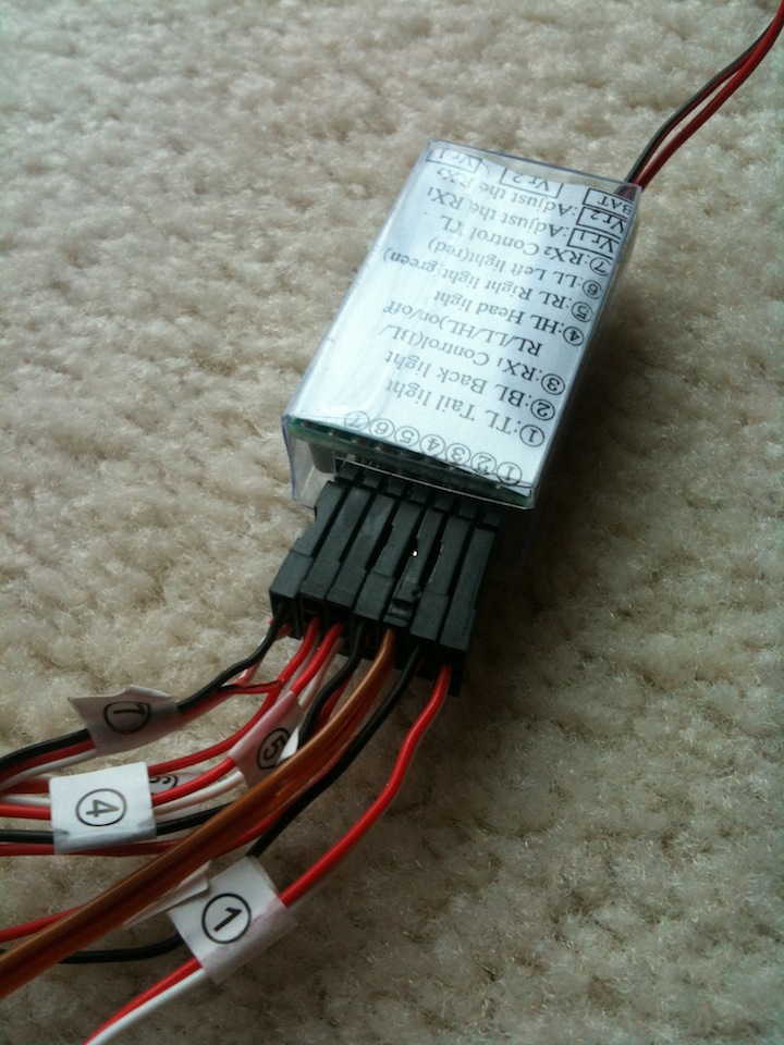

Dennis,
I'll have you know I received mine this week and spent ~1.5 hours trying to figure it out. I eventually got it functioning corectly using the retract channel. The trick is in tweaking the VR1 (nav lights) and VR2 (afterburrner). It seemed flakey at first but eventually got all the plugs in the correct orientation and found that adusting the gear travel to +140 set the wingtip lights to a good on/off sequence. The afterburner ring is actually pretty darn bright. Ran it off a 4s battery. I wish it could be turned off like the nav lights though. Maybe put it on another channel (other than throttle) and setup a mix and pick a open switch. Haven't gotten that far yet with the system. Here are my plug orientations, with the label facing up:
1: tail light - white wire to last pin
2: back light - black wire to first pin (signal pin according to RC lander documentation)
3: Rx1 control - white wire to last pin (I used a spare jetcat throttle control servo wire with two plugs, so orange wire last pin)
4: head light - black wire to first pin
5: right light - white wire to last pin
6: left light - white wire to last pin
7: Rx2 control - white wire last pin, red wire cut to second pin, and black wire to first pin
Hope this helps, Ken

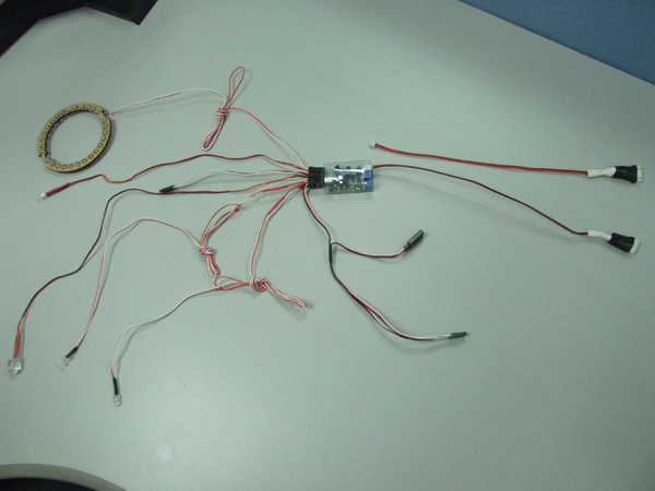

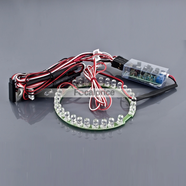

By the looks of these photos, there's different rings offered.
3 photos of the green ring, My guess only, is the 70mm ring. the other photo is the, my guess again, 90mm ring.
Clearly, the 70mm or green ring is constructed "cleaner," that is the thickness of the ring is smaller than the one in the other photo.
One would guess why? Also seems as though there's more thickness in the other ring than necessary.
They don't make it easy for you.
