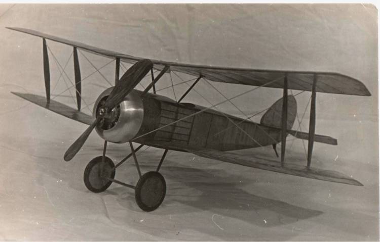

My own RTP planes were actually electric control line. The two wires providing the electricity for the DC motor also moved relative to each other to control the elevator. As the 'pilot' sat outside the circle it did require some quite complex linkage at the centre pylon to achieve it.
The big advantage of doing this was the elevator control system added very little weight so allowed some quite complex and true scale planes to be flown within a 4 m room but it took far longer to develop (and to build!) than you have available!
The first picture (The Martin Baker MB5) is the biggest at 560 mm span and has two motors driving the contra rotating props is all sheet balsa but it still only weighs 127g.
