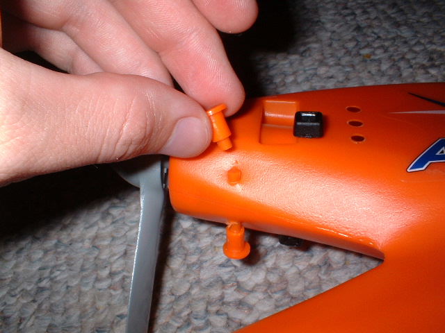

I've taken to leaving the wings on my ABC all the time. Today I came home from class and saw my wing deflected off to one side and rubber bands everywhere. Yes, one of the wing mounting points broke off! Argghh! I've had it for less than a week. It's been through 3 battery packs and never crashed. I suspected that if my 'bird ever broke, I'd be the cause. Guess I was wrong! Is there a good reliable way to fix this without risking a break in-flight, or do I have to send it back to HobbyZone?

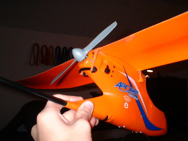

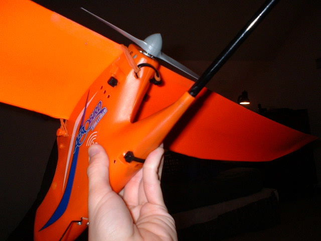

Here's my temporary solution that just might become a permanent solution!
The idea of reinforcing the 'bird with zip ties inspiried me to try to use them to fix this problem as well. I pulled the broken plastic peg out and ran a zip tie through the hole. I slipped three rubber bands through each side, then tightened it down (but not too tight). This should hold the bands in place. In a crash, the wing can still seperate by releasing the bands on the front mounting point. As a bonus, no more lost rubber bands! (I've already lost two.) I've attached some pictures, and I'll update this after flying a few more times to let you all know how well this method works.

Looks like it might work!!!
Don't forget to take the wing off when you don't fly though.....it REALLY stresses all kinds of materials involved.

You could use a piece of hardwood dowel to fix that, but I do like your zip tie repair. This hobby is all about ingenuity.
Get a length of 3/16" dowel from your local hardware or big box home improvement store, drill out the holes in the fuselage big enough for the dowel to fit through but not so big it flops around, and install a piece of dowel long enough that it will hold the rubber bands.
