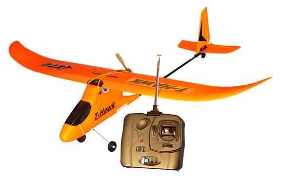

Also try the T-HAWK . I have never flown one but I hear plenty of good things about it . It should be a grate beginer plane ! I'ts about $150.00 .

The T-Hawk is basically the same as the Challenger control-wise. Tail configuration is different, but the end result is the same.
