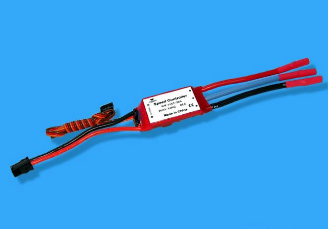

i bought a 18 amp brushless inrunner from nitro models and a 20 amp esc from same place . No wiring diagrams came with, and does any 1 know if the brushless esc's come with a bec automatically or do i need 1 of those also? TY john
here are some pics i just got off the site. and what kind of mounts do i use or need for a mini ultra

i just posted a few pics of the outfit i purchased hope u can see it ty e
link http://www.nitroplanes.com/inbrmo.html
http://www.nitroplanes.com/spco.html
http://www.nitroplanes.com/b2hainbrmo48.html
http://www.nitroplanes.com/20abecbrrcsp.html
looks like it was a 20 amp motor and esc hope i got that part right and its looks like its got a bec in it ty e flight

Hi,
As a general guide, most generic "made in China" speed controllers are now setup with default settings to:
brake - off
battery- Lithium battery
Cutoff -Reduce power at medium (eg 2.75v per cell)
Startup - Normal for aircraft
Timing - medium for general outrunner
Connect blue to white, red and black dependant on the rotation required for prop.
Plug in battery and receiver and you are good to go.
When battery gets low, it will reduce power. this is your hint to land.
Have fun
Boyd

ty snow boyd that should get me started. i may have to come back later to ask more Does the red black wire chang the direction of travel of the motor? AND HOW DO I MOUNT IT

ESC to Motor has 3 wires. Connect blue to white. Then red and black dependant on the rotation required for prop. So if you connect red to red/black to black and it is rotating wrong way....swap so red to black / black to red.
What application are you using it for. Normally in planes you purchase an aluminium mounting plate - kind of like a cross with a circle in the middle for the shaft.
Depending on KV of motor sometimes you mount to gearbox.
