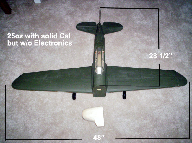

I have a F-27B ParkZone. I also have a Cub ParkZone.
The F-27 has a 480 straight drive motor and the cub has a 370 motor gear box.
I have this plane.
I am wanting to use one of the two ParkZone Electronics to get this plane in the air.
I also need to know what size and type prop would be best fit for this plane.
The Cal is not done because I need to know which way to go with the power plant. I was told a .25 should fly it nicely but thats a nitro engine. Due to the Cal not being huled it adds a little weight, so the plane I am thinking will come out a few oz'es shy of the total it is now.
I have the full set of electronics from the ParkZone planes that could make this plan RTF if they will work.
I did simply try taping the motor from the F-27 to the front and see how well it would pull. It only pulled the plane forward never moved though. One prob I think thats the cause of this is because it's such a small prop used on the foamy F-27.
I'm not sure this will even work but it would be nice if I could get some feedback.

The "electronics" from either the F27 or the Cub can be used, but the F27 will need the jumper changes for a conventional tail. By "electronics" I mean transmitter, receiver/controller and servos. However, neither motor drive will work. The F27 is set up as a pusher: you would need to reverse the motor and if you already used the motor as a pusher, the brushes may become damaged if you reverse the motor. The Cub's motor and drive are designed to keep the very light (15oz) Cub in the air, but without much extra power. Your plane, with all of the electronics and motor, will be twice that weight. You will need a considerably more powerful motor/drive and larger battery than the Cub's. You probably need to consider the powerplant from the PZ Mustang for this plane.

personlally i would get all new electronics to put in there... parkzone electronics are really only good from parkzone planes good luck if you decide to do this
I've found the PZ electronics to be fine for what you're doing. 27MHZ systems aren't the greatest, but the setup made for the PZ planes is pretty good for for a park flyer. I'm using one in my Slow Stick.
you didn't give the demintions on the plane you're building, but it at a guess I'd say its too big for the Piper's 370 motor and 5:1 gearing. The F27b uses a 480 motor, which would be fine, however it's also a very light plane, so a gear box and new prop will be needed.
Your best option would be a P51's gearbox, however the motor would need a pinion gear, and the f27's shaft is splined, so your best and easiest bet is to just buy a p51 motor and gearbox, and the P51's prop. Or for that matter, any 400 size motor and 3:1 gearbox should do, the PZ's would just be the easiest to wire.

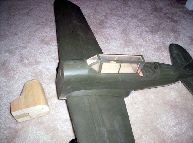

Well I grabbed a new .25, receiver and some servos guess I'm going to make it happen this way.
I am Glassing the cowl now and the cg seems to be good.

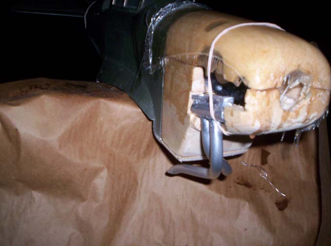

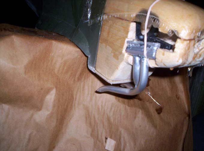

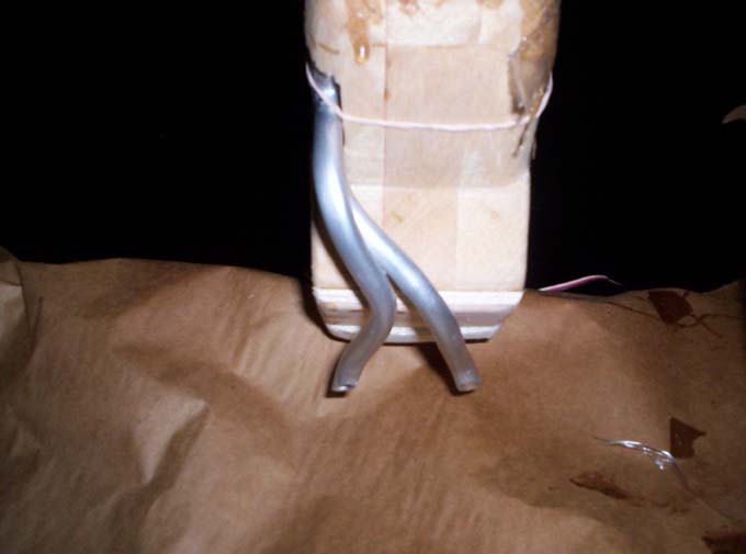

I make exhaust system for rc cars/trucks and so now that I am into planes I decided to make one for the .25. Should help me with the CG a bit since the Slimline exhaust is kinda heavy (and a poor performance design). The guy I grabbed the new 25 from thru in a Slimline pitts exhaust and it ended up being for an FP. So I guess I'll be throwing that thing on eBay

BTW heres some pics of the exhaust I made for the P-30...
I had to remove the engine for the glassing so I just throw a rubber band to hold the exhaust on to give the idea.
