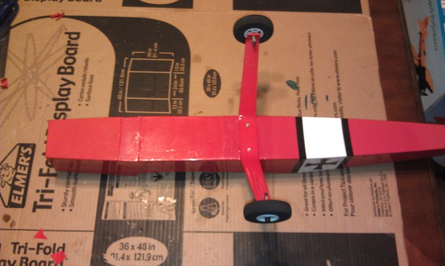

You can see the original main gear position (on left) compared to the new position.

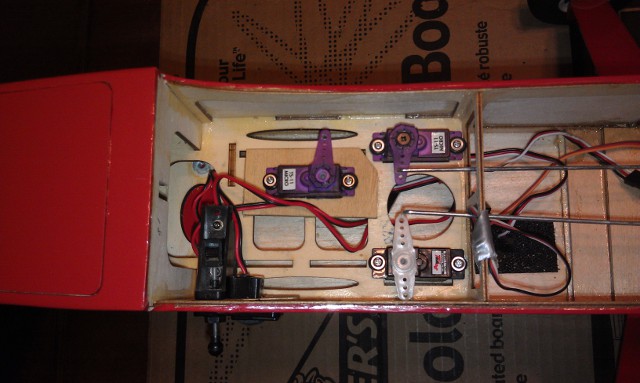

Here is the servos reconfigured. I had to move the rudder servo more towards the middle to give room for the stearing linkage. I installed an additional servo for throttle. Also pictured is the charge jack/on/off switch installed.

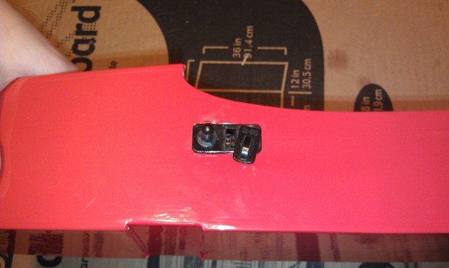

This is the charge jack/on/off switch installed (outside view).

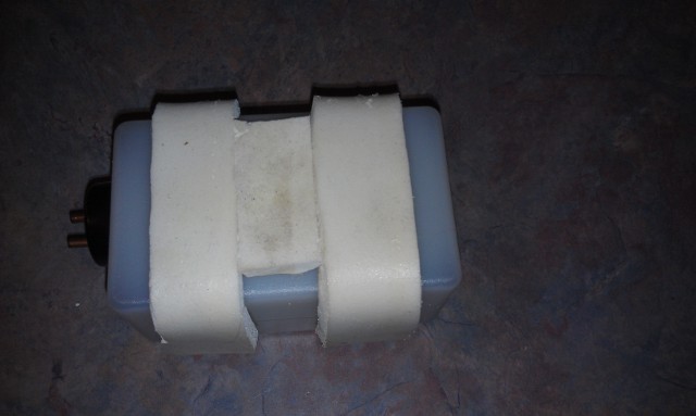

A 200 cc fuel tank (approx. 6.75 oz). 1/4" foam installed everywhere it will touch the fuselage directly.

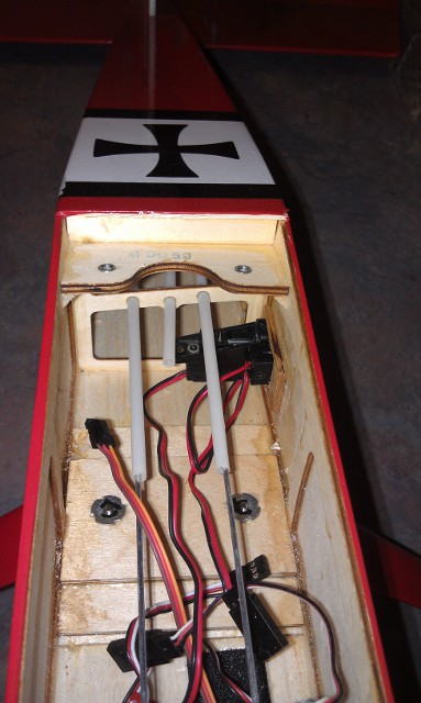

Ok, I had a brain fart. The original location of the charge jack was going to conflict with the stearing linkage so I reinstalled it more towards the rear behind all the servos and under their linkage.

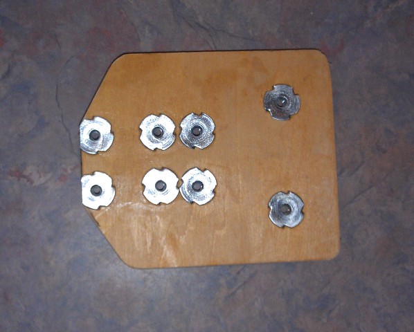

The back side of the new firewall (sideways). Blind nuts installed for the motor mount and the nose gear assembly.

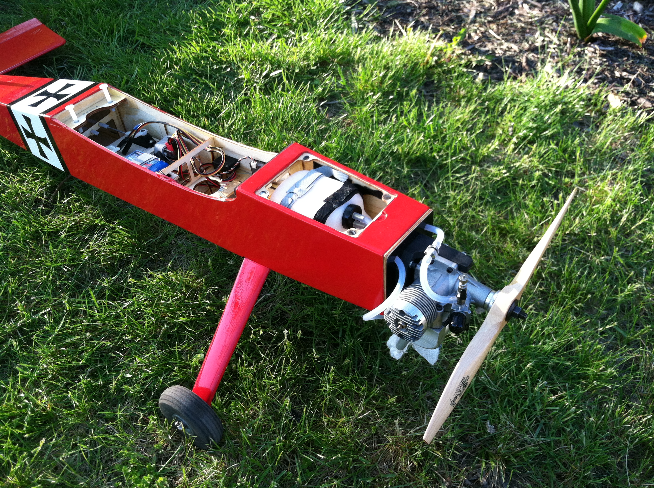

Firewall installed. Stearing assembly and linkage hooked up temprarily. I still need to cut the top of the stearing arm dowm and install the stearing arm linkage and cut the stearing cable to length. Slowly but surely it's all comming together.

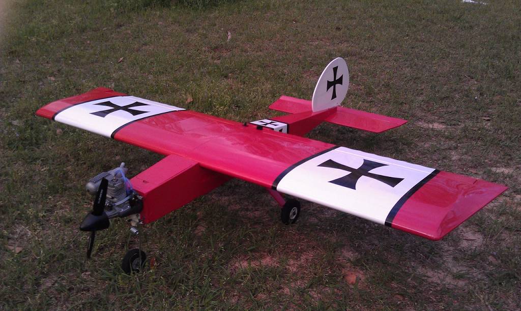

After my previous post I hooked the charger up to the Rx and let it go for about 3 hours. I then finished up the conversion and went flying.
WOW I am one happy camper. The conversion was a complete success. This just might be my new best plane. Very smooth flying, decent speed, and decent power. I flew it for 5 tank fulls. Here are the original and the conversion specs.
Great Planes ElectroSTIK origannly speced:
Wingspan 52.75"
Wing Area 589 sq in.
AUW 3 - 3.5 lbs.
Wing loading 11.7 - 13.6 oz/sq ft
Length 45.5 in.
Brushless motor equivelant to a .25 - .30
2200 mah 3s
Tail Dragger
My New conversion specs (same physical size)
AUW 4.25 lbs.
Wing Loading 16.6 oz/sq ft
Glow Motor OS .40 LA
Fuel Tank 6.75 oz.
12 + mins flying time @ 75% of the time WOT
Tricycle Gear.
I was able to acheive proper CG by installing the Rx battery in the fuselage just behind the trailing edge.
This conversion was such a success that I am now going to start on my next conversion. A Maxford USA electric Gee Bee "Y" w/ a 39 in wingspan. Will post a new build thread as that progresses.

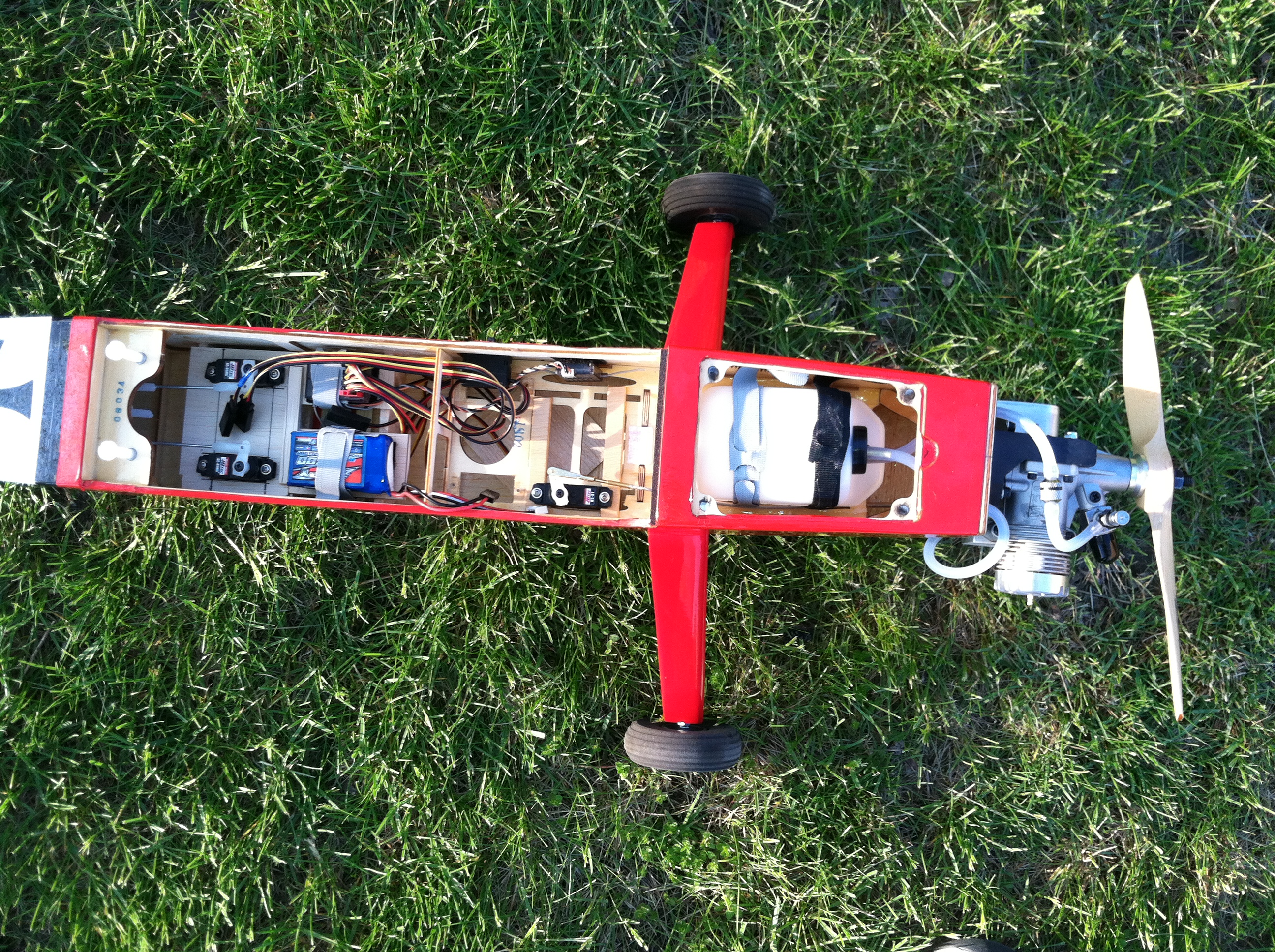

ID:	1969304   Click image for larger version
