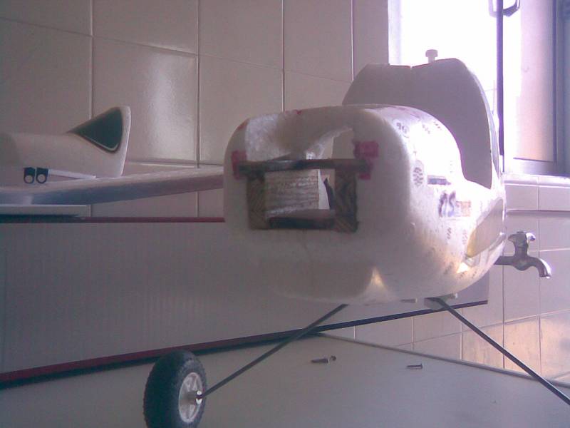

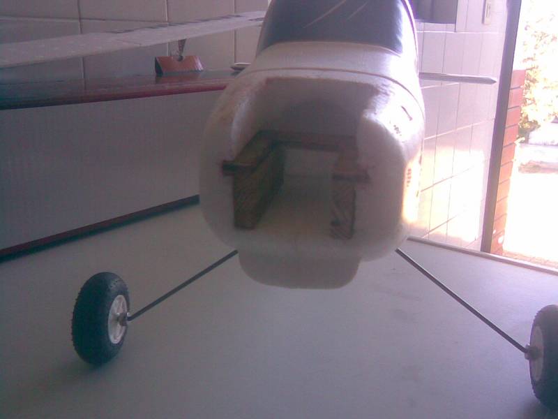

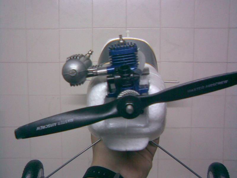

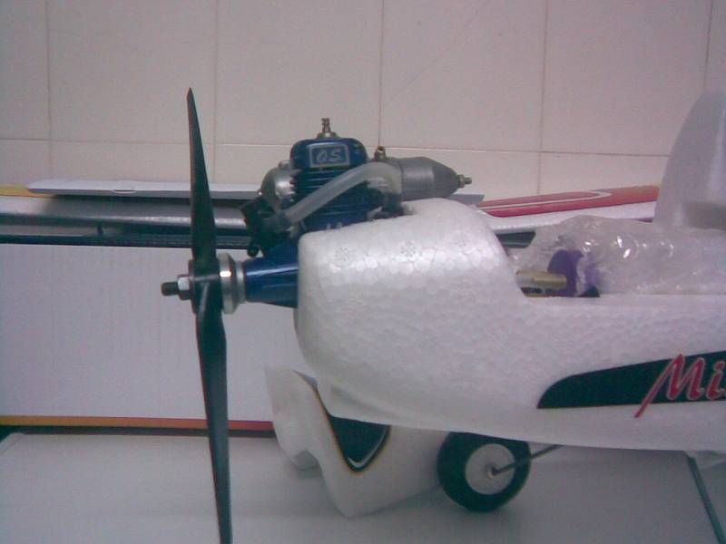

Getting home, this afternoon I started assembling the rudder and horizontal stabilizer and sticking the decals. Removed with an X-acto knife the top of the engine cowl, along with the glued in motor support and fit the 10LA in there for a general overview of the needed modifications and so on.

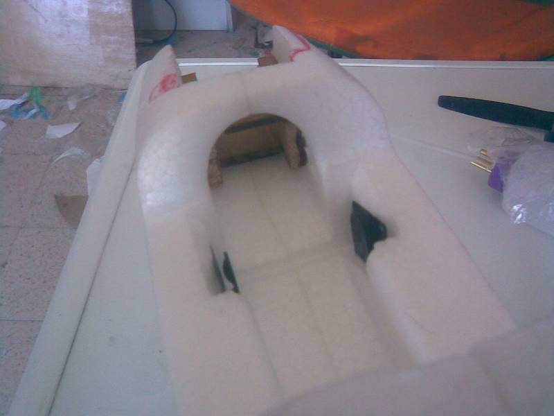

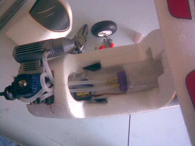

The electronics will be placed under the wing, in a nice large hole it has there, the fuel tank (100cc) stays under the canopy, which secures it perfectly. The bigger difficulty will be making the engine mount, most certainly out of ply glued with cyano to the foam (CA holds better to elapor than other glues, epoxy included, as they say).
I'm considering the engine positioning as on the last photos, more recessed on the fuse.

Kinda reminds me of sure flight planes, remember those? I say make a lite ply mounting plate for the motor and yellow glue it in place or use epoxy, it should be fine, but watch out for rough landings, the whole nose could break off where the gear plugs into the fuselage.

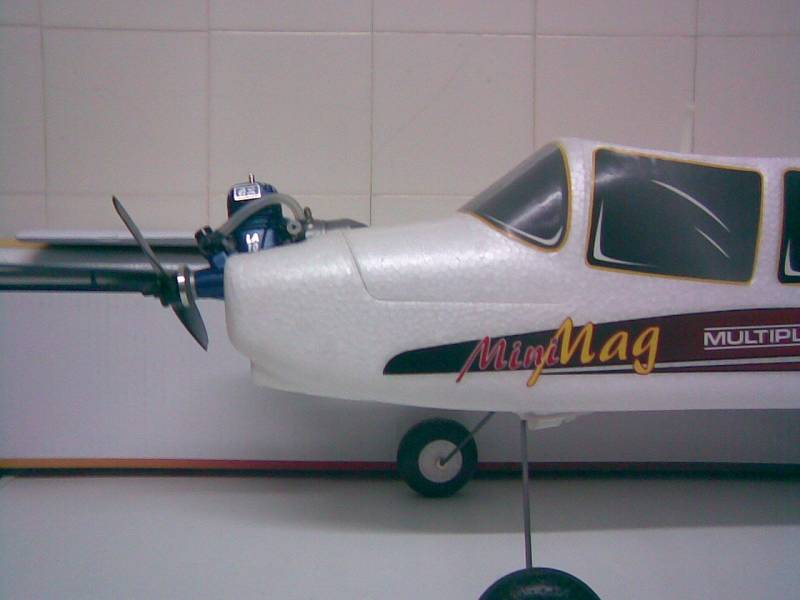

Fabricated the engine mount this morning out of 6mmx6mm hardwood and 4mm ply. Cut some slots on the sides and the mount is a nice snug fit. I have glued it in place with thin CA and will give it a bit of coating with epoxy later this day, along with gluing the bottom piece of ply thats serves s bracing.
Seems like the MiniMag was made for the small OS!

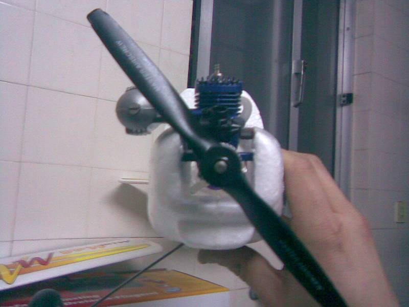

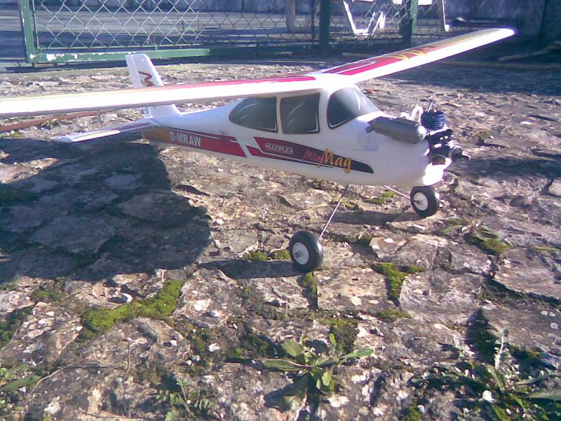

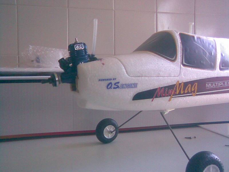

In the meantime... it's finished! I just need to put a receiver on it and go fly. CoG isn't much off, but still, pushing the fuel tank further inside the fuse, closer to the CoG and stuffing the receiver battery way back should be enough to balance it.

Wellllll...it looks great and will, no doubt, fly well. However, You might consider adding an exhaust deflector.... http://www.rcplanet.com/Dubro_Exhaus...o_p/dub697.htm ....
I have very little experience with fuel power, but would personally feel better if the hot exhaust gases were defected away from the foam fuse of the Mini Mag. The device also keeps some of slime from accumulating on the fuse. I put one on my only fuel plane, a SPAD debonair...(yet to maiden). regards, rich

Took it out today for the maiden flight.
The engine, as seems to be with all small OSs, was a pain to hand start (I have to walk half a mile from the parking lot to the field, so a starter is out of the question), managing to drain 2 fully charged 2A glow starters, but not before a flight.
All I can say is that I have never EVER seen a MiniMag fly this fast![X(] Not even a fully hoped up brushless setup on 3S lipos one! It seemed more of a fast WW2 bird than a trainer; loops were made on a dime, super tight rolls (my first ones), simply WOW!
