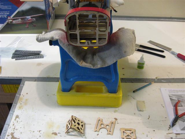

When I first saw the E-Flite Taylorcraft, the first thing I thought was Wow! they finally came out with a really neat small scale ARF! Then later I found out that it was for electric only! What a mixed up world this is!
Well it looks like I will have to do it myself. I convinced a freind who only knew electric to go with the conversion too. We both bought Taylorcrafts and started the changes. The model is made very nice, but it is also made very light.
There is an electric motor mount that sticks out of the main firewall/bulkhead that we removed and replaced with a new firewall of 1/8th plywood. Also there is a horizontal structure behind this firewall that was removed for the fuel tank location. Two balsawood straps were glued in at a new level to support the 4oz. fuel tank.

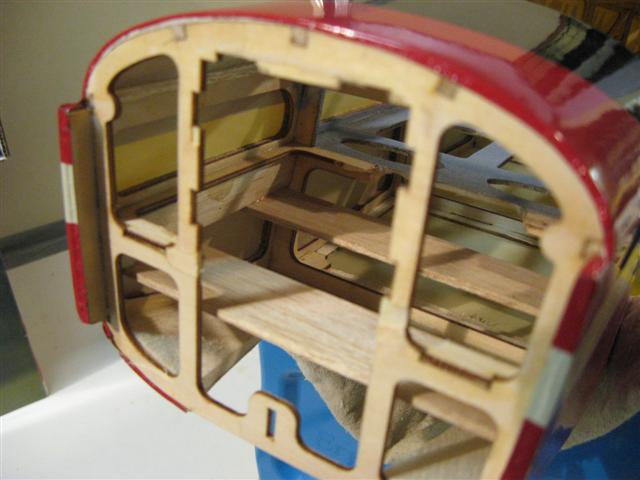

Default RE: E-Flite Taylorcraft conversion to GLOW!
Here is a pic of what is left of the original firewall, and fuel tank supports.

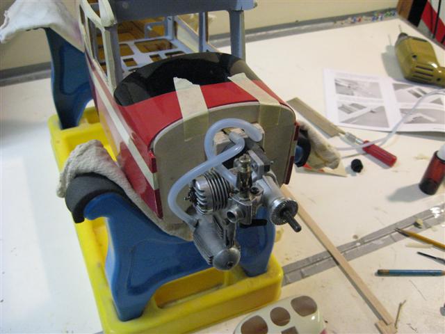

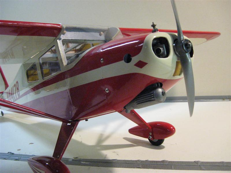

This plane is so light I thought it would be great for a .10 size engine. I have some old OS.10FSR's that needed a home, so I went with that for my Taylorcraft. My friend has a .15 for his. Here is the OS .10 with engine mount and fuel tank tubes through the firewall.
This is what it looks like on the model.

Once the thottle pushrod was installed I epoxied the firewall assembly on. Then I built the rest of the plane per instructions.
I did have to cut a little into the bottom for the muffler but filled that in with a balsa block hollowed out for the exhaust. I hated cutting the cowl for the muffler and other engine parts, but I could not find a Pitts style muffler for a .10! I also cut out a little on the bottom for air exit, and blocked off the intake hole opposite of the engine head.
