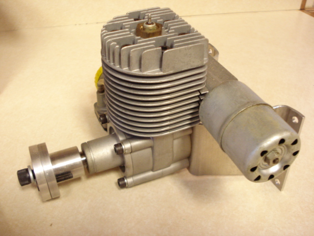

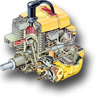

Look at the site above. It was known by Cox as the Beaver. It was sold as an RC engine by Hobby Lobby as the Rhino 1.4. The engine I have came to me used and with an adapter for using a glow plug in place of the spark plug. I plan to try it with a glow plug on gas/glow and maybe with an electronic CDI with gas. My carb diaphram is FUBAR and I plan to fit a walbro carb on it.
The attached images are some pics I have gathered.

Okay. Resurrecting an old thread. I got a Cox/Roper 140 engine on eBay and I want to convert it for airplane use. This thread is a little old and light on information. I was wondering if someone could help me with the conversion. I tried several searches, but my search-fu must be weak. The engine is 1.4 cu.in, or 23cc. The output shaft is a keyed 1/2 inch shaft. I looked at the stickied how-to posts, but didn't find what I'm looking for. Specifically, how-to on prop shaft, possible carb replacement, ignition replacement, etc. Any help/suggestions would be appreciated.

Well, you will need to remove the flywheel and switch to electronic ignition instead. It is easy to get CDI ignition modules from many sources. The owners for some conversions made a flywall mounting plate to affix the engine with off the back where the flywheel used to be.
Then you need a prop hub to mount the propeller off the other end of the crankshaft. There is a slot for a woodruff key. The center bolt is used to help keep the hub on and you use four outer bolts to mount the propeller onto it.
The CDI ignition magnet goes into a hole you drill into the prop hub for that purpose. The hall effect sensor uses the magnet to fire the ignition coil.
What you do is use a lathe to make the prop hub. It is a relatively snug fit onto the crankshaft. But you don't bore the hole all the way through. You leave a shoulder or step so that the center bolt is used to keep it on tight with. The tricky part is cutting the woodruff key slot. You can't use a broach as the bored hole doesn't go all the way through. You need to take a lathe cutting tool and grind it to size. Then you lock the hub in place on the lathe and run the tool in and out shaving off slivers of metal until the groove is cut to about the right depth. I would go for a snug fit where you need to heat the hub up good so it expands and then slip it onto the crankshaft end (along with the woodruff key). Then put the center bolt in to help keep it on. Before you mount the prop hub, of course, you need to put in the four mounting screws for the propeller too.

Photo # 1, 5, and 6 look like they are gas / glow with a glow plug conversion adaptor. That would save the weight and complications of the CDI or magneto.
