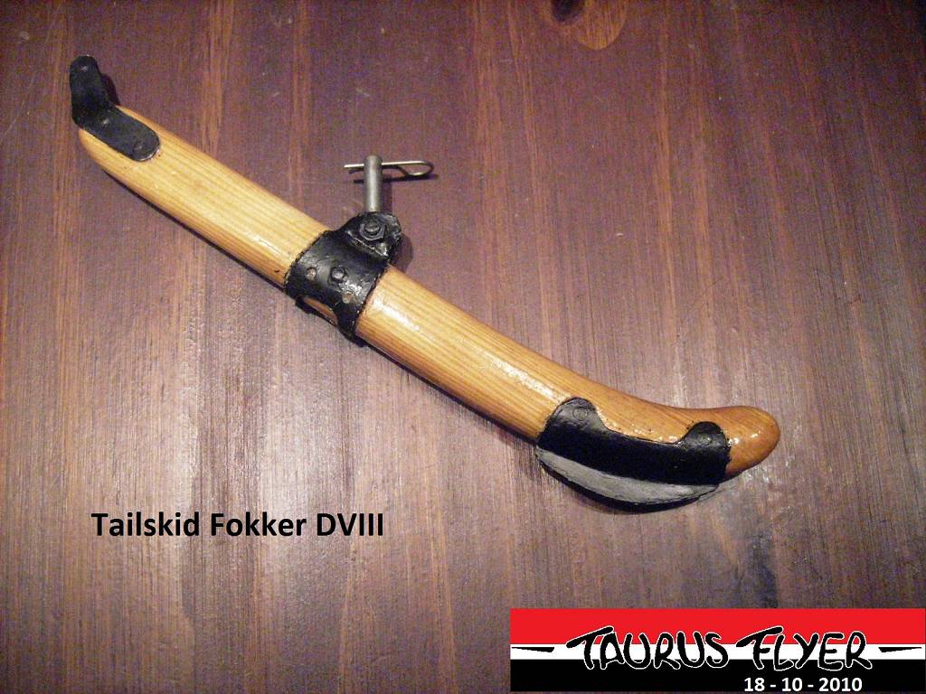

Scota4570.
Fokker, so info from the Netherlands.
The tailskid wasn’t controlled by the rudder. The centre position was maintained by rubber bands that also were used for suspension, connected with the top of the skid in the fuselage.
The skate is made of steel to keep track on grass surfaces, very important part of the skid!!!!!
This is my copy of the original tailskid of the DVIII, scale ¼, I think the DVII would not be much different
What to do on asphalt or concrete? I don't know, you need something to keep the track!!!!
Cees

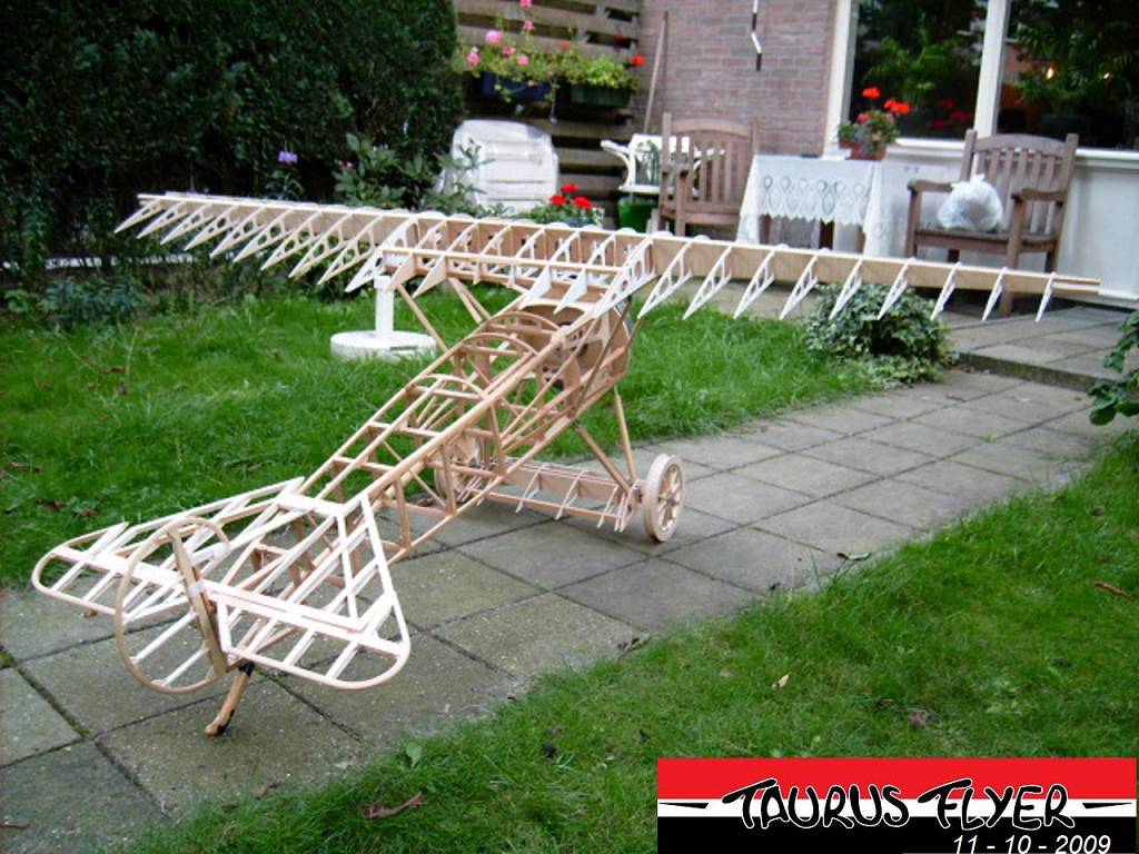

Old 10-18-2010 | 07:04 PM
Taurus Flyer's Avatar
Joined: Jan 2004
Posts: 2,408
From: Almelo, NETHERLANDS
Default RE: OT- Tailwheel for Fokker D-7
That's right,
People who can do that we call an AV8TOR, you have to learn that.
I only doubt a little bit about that down elevator!!!!
Cees
