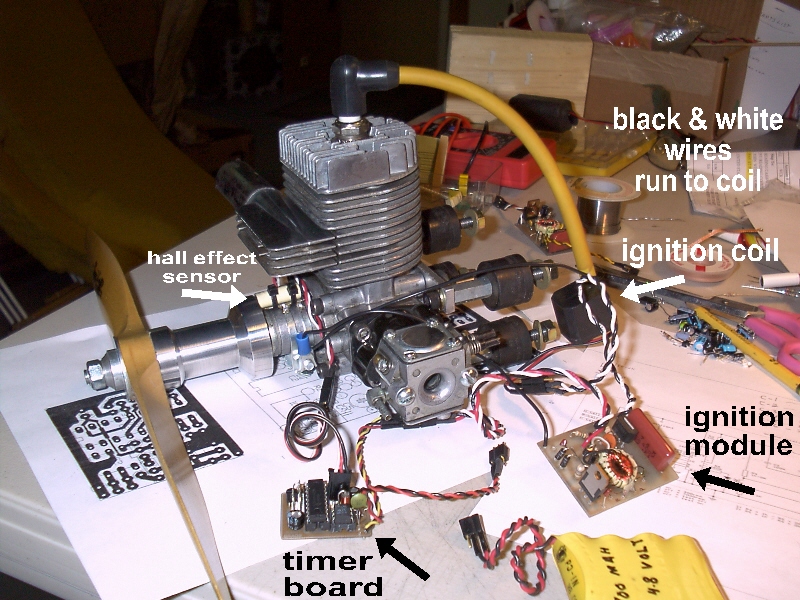

Here's the picture of my ignition that I have been building for 30 years..very reliable..can be used with a timer board or mechanical advance as you wish.
John

John, that is a pretty neat set-up. I like the Lord mounts too. I was always going to try a set of lord mounts bu have not. Did they work good? Looks like you are handy, and having fun creating with your mind & hands. Good going! BestRegards Capt,n

The Lord mounts work excellent for me. I've had some real shakers in my day that would have torn an airframe apart..added the mounts and that solved the problem. You really have to use locktite on all nuts and bolts though for insurance! Same principle as Chip Hyde's engine mounts..rubber isolators. The DuBro units with rubber also work if you have a beam mount type engine. These weed eater and chainsaw conversions shake a bit if you remove the over-balanced flywheel and magneto in favor of a CDI system.
I have quite a few other small conversions that worked out well. My last one was a small Shindaiwa weed eater engine..still not sure of the size but it had double rings and high compression for it's size. Ran it with a 16-10 prop and got a little over 7,000 rpm at full advance of 28 degrees with my CDI. Good enough to fly my 60 sized Big Stik. 7-1/2 lbs. all up weight. Should give pretty good vertical.

If you meant my cdi system, here's a photo of it connected to a Cox 1.4 cu.inch chainsaw conversion I did.
John
John
