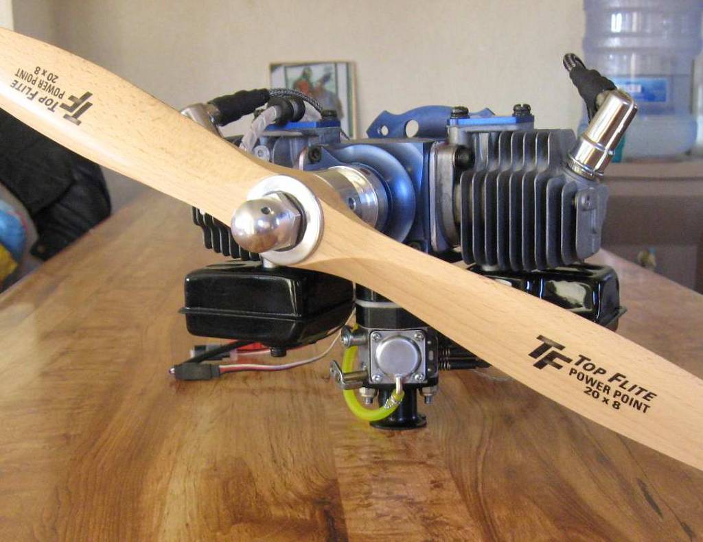

Yes, I have made several of those twins, one for me, and a couple for other people. I am just now finishing up a second one for me. This one has the favored Echo 23.6cc cylinders with 25cc crankshafts. Made a spacer for under each cylinder to accomodate the longer stroke, did some mild porting, etc. Should be a good runner...

Here is one.
AV8TOR

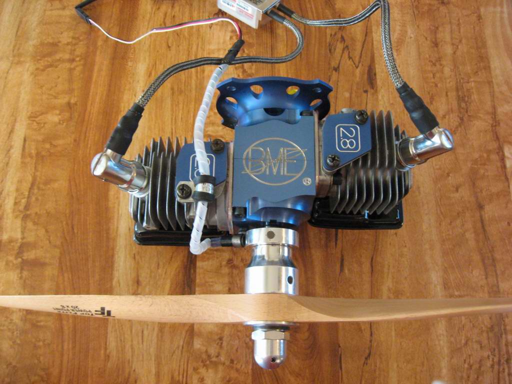

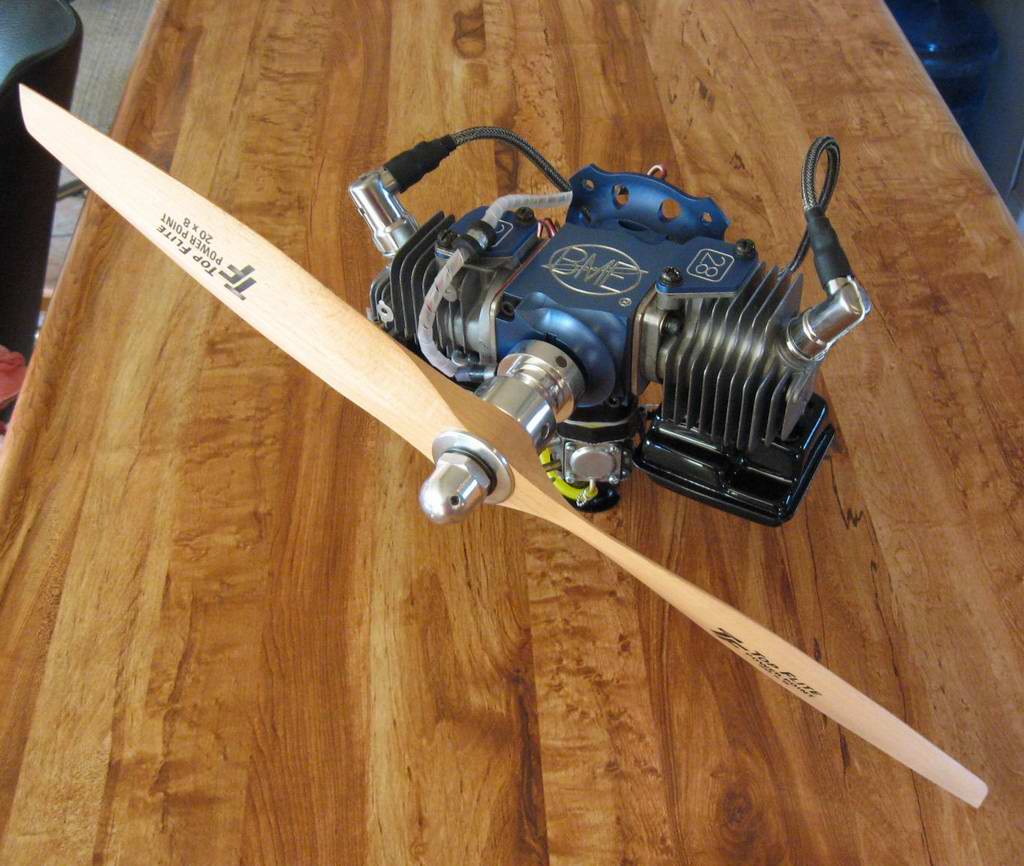

Here are some more pics. Might test run it today. The mufflers are temporary. When I figure out which airplane I am going to put it on, I will probably make up a Pitts style muffler for it like I did on my Echo powered Katana. It will probably go on my Wild Hare 29% Extra if it looks like it will fit the cowling without too much butchery.
If you look close you can see the cylinder spacers I made to accomodate the longer 25cc crank stroke.
AV8TOR

Just test ran that engine. It turned that 20 x 8 Top Flite at 7700 rpms after only 10 minutes running time. Not bad at all. I know it will get better too, because it has stock rings in it and they need to break in. I didn't use Frank Bowman rings in this one because it had brand new factory rings.
It will idle down to 1400 rpms, and warm restarts are one flip deals.
AV8TOR

Well, with some tinkering, tuning, and run time, that new twin is already pushing 8000 rpms with that 20 x 8 prop. I'll give it a little more run time, and then try some larger props. I'm happy with it. It should haul my Extra around just fine!
