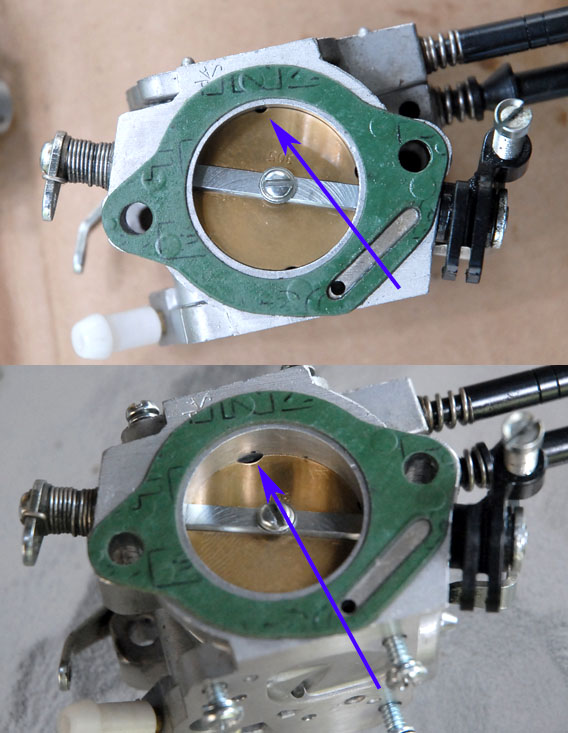

Below is a photo of a mod you can do. You should havea extra throttle plate in-case you cut too much. This has been show to work to get a leaner mid-range. I only recomend it for guys that have the time to read a little about this &amp; do not mind to think this out real good. It worked for me. Capt,n

What about trying different carbs? They can often be found cheap on E-bay. I don't think a 15 mm carb would cost you much, if any power, and would be worth a try. On this site/page, you can enter the carb number and it will give you a blow up diagram of the carb and the venturi size: http://wem.walbro.com/walbro/family.asp
I think the 22 x 10 carb should be a fairly good match for the engine, but you really won't know which prop is best until you fly it and see if it performs how you want it to.... Static thrust is only valid for 3D flying; particularly hovering. In all other flight modes, a prop will unload and give you more thrust than the static figures would indicate.
The modification Captain John showed is a good one that I have used many times, but be very careful not to get the notch in the butterfly too big or you won't be able to get the engine to idle low enough. The notch is directly in line with the holes in the venturi that feed fuel at idle and just above.
